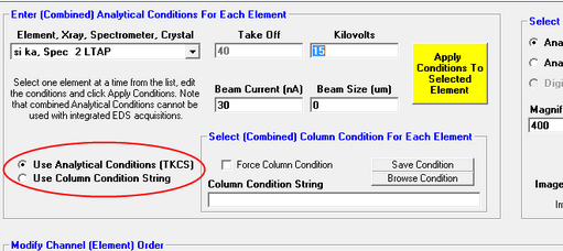

In setting up a sample analysis that has combined conditions, I noticed something weird.  I typed "new sample" (unknown) and then proceeded to set up a condition wherein oxygen was measured at 20nA and rare earth elements were measured on the same location at 100nA.  To do this, I used the "combined condition" window in Acquire!  The measurement would begin as I expected with oxygen at 20nA, but then when the column switched to 100nA, the filament saturation changed and the beam alignment changed.  Why does this happen and what am I doing wrong?
Karen
Hi Karen,
Make sure that in the Combined Conditions dialog you have the Use Analytical Conditions options selected. Otherwise the program will try and load the specified column condition file for each condition. Does that help?
Gseward
and whilst in the 'Combined Conditions' window, don't forget to 'modify channel (element) order' so that like-conditions are grouped together on a given spectrometer (and temporally across the spectrometers - using 'Count Times' window). I always seem to forget this step, then wonder why my acquisition order has been changed.
Note, that when using 'Combined Conditions'  the acquisition order cannot be changed in the usual  'Acquisition Options' window.
Gareth
Edit by John: actually yes, you can change the order on a per spectrometer basis in Acquisition Options dialog. What you can't do is force two elements with the same conditions to run at different times. So elements with similar conditions should be "grouped" together using the Combined Conditions "channel order" option. Otherwise the program will try and figure out the acquisition order on its own...

You can do as Phillipe suggests above (combine the samples post acquisition), *or* you can simply use the combined conditions feature and assign each element the appropriate voltage for acquisition in a single sample. Just remember to run your standards the same way...
John, I noticed something with the combined conditions: When I choose the combined conditions for different elements, and I set a value for nA and a column string, it would only save the column string. I need to open the element a second time, set the nA, and then it will remember. Is that right like this?
Philipp
Quote from: Philipp Poeml on July 03, 2014, 10:08:13 AM
Yes. Because if you are using column setups the current will be set from the column setup, not from the analytical conditions.
I suppose you are entering the beam current for documentation purposes?  That is a good idea. I modified the regular analytical conditions dialog to remember the analytical conditions for a given column setup and try to anticipate the user, but I didn't implement that yet under combined conditions.
Well... There is a little box in that window that says: "If you are using column string, don't forget to set the according value in the analytical conditions" or similar. I can send a screen shot tomorrow, probe is running right now. So I thought this was necessary to do.
Quote from: Philipp Poeml on July 03, 2014, 10:19:09 AM
Not necessary, but nice for documentation as I said. Note that for keV, this field entry is absolutely necessary when using column conditions (*.PCC files), since the beam energy value gets used in the quant routines.
