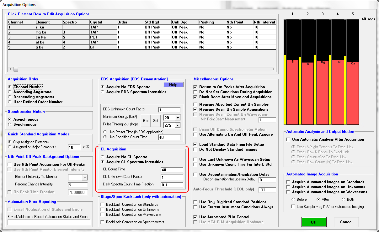

I have successfully interfaced an Ocean Optics spectrometer to Probe for EPMA.
It automatically acquires a dark spectrum (before the cup comes out), and then acquires a CL spectrum during the WDS/EDS acquisition as shown here:
The extra space at the top of the acquisition time display is because the WDS data is for 30 seconds, but the CL acquisition is specified at 40 secs. See here for more details:
http://smf.probesoftware.com/index.php?topic=42.msg3855#msg3855
The acquired CL spectra can be displayed and/or exported in EMSA format with both the dark spectrum and normal CL intensity data for further processing and reporting.
