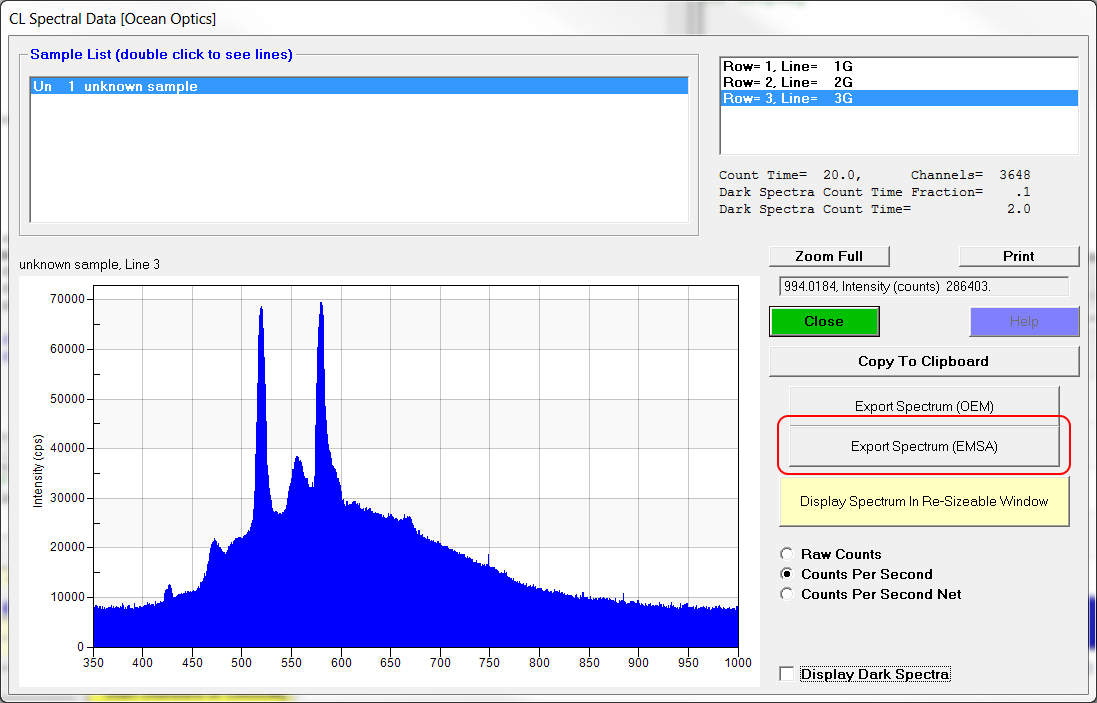

My problem now, how do I export the CL spectrum out from the db?

From the Run menu use the CL display menu and use the EMSA format export-  I don't have an OEM export method implemented at the moment.

Got it. Now I need to figure out how to read emsa format.
Am I correct to say that the first column (after keyword #spectrum) is the wavelength, and the second one is the intensity?
If yes, the number seems to be too large. Should they multiply by some factor?
