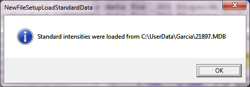

When I'm loading my standard intensity data and file setup to a new blank file, I get this: (see attachment)

Have you updated to the most recent version of PFE? If you have, and are still getting the error, please send me the old MDB file that you are attempting to make a new file from.
Also just FYI: to capture just the active (error mesaage) window use the <alt> <PrtScn> key combination.

I can't tell until you send me the MDB file.  It's already loaded the run globals and selected sample setup, and trying to load the standard intensities, but failing on trying to load the TDI curves for the standards.  Maybe there aren't any?  It should check for that, but I will look also.
OK, I checked and it is successfully loading std TDI data from an old run, so if it still doesn't work for you after you update PFE, I'll need the old MDB file you are trying to load from and getting errors.
Edit by John: Ben, I created a new MDB, made a new sample, clicked the Load File Setup button and loaded all your standard intensities from the old MDB that you sent me and it worked fine:
