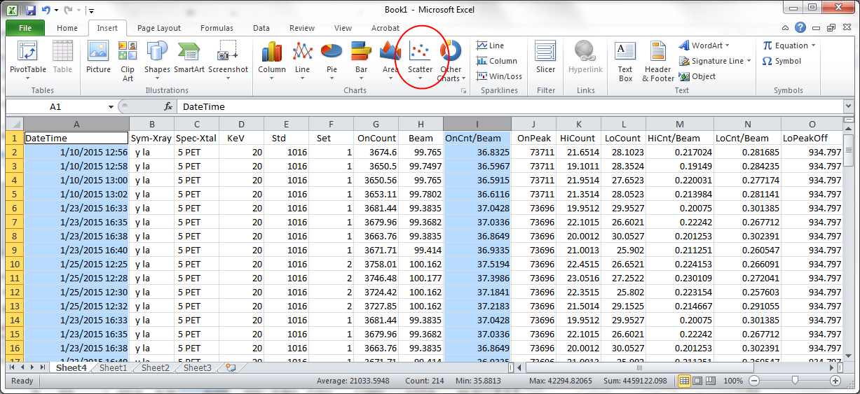

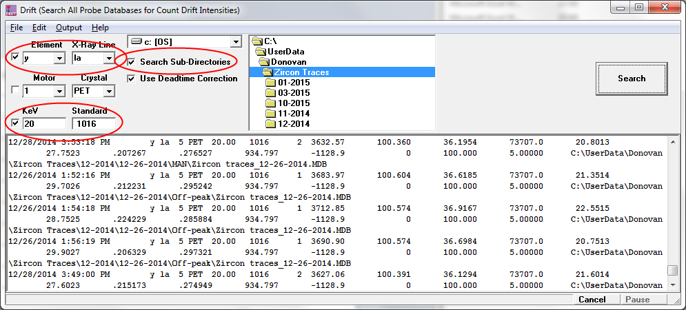

Here is data from the Drift.exe application that demonstrates that the crystal alignment performed by Edgar Chavez (Cameca) generally improved the SX100 spectrometer intensities (see attached images below).  Basically spectrometers 1 and 2 showed the most improvement. Which is interesting because spectrometer 3 was the one that was most out of alignment based on the size of the offset from the theoretical peak positions.
The Drift application is a useful app for monitoring your spectrometer intensities over time.  See the Drift menu in the Start button, Probe Software | Utilities menu. Basically one simply selects a folder tree to search for just an element and x-ray, but one can also constrain it to specific spectrometers and/or standards which is what I did below. Here is a screen shot of the search for Y La intensities on my YPO4 std (1016):
And when it asks "Do you want to export the data to Excel?" click Yes and here is what you do to plot it in Excel:

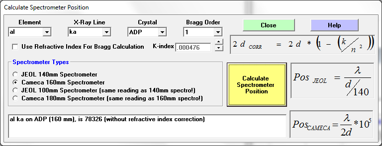

In case anyone is wondering, ADP is a Bragg crystal composition no longer seen very often:
Ammonium Dihydrogen Phosphate, known as ADP crystal (NH4H2PO4)
https://www.unitedcrystals.com/KDPProp.html
It was sometimes utilized to get a high spectral resolution for Al Ka (or Br La):
