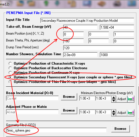

Note on using the *sphere geometry files:
Note that when using the hemisphere geometry files, make sure that the X beam position shown here is properly set. The default for the straight line boundary geometry (couple.geo), is 10 um (1E-3 cm) to the right into the beam incident material.
If it is desired to place the beam in the exact center of the inclusion, set the X distance to zero as shown here:

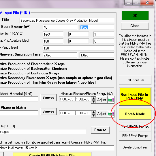

The easiest way to do this is to utilize the "batch" mode of the Penepma GUI, by first generating the two input files from the Create PENEPMA Material and Input Files window which is accessed in the Standard.exe program from the Analytical | PENEPMA (Monte Carlo) Calculations menu.
Once all Penepma input files have been generated, simply click the Batch Mode button as seen here:

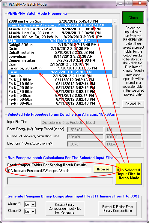

and then select the input files you want to run from the input file list. The basic calculation parameters are displayed as each input file is selected (use <ctrl> click for multiple selections), and when all input files have been selected, Browse to (and create if necessary) a folder to store your calculation results in as shown here:
Then simply click the Run Select Input Files In Batch Mode button.  The program will confirm the required calculation time and folder to save to (each calculation and output files will be automatically saved to a separate sub folder), and then simply click OK to start the calculation.

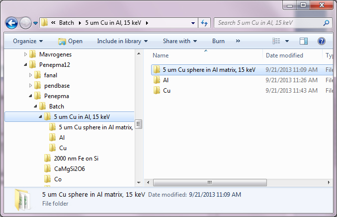

Extracting the intensities for k-ratio calculations:

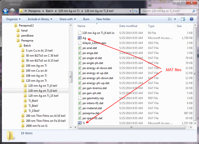

Once all the Monte-Carlo calculations are complete, one browses to the batch output folders shown here:
Now locate the pe-intens-01.dat file in each folder and copy or note the transition intensity for each line that you desire to calculate k-ratio values for. The most common transitions are listed here:

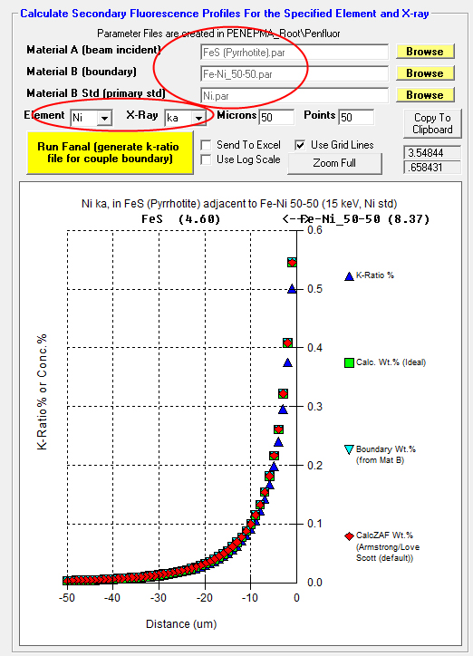

I assume you're trying to figure out if the FeS inclusions have a trace amount of Ni in them?
If so, you only have to worry about continuum fluorescence because the Fe and S characteristic x-rays will not fluorescence any Ni atoms in the matrix material.
But let's see what effect it will have by running Standard.exe and using the Penfluor/Fanal calculation to start as described in painful detail here:
http://smf.probesoftware.com/index.php?topic=58.0

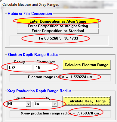

So, let's run at 15 keV (as opposed to 20 keV) to minimize the interaction volume which we normally might want to for trace Ni!  We can note first however that by using this calculation:
http://smf.probesoftware.com/index.php?topic=86.0
at 15 keV the Ni interaction volume in FeS is just under 1 um so we are close but OK:
So, assigning FeS as our beam incident material and FeNi (50:50 by weight) as our boundary material (because I haven't calculated a Pentlandite yet!) we obtain the following Penfluor/Fanal result:
This is a worst case because there's more Ni in Fe-Ni than in Pentlandite, but it tells you you could very well have a problem analyzing trace Ni in FeS adjacent to Pentlandite.
If you want to calculate the effect for Pentlandite as a boundary material (and you will have to calculate Pentlandite if you want to make the boundary correction in CalcZAF or even if you do it by hand!), it will take about 10 hours to calculate the PAR file and the process is described here:

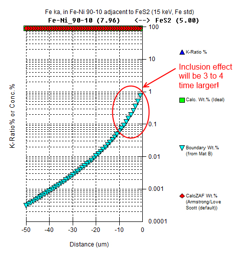

1. The Penfluor/Fanal secondary boundary fluorescence modeling in Standard.exe will only work for vertical boundaries.
2. However, ignoring "tertiary effects", one can assume that a lamellae with a width twice that of the vertical boundary calculation distance will have an artifact intensity roughly twice as large. However, that assumption is based on the point equidistant from the two boundaries.
3. For an inclusion the geometric effect is even larger, obviously somewhere between 2 and 4 times the effect from a single vertical boundary. I'm working with a mathematician to try and "transform" these intensity profiles into different geometries such as a hemisphere.

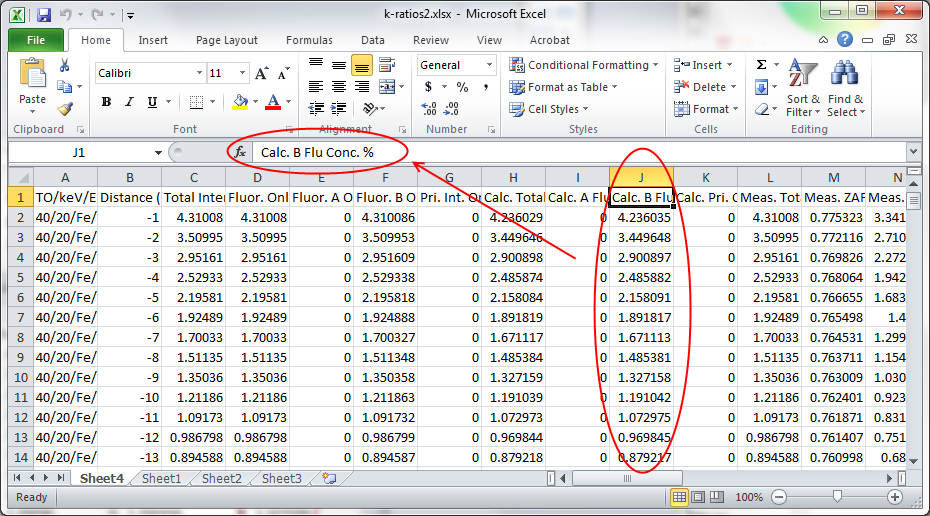

Ok, I finally have my data from the microprobe and the k-ratios from the PENEPMA simulations. How do I actually go about correcting my probe data with these SF k-ratios since CalcZAF isn't an option for the sphere geometry? I haven't been able to find anything describing that process so if you could point me in the general direction, that would be fantastic. Thanks!
Quote from: Sheri Singerling on June 04, 2014, 02:21:06 PM
The advantage of doing it in CalcZAF, is that *if* there is a large change in the concentrations due to the SF correction, this could affect the matrix correction, especially for low energy x-ray lines. In CalcZAF, the SF correction is iterated and therefore automatically handles this change in composition.
But usually the SF correction is small enough that this can be ignored, and in that case a simple subtraction of the boundary contribution in wt.% (material B), from the measured concentration will be sufficient.  In the kratio2.dat file, it is this column:
One way to check this is to run CalcZAF with the uncorrected concentrations and again with the corrected concentrations and see how different the matrix correction term (ZAFCOR) is between the two for each emitting element.  If it is less than a percent or so, I wouldn't worry, though you could apply it.
For reference please use the paper attached below.
Wait!  I just realized that you used Penepma, not Fanal for this modeling so the Fanal output screen shot doesn't help you!
The problem is that Penepma doesn't separate the beam incident contribution from the SF boundary contribution. So if you have some of the element present in the beam incident material, you'll have the intensity of that added in with the SF intensity.
What you'll need to do is calculate your material with a boundary (as you've already done), then calculate the same material *without* a boundary and subtract the appropriate line intensities from each other.
Does that make sense?  Then you can apply that k-ratio intensity difference to your measurements by converting them to concentrations (just multiply the k-ratio by the matrix correction for this material).

I ran your compositions as a simple boundary in Fanal just as a "sanity check", and as you can see:
and depending on the size of the inclusion there will be a significant enhancement of the inclusion from secondary (continuum) fluorescence. Why is it continuum fluorescence only? Because Fe and S characteristic x-rays cannot fluoresce the Fe K edge.
Note that the opposite can occur when the matrix is low Z such as epoxy as John Fournelle has described in the links here:
