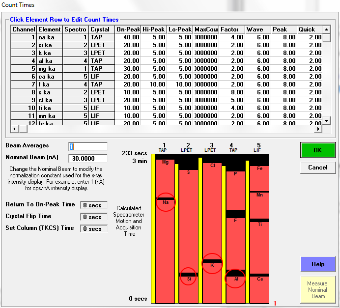

We routinely run Si, Al, Na and K as the first elements using only two TAP crystals as seen here:

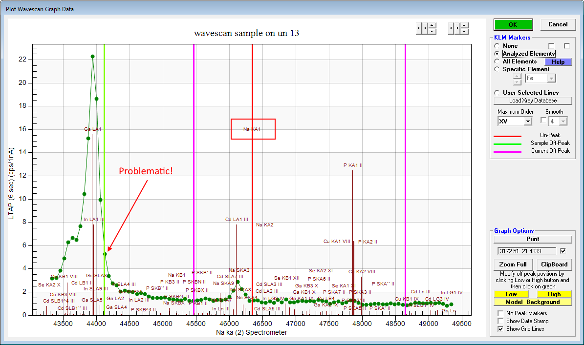

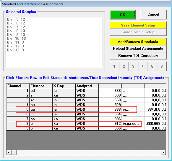

Next is Na Ka which shows the default low side off-peak severely interfered by Ga *and* In:
This problematic off-peak interference will produce significantly negative k-ratios (not to mention that we will need to perform an interference correction for In (III) on Ga La).  By the way, here are the interferences that we had to correct for in this matrix:

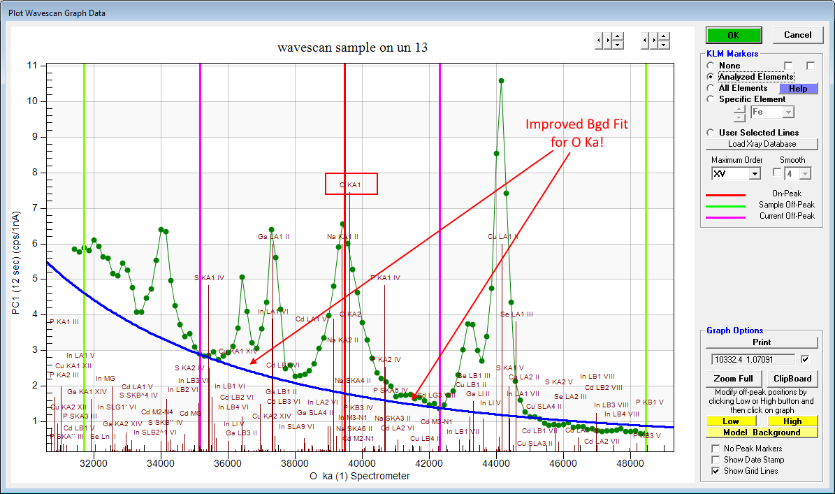

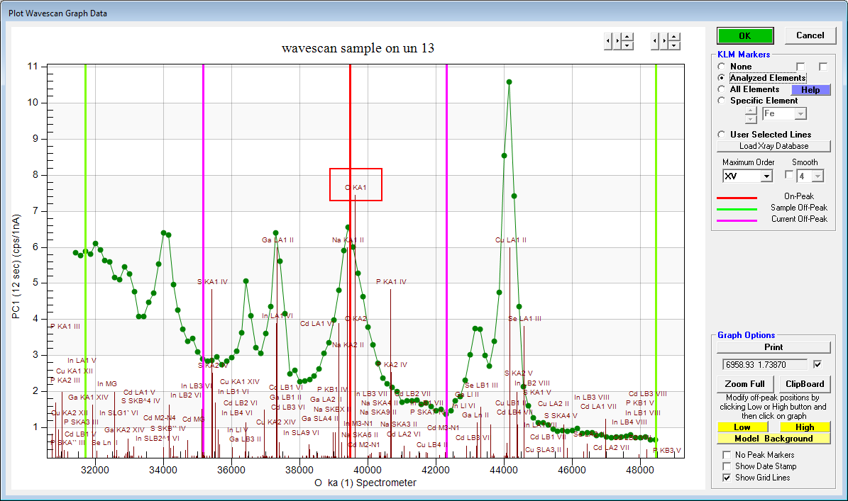

Next we examine O ka, which has a very complicated spectrum:
It's difficult to select background positions which are not interfered with, but by choosing off-peak positions relatively close to the emission line we can obtain a relatively decent, though not perfect fit as seen here:
Bottom line: don't forget to check your off-peak positions (as I recently did!), for accurate quantification!

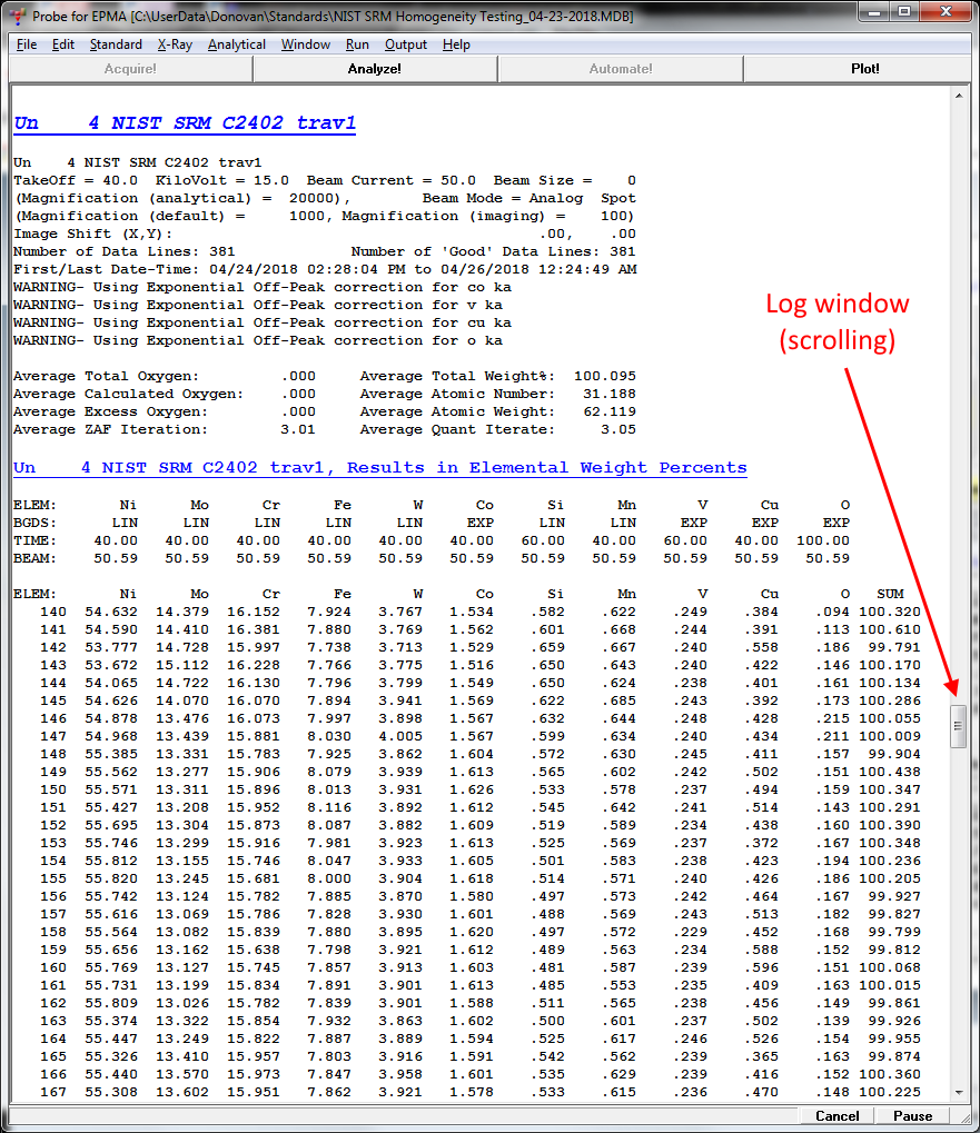

I've been asked to describe how the analysis results in Probe for EPMA are displayed so I thought I would document that here for the benefit of others.

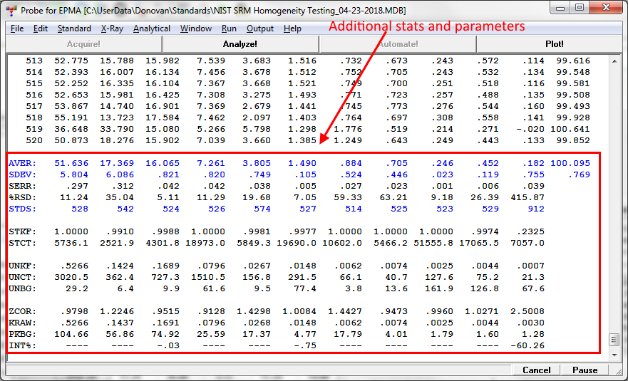

Because Probe for EPMA GUI is so "sample centric", the analysis results are very prominently visible in the application.  There is of course the main log window where all acquisition data and results are displayed, but also the Analyze! window where the results are summarized for each sample. A sample being a group of elements (element setup) with specified conditions and zero to n data points. That is every sample has n data points with an average, standard deviation, etc., etc.
Here are the quantitative results from a sample displayed is the log window (which can be elemental, oxide, atomic, formula basis, etc., etc.):
If one scrolls further down in the log window, one can see the summary statistics and parameters for each element:

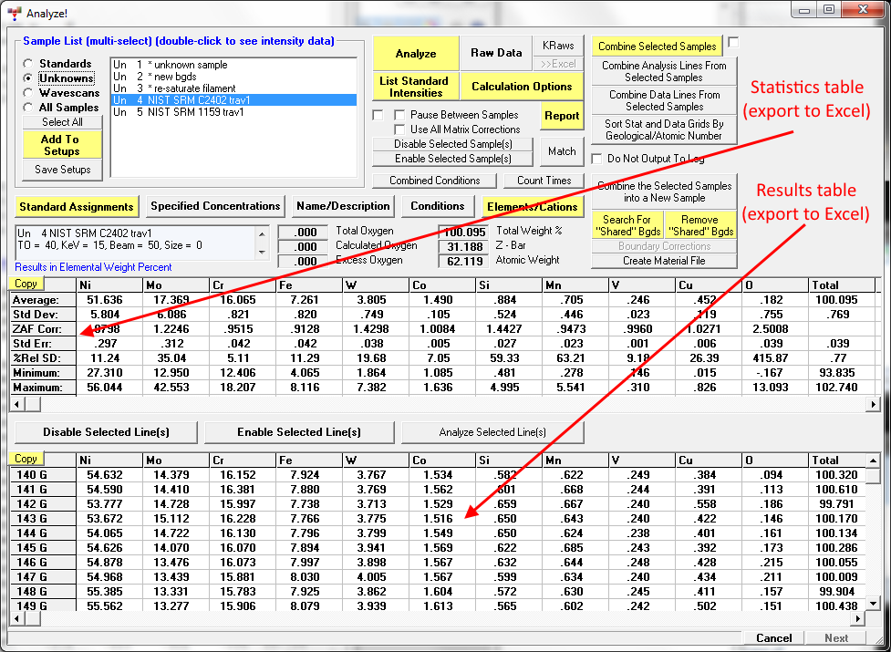

The same results are also visible in the Analyze! window as seen here:

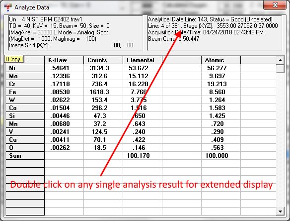

One can also "drill down" into each point analysis for extended display of other data types (which are also displayed in the log window and Analyze! window) by double-clicking on a single point as seen here:

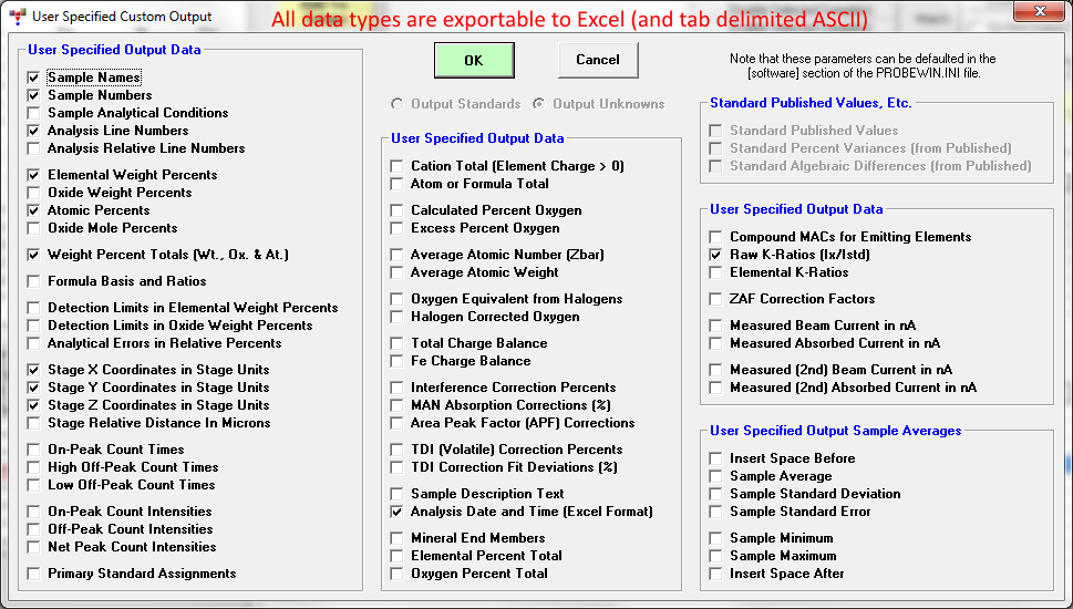

One can also export these and many other data types to tab delimited ASCII files and directly into Excel as seen here:
This is just a tiny part of the analysis results that are available in Probe for EPMA. Please let me know if there is any thing else you are curious about.
