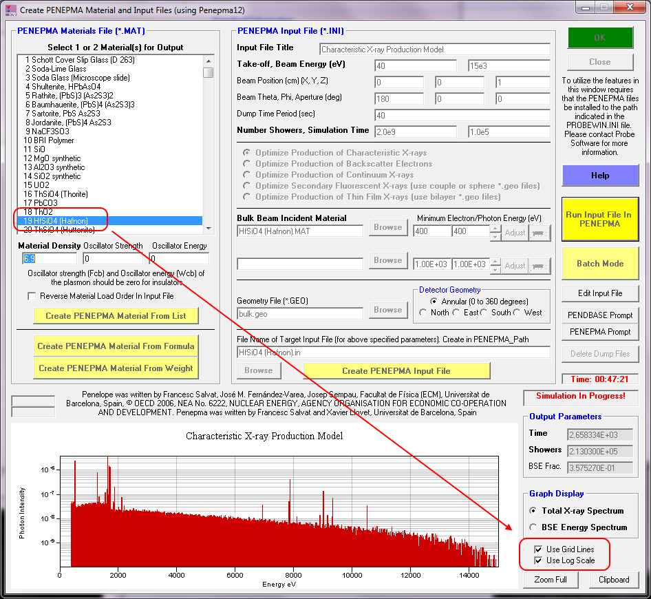

Here is the new Penepma12 GUI in Standard, showing a log plot of HfSiO4 at 15 keV (modeled down to 400 eV):

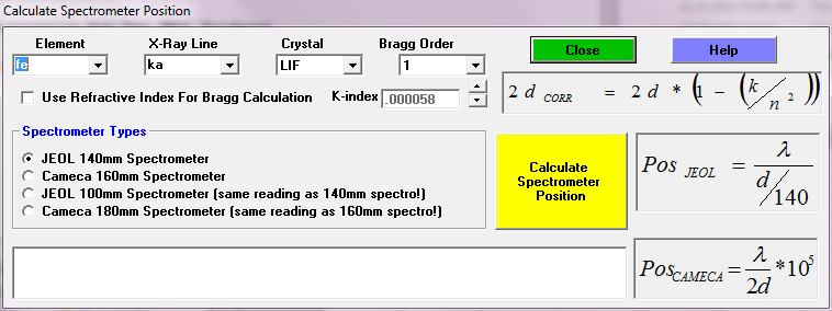

I added the spectrometer position equations as graphics to the latest version of CalcZAF:

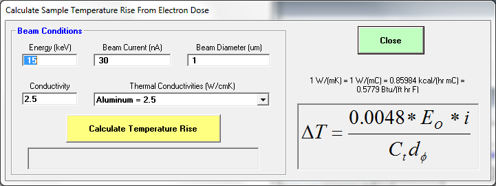

Here is the calculate temperature rise dialog in CalcZAF (see Run menu). It is based on electron dose and thermal conductivity.
