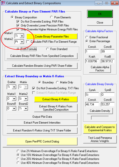

One other thing I can suggest is to perform the analysis using the new Fast Monte-Carlo method as described here:
http://smf.probesoftware.com/index.php?topic=47.msg578#msg578
Because there is a very large atomic number correction in this matrix, Penepma should be able to provide a more accurate matrix correction...  please post these results here, as I would be very interested.
Unfortunately the Ti-Pt binary is not (yet!) one that I have calculated...   :'(  I've done about 2/3 of the periodic table but there are still some "holes".  However, I will start that calculation today and it should be done by Monday (110 hours)...

Edit by John:  OK I have the Ti-Pt binaries running in Penepma (Penfluor).  It's says 112 hours to go...  I will have to upload the finished calculations on Monday, then re-compile the matrix database and upload everything Monday evening so it should be available for you on Tuesday morning.

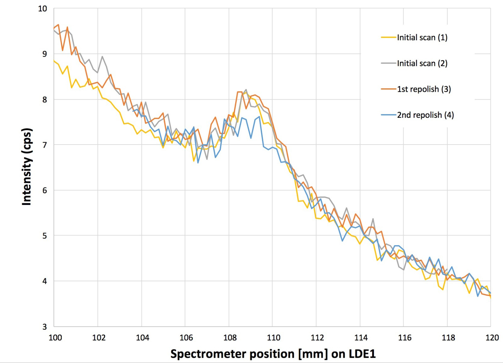

I also did in fact measure oxygen in Pt (not in Ti, though). It is variable in the two Pt standards I have (on in the MAC standard block, another one in my Bence-Albee block - both are "old" and some do not appear very healthy, despite numerous repolishing since I arrived in the lab in 2012). Actually, my initial thoughts were to see the Pt Mz 3rd order line that is around Pt. To my surprise there is a clear O Ka peak that I also observed on a WDS scan (well, probably a composite line of Pt Mz III [expect to be very small... 3rd order and theoretical ~1% the intensity of Pt Ma III] and O Ka)! Close to 0.5 cps/nA even after repolishing twice the standards these past three days (well, without grinding it down, just intensive polishing for >10 min each with 0.2 µm colloidal Al2O3), and recoat it with minimal air exposure, but no luck, still there... (one of the Pt standard improved and "only" yielded 0.3 cps/nA). I start to wonder if indeed a plasma cleaning prior to polishing and prior to loading in the vacuum would be better. Or could this be a contamination during the coating??? I am using the carbon coater from SPI with a classical old rotary pump (=> oil?) and the vacuum reach at the best the low 10-2 mbar.
Here is the plot of O Ka in a Pt standards (initial scan is within each of my 2 standards, other scans are after repolishing once or twice one of these standards). In each cases I used 250 or 200 nA, at 15 keV with defocused beam (20 um) and 3 sec counting time by step of 0.2 mm. O Ka peak is at 109.2 mm. The Pt Mz III should be 1.2 mm on the LEFT of the O Ka (so around 108 mm).
Sorry wrong label on graph... You should read "counts per nA" and not "cps" on the Y-axis; divide the value by 3 to get counts per second per nA...

Without looking into it more closely (KLM markers?), it's hard to say, but it appears that you have real oxygen in (or on) your Pt samples. I assume the same oxidation (or adsorbed oxygen/H2O on the surface?), but even more so for pure Ti...  and to make things even worse, there are some Ti L beta emission lines very close to the O Ka line:
For  O ka  WSi60 at  23.9756 angstroms, at an assumed concentration of 0.5 wt.%
  Interference by Ti LB3            at  23.8890 ( 109.655) ( -.39732) =   1560.8%
  Interference by Ti LB4            at  23.8890 ( 109.655) ( -.39732) =    818.1%

As difficult as it would be I think we need to find a way to utilize the PFE interference correction but with Ti and Pt standards that are essentially oxygen free (I think I have the Ti standard you need already with 80 PPM of oxygen), but even more important (because we can characterize any bulk oxygen using another method), we need a way to prevent or even better remove the oxidation layer during the acquisition (in situ cleaning).
Have you quantified the apparent oxygen peak that you show in your Pt wavescan above?  If so, what concentration do you obtain?  Assuming of course that it is oxygen in a bulk matrix...  though it really doesn't matter that much because oxygen x-rays are only emitted from the first 100 nm or so in Pt (8% transmission from 100 nm, 28% from 50 nm).

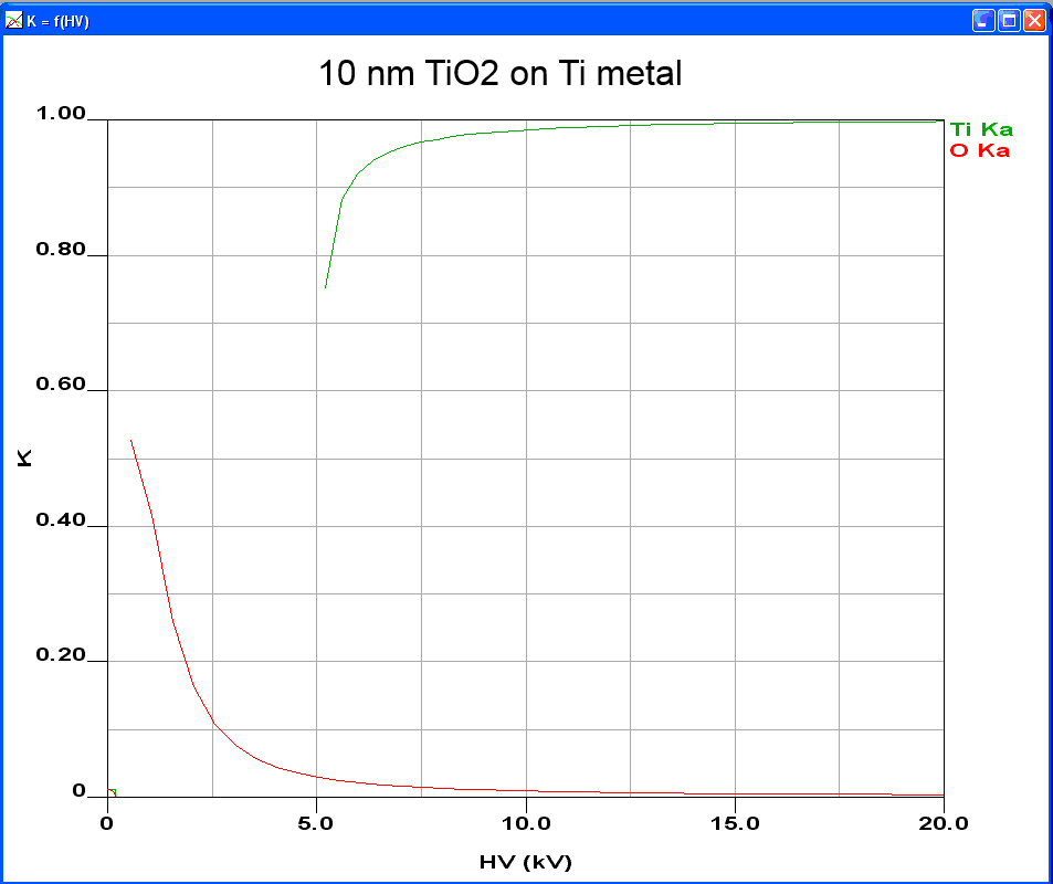

I ran a monte carlo simulation of pure Oxygen and a second model of Pure Ti with a 5nm TiO2 surface layer.
Using the predicted intensity of O ka from pure Oxygen and O ka from the layered model I  calculate a  k-ratio for 0 ka. of 0.005.   I used this K-ratio as input to Calczaf. Since the matrix model assumes an homogeneous activation volume, the raw intensity from surface O will be over corrected, as we know. Here is the output:
SAMPLE: 0, TOA: 40, ITERATIONS: 3, Z-BAR: 21.64629
   O  ka  6.1812  1.0000   .8178  5.0550   .7408  1.1040   .1360   .5317 18.8076 22449.0
   O  ka  .00513  .00513   2.592   -----   7.201    .621   10.00
   Ti                     99.990   -----  92.799   8.000
   TOTAL:                102.582   ----- 100.000   8.621
So the intensity from the 5nm layer now looks like 2.6wt% by falsely assuming the O is distributed in the bulk.
Note that the O ka raw intensity has over 600% absorption correction - which gives you a good idea why the wt% can get so high and why a lower kV for O might help!
So what to do? As a first approx. if I make the assumption that the oxide layer is ~ the same on the Pure Ti standard and the Ti metal in the Alumina bond sample (which might be fair, if one polished and coated the samples together), I could use the pure metal as a blank correction.  This would also take into account Ti Lb spectral interference on the O ka line. This would be a reasonable approximation for near pure Ti unknowns perhaps, but I'd like to experiment with an oxygenless Ti material as an interference standard also for comparison. For this I envisage TiB2 TiN or TiC.
Using real probe data:  pure Ti as a standard (99.99)  with no corrections applied for the combination of interference and over-corrected absorption, I measure 5wt% O!!!

I would only comment that (normally) if one wants to *minimize* surface effects (contamination, oxidation, etc.), for a bulk analysis, one should generally use a *higher* keV, as the ratio of x-rays from the surface relative to the x-rays from the bulk will be lower.
Unfortunately, as Gareth points out, because low energy emission lines tend to come *only* from the surface (due to large absorption corrections), you don't have a whole lot of leeway in adjusting the keV.  Here is a plot of K vs. KeV from STRATAGem* for O ka and Ti Ka for 10 nm TiO2 on pure Ti.
Lower keVs do help with sensitivity for low energy emission lines such as oxygen because the overvoltage is getting closer to the "optimum" value of 2-3 times the shell excitation energy, as the beam energy is lowered from typical beam energies.
This morning there is still 30 hours to go, so the Monte-Carlo probably won't be finished and incorporated into the matrix.mdb until Wed or Thursday- sorry.
