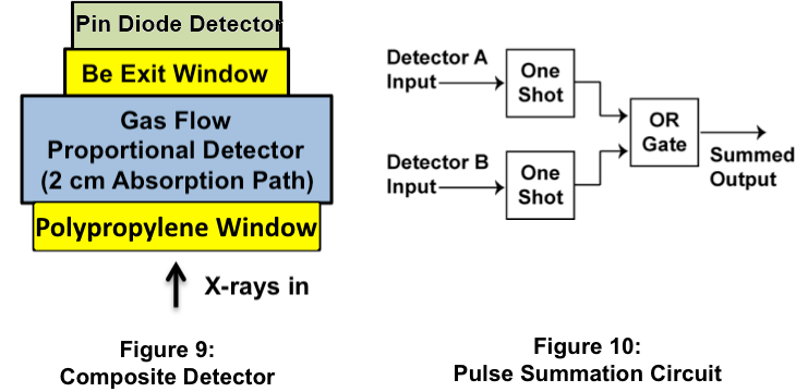

Here's a schematic drawing of a tandem detector system (from one of our NSF instrument development proposals from a couple of years ago), that I think would be very useful to improve the energy range and sensitivity for WDS spectrometers in EPMA:
Please note that there is nothing new with the idea. We've seen this idea implemented in the distant past with Peak spectrometers for example.  Using new solid state technology this tandem method should be even more efficient than previous efforts.
Here's a mention of this tandem detector idea from a Bruker guide to XRF:
QuoteThe  flow  counter  is  situated  inside  the  spectrometer  chamber  and  has  an  angle  range  of  2°  to  148°. Located  behind  the  flow  counter  and  outside  the  chamber,  separated  by  a  0.1  mm  Al  foil,  is  the scintillation  counter  with  an  angle  range  of  2°  to 110°.  Both  detectors  can  be  used  individually  or  in tandem.  In  tandem  operation,  the  intensity  in  the  flow  counter  is  measured  as  well  as  the  radiation  that passes through the flow counter and the radiation that is absorbed by the scintillation counter.
http://www.fem.unicamp.br/~liqcqits/facilities/xrf/%5BBruker_2006%5D%20Introduction%20to%20X-ray%20Fluorescence%20(XRF).pdf
Of course we probably shouldn't use a scintillation counter as described in the XRF guide above, because today's pin diode detectors are highly efficient and low cost. In addition, unlike SDDs, pin diode detectors don't need to be cooled.
Also the 127 um thick Be exit window provides a nice low energy filter for the pin diode. That is, only x-rays greater than 6 keV or so will get detected, while the gas flow portion of this tandem design will very efficiently detect low energy x-rays down to Be or possibly lower.
If this tandem design was implemented, every WDS spectrometer on your EPMA instrument could capture the complete x-ray energy range!
