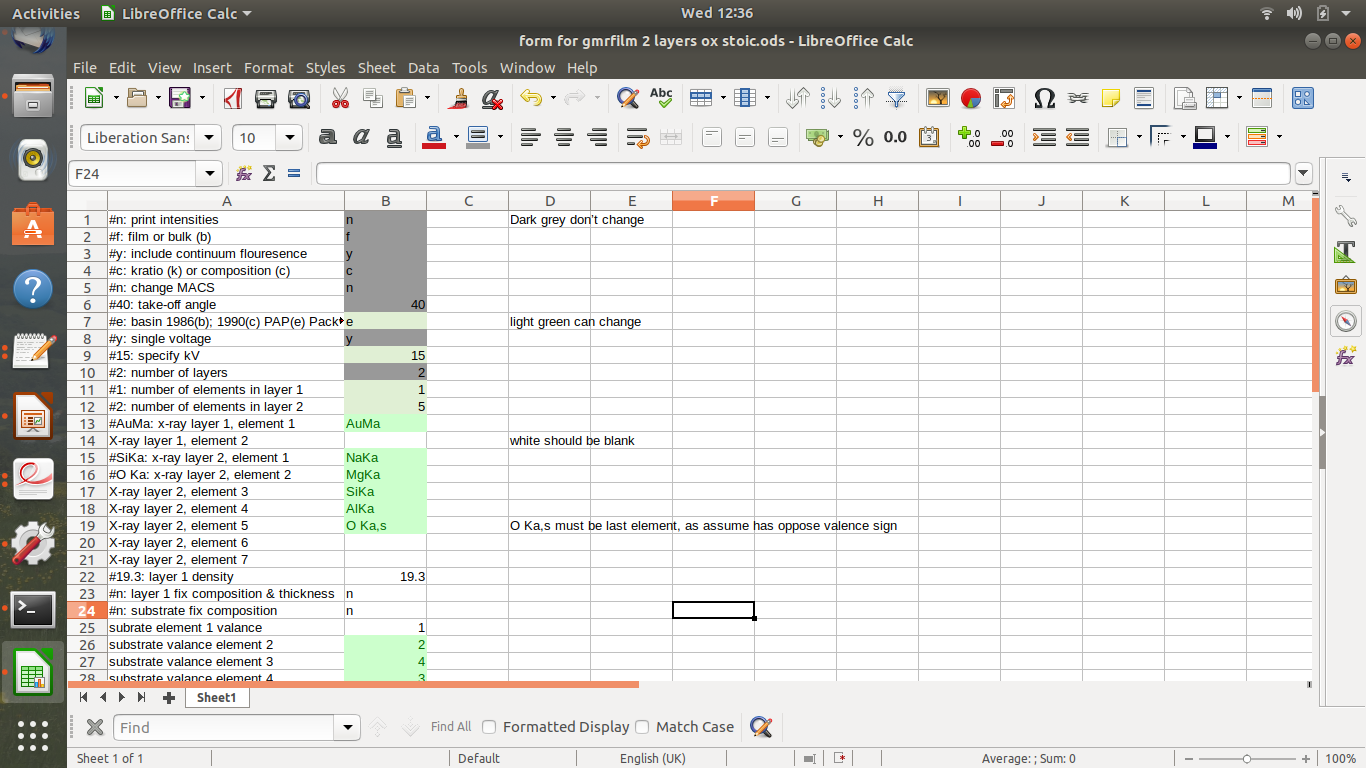

Here is an example using an spreadsheet form input
'form for gmrfilm 2 layers ox stoic subs7 batch.ods'
Saved to csv
A python script to convert the csv into input files and input script to gmrfilm
'gmrf_csv_to_input2.py'
A script to run gmrfilm
'gmrfilm_run_batch.py'
And a python script to read the results into a single file
'python read gmrfilm3 comp subs7_batch.py'

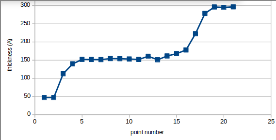

I ran some analysis on a glass thin section, with two bands of Au sputtered, nominally 10nm and 20nm
The graph shows the results, a thickness traverse across the thin section

I've now tidied up the scripts. So on ubuntu for a single element coat, and a substrate with between 2-7 elements.
Its:
(1) Fill in spreadsheet, save as csv.
(2) terminal cd to working directory (in which have csv, run scripts, and gmrfilm program)
(3) sh RunAll.sh
Latest scripts attached
