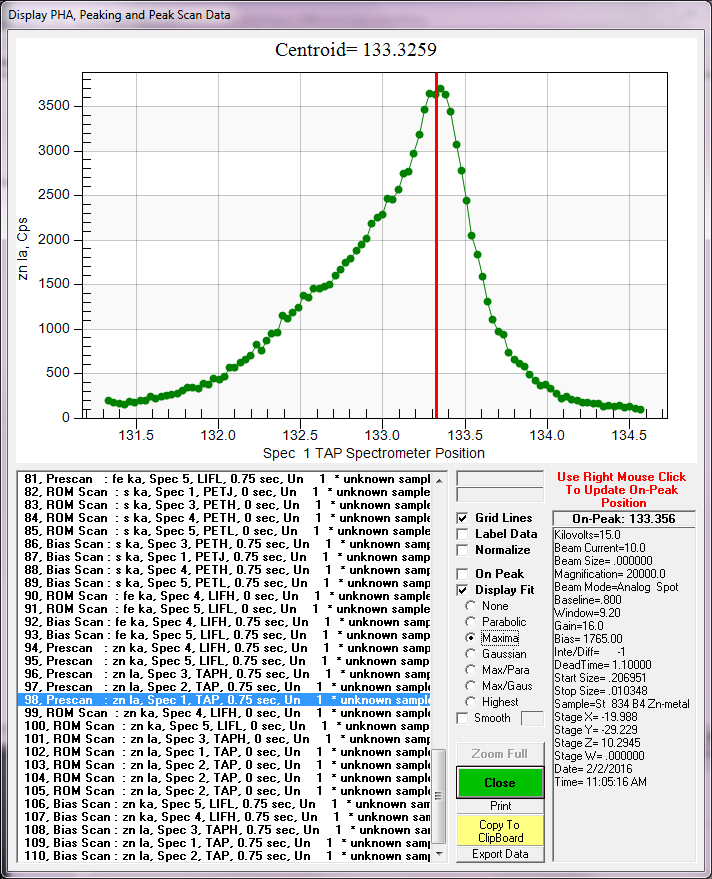

I suspect the bug was from my recent "mulching over" of the code to implement the new graphics library. Nice scans looking scans by the way!
