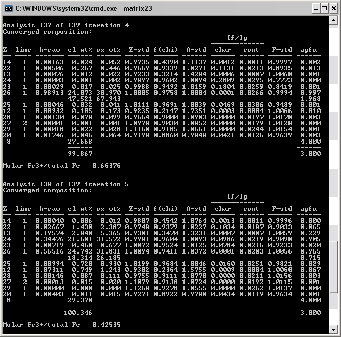

Here is an example of an analysis (PAP model, accelerating potential = 15 kV, takeoff angle = 40 deg.) of pure magnetite using a pure magnetite standard.  I've assumed that all Fe in the unknown is present as FeO.  Under "Calculation Options," I've selected "Calculate with Stoichiometric Oxygen."
If I then recalculate the result assuming 3 cations and 4 oxygens per formula unit, I obtain 67.996 wt% Fe2O3, 30.591 wt% FeO, and oxide total = 98.586 wt%.  (I've used molar mass Fe = 55.845 g/mol and molar mass O = 15.9994 g/mol.)
The standard and unknown both contain 72.359 wt% Fe and 27.641 wt% O, and Fe k-raw is precisely one.  If it is assumed that Fe is present in the unknown as FeO, then the calculated weight per-cent of oxygen is 20.731, producing an oxide total of 93.090 wt%.  However, during the matrix correction iterations, compositions are normalized, and, during the first iteration, the Fe and O contents of the unknown become, respectively, 77.730 and 22.270 wt%.  If matrix corrections are determined based on this composition, then, relative to the standard, the Fe atomic number correction (PAP model) is 0.9851 (=1.0659/1.0820) when in truth it should be precisely one.  This mostly accounts for the anomalously low wt% Fe in the result since the absorption correction is close to unity.
Why does CalcZAF not include a provision to account for mixed oxidation state of a chosen element during the matrix correction iterations?  Or is this somehow possible in CalcZAF, and I just don't see it?

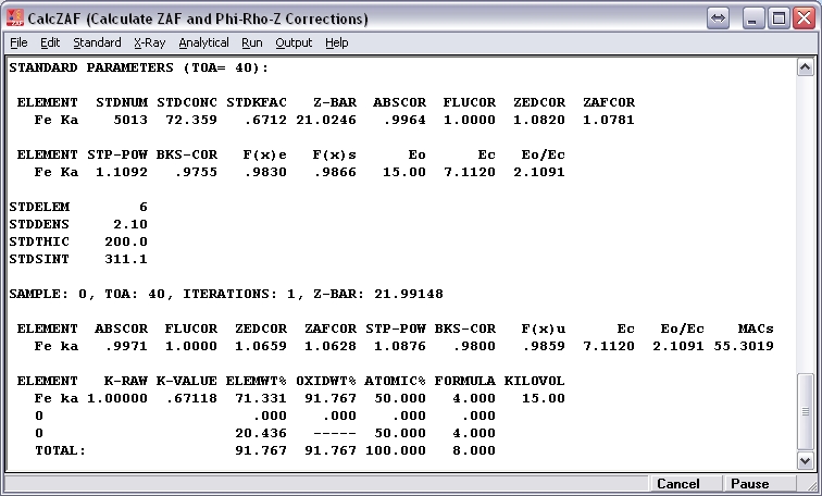

The ZAF window should look like this:
One can also simply enter Fe3O4 using the "Enter Composition As Formula String" button and you will get this after clicking the calculate button:

Or just enter pure Fe with a concentration of 72.359 wt%, and 3 cations and 4 oxygens and and then click the Calculate with Stoichiometric Oxygen checkbox and you will get this:
   Fe ka   .9969  1.0000  1.0660  1.0626  1.0935   .9748   .9877  7.1120  2.1091 55.6318
   Fe ka  .00000  .68095  72.359 100.000  42.857   1.000   15.00
   O                        .000    .000    .000    .000
   O                      27.641   -----  57.143   1.333
   TOTAL:                100.000 100.000 100.000   2.333

I overlooked some of the options in CalcZAF.  What I was looking for was a way to specify the total number of cations (3) along with the total anion charge (-8) during the matrix correction iterations (which is how I've approached it).  Note that specifying molar Fe:O ratio = 3:4 in magnetite does not necessarily work because other cations can substitute for either Fe2+ or Fe3+ so that the molar ratio of FeO to Fe2O3 is not always 1:1.  Let me dig up an example.

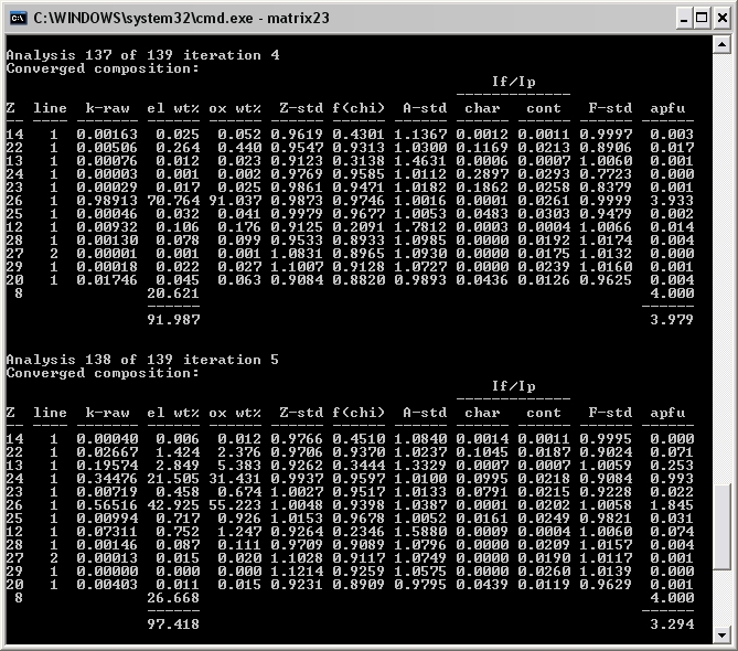

Below are a couple of magnetite analyses that I've processed (PAP/MAC30) by placing constraints on the total number of cations (3) and total anion charge (-8) per formula unit within the matrix correction iterations; I've incorporated these constraints within the subroutine that I use to normalize composition during the iterations.  Of course the JEOL software contains no provision for calculating Fe3+/Fe2+ while processing data, and so otherwise I get stuck recalculating after the fact and getting inaccurate results.  Usually I check my work against CalcZAF, but, like I noted, I couldn't find a way to apply the constraints in the same manner.  In this case the Fe standard is pure Fe3O4 synthesized by Peter Roeder.  The output is a little rough; for Z=26, wt% FeO is listed first and Fe2O3 second.  In analysis 137, which is close to end-member magnetite, note that Fe Ka Z-std is very close to unity.
Quote from: Brian Joy on March 06, 2016, 08:01:03 PM

Specifically what I'm doing is normalizing first to a given number of cations specified by the user in a settings file.  I then calculate the total charge on the cations assuming, for instance, that all Fe is divalent.  For this case, the number of Fe3+ per formula unit is equal to the anion charge (corresponding to the number of oxygen ions specified by the user in the settings file) minus the total charge on the normalized cations assuming all Fe is divalent.  I then calculate the mass of oxygen required to balance the charge on the cations (whatever they may be) during the iteration while using an "average" Fe charge determined by the above procedure.  It's essentially the same procedure used in after-the-fact recalculations, but I've simply built it into the matrix correction iterations.  I was afraid that it might hinder convergence, but I haven't run into problems with this.
The scheme that I've implemented is the simplest possible one, and one could envision much more elaborate schemes in which cations are assigned to specific sites during the normalization, as is necessary in the amphiboles, for instance.

Below are the same two magnetite analyses as before with all Fe assumed to be present as FeO during the matrix corrections.  If I recalculate for Fe2O3 after the fact, then for the first analysis I get 30.62 wt% FeO, 67.14 wt% Fe2O3, and total = 98.71 wt%.  For the second analysis, I get 31.68 wt% FeO, 26.16 wt% Fe2O3, and total = 100.04 wt%; wt% Cr2O3 is 31.43 instead of 31.57.
Quote from: Brian Joy on March 07, 2016, 03:04:02 PM
Yes, I agree that the effect is small unless Fe2O3 is present in large quantity.  This is why I chose magnetite as an example.  As far as silicates, possible problematic cases would be minerals such as aegirine-augite and riebeckite, especially if the latter is fluorine-rich.

You're showing a magnetite and a chromite in the image of the FORTRAN output.  Did you post the wrong image?
If I run a magnetite both ways I get this for magnetite with excess oxygen of 6.881 wt%:
