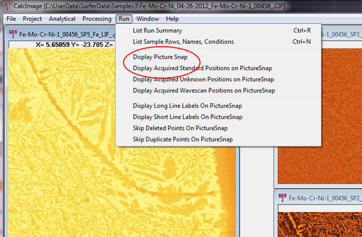

What I have thought of (and it may not be original, but it is cool) is to make a new window in CalcImage where one could import any analog signal image (or heck even a raw x-ray map) and then simply specify a PFE quant sample and a data type to correlate to the image raw data.
The program would then find the X and Y coordinates of each point analysis in the specified sample and use that data to calibrate the BSE intensity for each pixel. Automatically!  Dare I say with "just two mouse clicks"!   ;)
