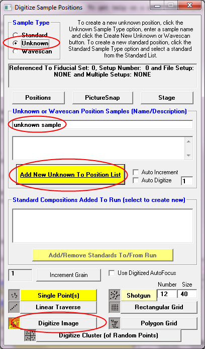

First, make a new position sample from the Digitize! window and click the Digitize Image button:
Then set the scan speed and acquire an analog signal (SE, BSE, etc) image of the area of interest and save it to the database (images are the only data that are not automatically saved to the PFE database!).  Now using the mouse just click on the pixels you want to acquire data from. The software will automatically record the stage positions to the position database (see the Automate! window).

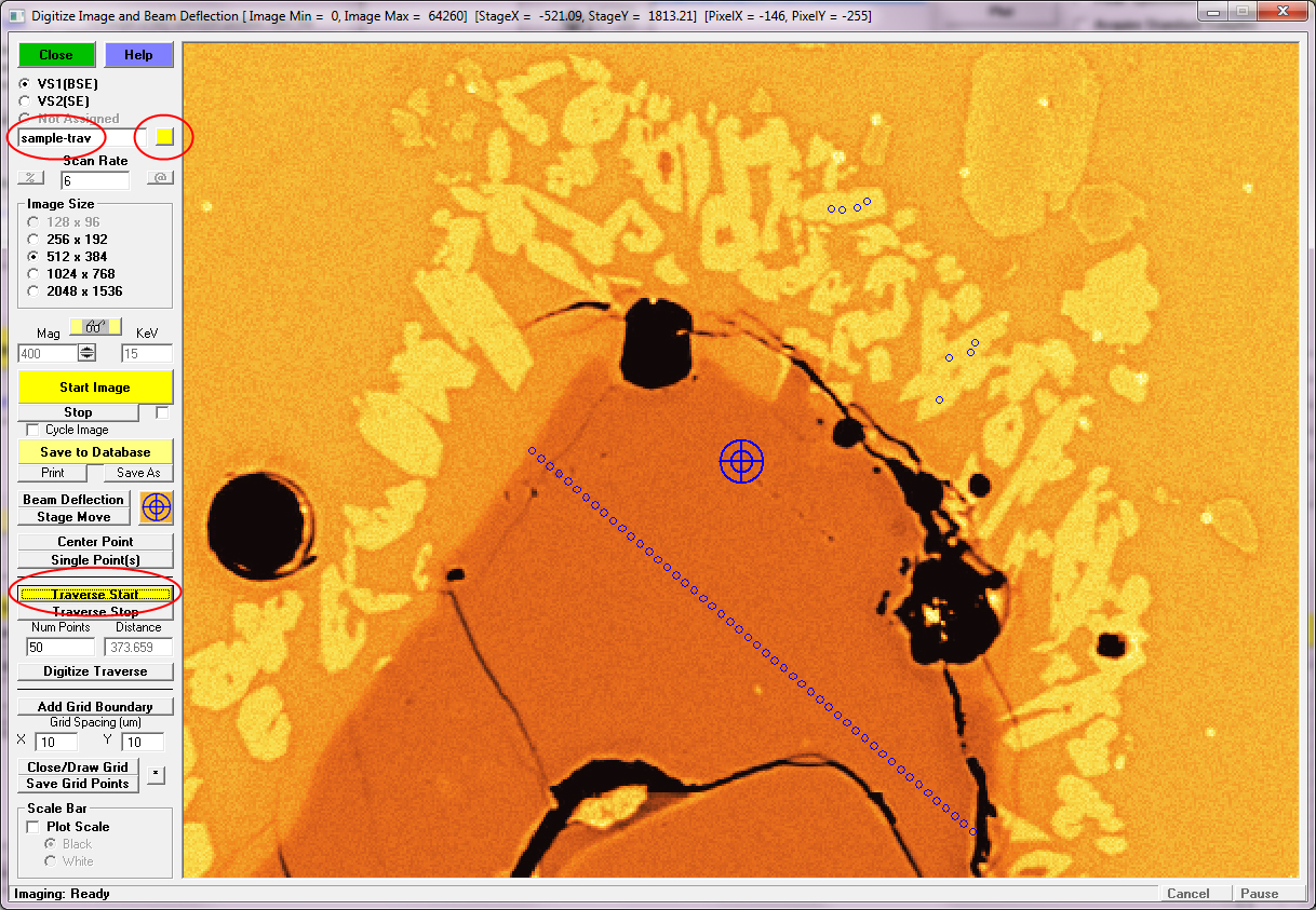

Both random selected points and traverses can be digitized.

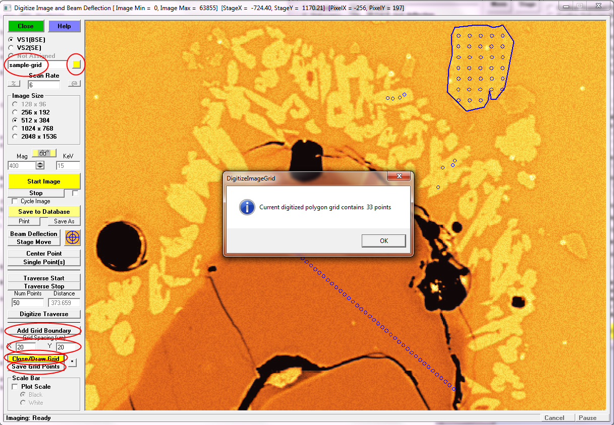

You can also digitize grids based on polygon areas as seen here:

Attached is a screenshot of this digitizing technique used to acquire a traverse on minerals in Martian meteorite EETA00079. The acquired traverse points shown can be displayed right on the BSE image or not, along with analysis line labels, etc.

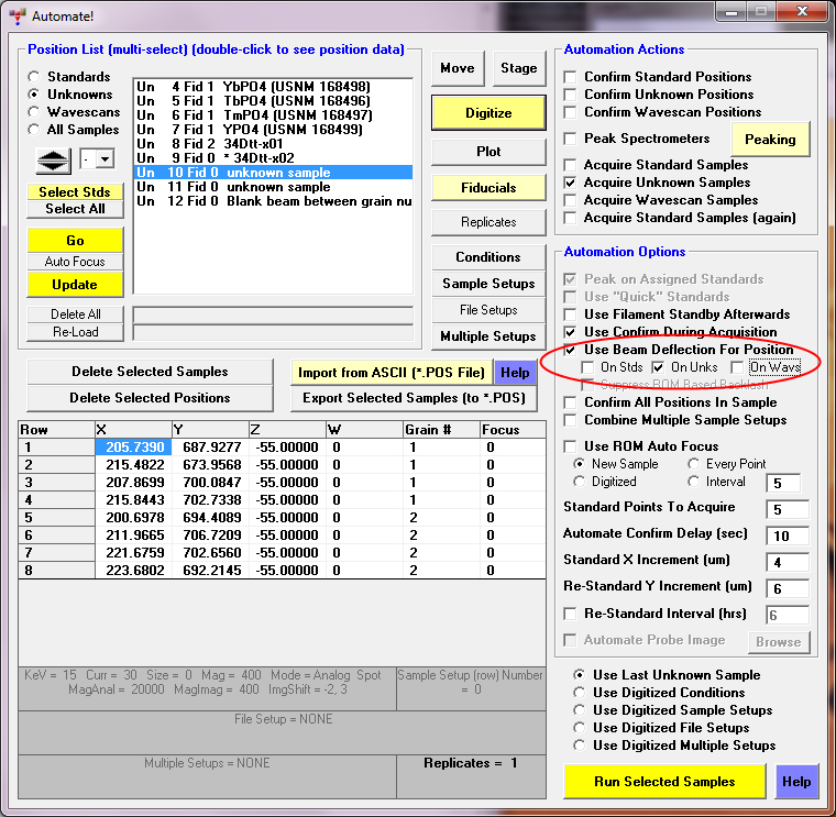

Dan R
Thanks for the detailed reply John. Do I have to explicitly click the 'beam deflection' button, or will the software be smart enough to realize that it doesn't need to move the stage when I click on points at high magnification?
-Dan
Hi Dan,
No, the software can't read your mind (if that's what you mean!)  ;)

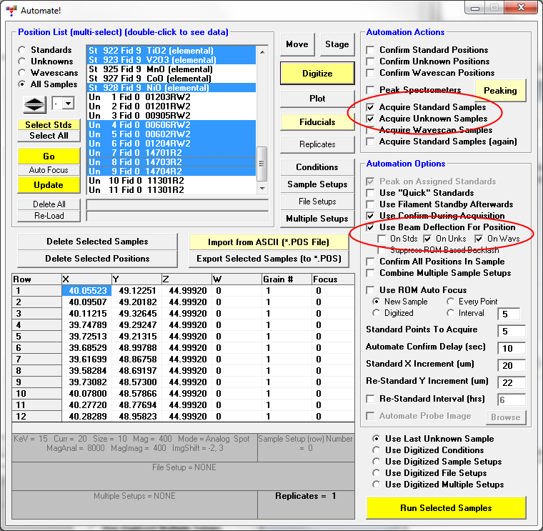

You need to select the samples you want to run, then select the Use Beam Deflection For Position option and finally select which types of samples (stds, unks, wavs) you want to apply the beam deflection to.

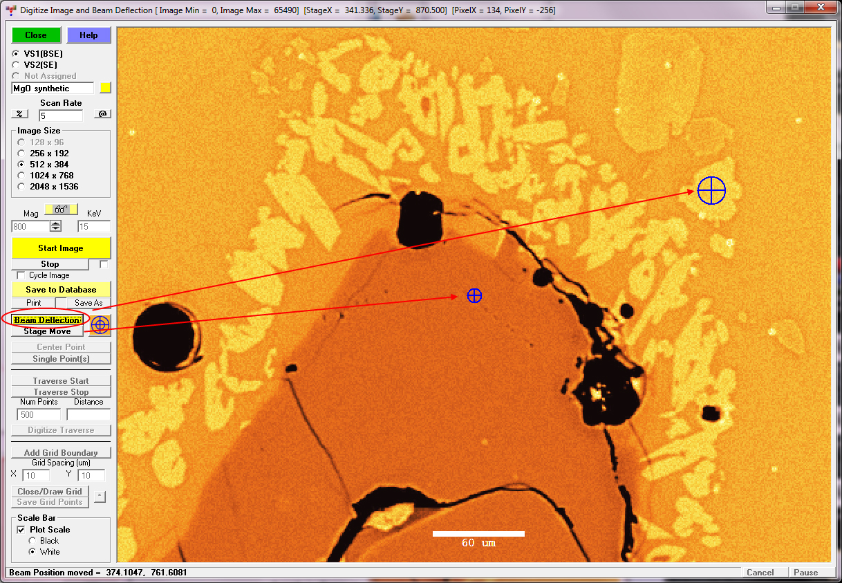

There are two methods to using digital beam deflection in PFE for point acquisition.

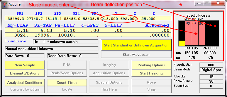

1. Manual beam deflection. In this mode the user acquires an image in the Imaging window from the Acquire! window and then selects the Beam Deflection button as seen here and clicks a spot on the image to move the beam spot to that position as seen here:
This method assumes that the stage position is in the center of the acquired image.  When the point is manually acquired from the Acquire! window, the current beam deflection position is shown on the progress display as seen here:
Note that the stage position recorded for this analysis position is based on the beam calibration.
2. One may also run manually digitized points using automated beam deflection. In this method, the user generally utilizes the Digitize Image feature in the Digitize! window to specify analysis points using the mouse.  The stage positions recorded are again, based on the beam scan calibration as seen in the post above:
http://smf.probesoftware.com/index.php?topic=70.msg263#msg263
When the position samples containing digitized positions are acquired, the program automatically moves the stage to the digitized stage positions, but if the user clicked the Use Beam Deflection For Position checkbox, then the program will instead move to the image center of each position sample and then utilize beam deflection for the point acquisitions as seen here:

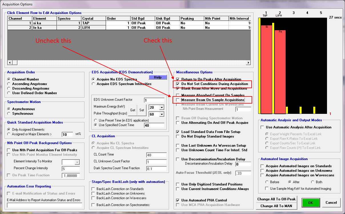

Secondly would it be possible to disable Faraday cup measurement for this adds a large amount of time to the analysis. With it just measuring the cup at the beginning and end of the traverse.  Also because it sets the beam current before analysis - this also shifts the image.
You can turn off beam current measurements and skip setting column conditions from the Acquisition Options dialog from Acquire!   There is no option for just measuring the beginning and end points for beam current.

Thanks that looks very promising. I need to give it a try. I hadn't noticed you could turn of beam measurement. I'd prefer to do it through PFE rather than putting it into calcimage.
One thing though is if you use 'do not set conditions during acquisition'. How do you set up the beam beforehand. For in doing a beam deflection traverse it needs to move the beam. Maybe I need to try stage reproduciblitiy instead.
Quote from: Ben Buse on August 04, 2016, 01:40:10 AM
It will deflect the beam in the appropriate mode, just not set the keV, beam current, beam size...
