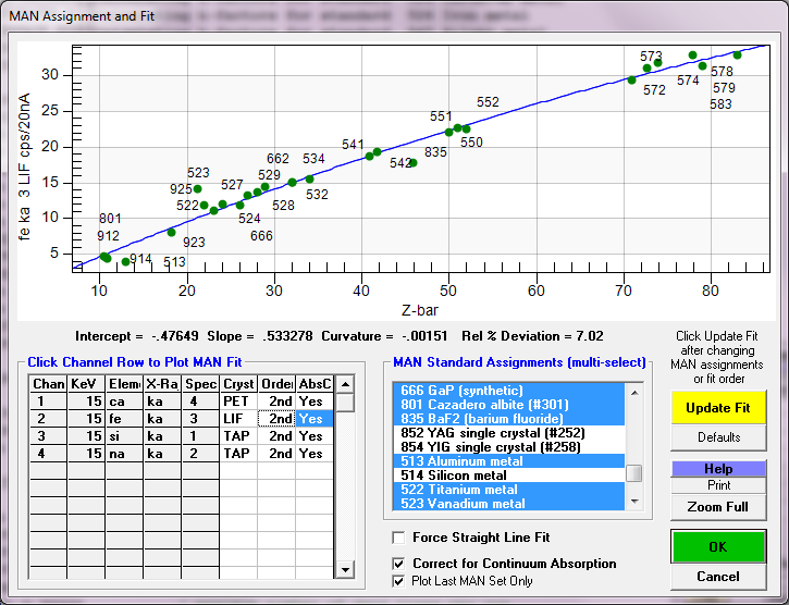

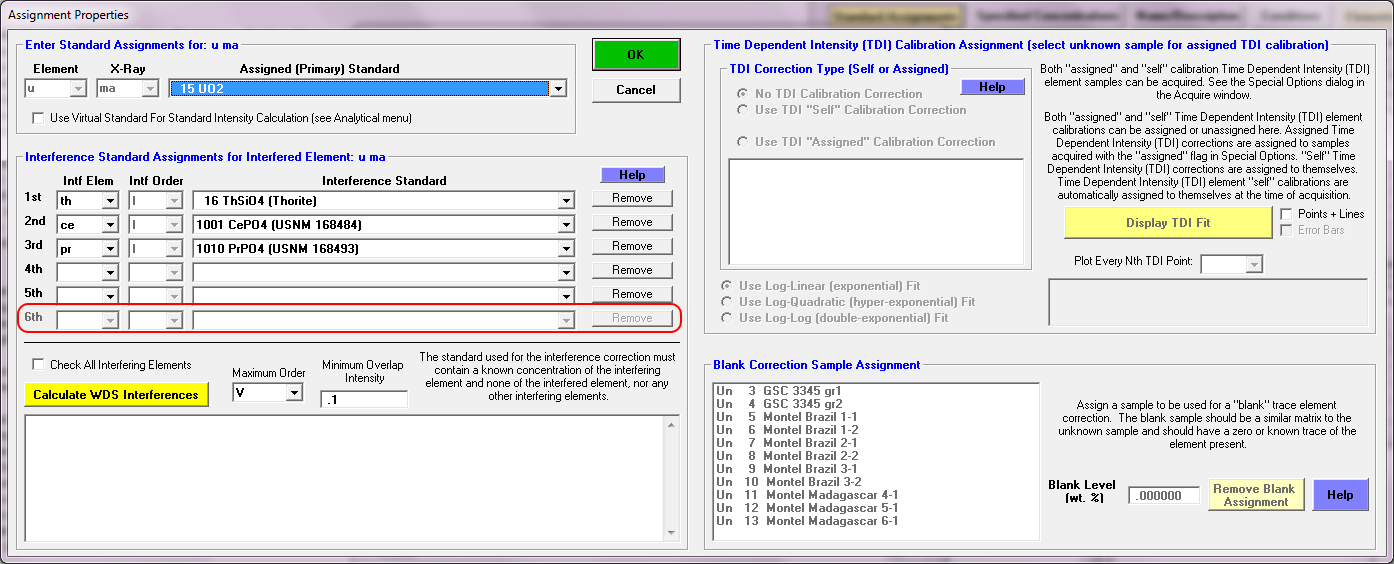

After a couple months of testing PfE on my new instrument (8230), I have been wondering about a couple missing (or removed?) options:
(1) A while ago (2010-2011), when we started the Multipoint Background Crusade for the [Holy] Grail of Trace Analysis, the option to "output multipoint background intensities" would actual export the individual measurements on each single background point set. Now, this feature returns only the background intensity under the peak calculated using the currently selected MPB fitting. It would be desirable to have in the multipoint background output the complete list of counting time, intensity, position... on EACH multipoint background.
(2) An option to export the data from a MAN would be welcome (i.e. an output of the average Z and intensity value of each standard for a selected element - ideally this would run as a batch and export all MAN data for all elements). This would allow for instance to compare MAN data overtime. Currently this cannot be done with Probe for EPMA, unless all these data are acquired in the same MDB file.
(3) It appears that the MAN assignment tool only allow for a maximum of 16 standards. I have been running a 31-elements run with 32 standards, and for some, I could well include over 20 standards in the regression! Not that I want to do this all the time, but for these first testing, I would like to see what "best" standard is suitable for the MAN background correction. Being able to plot all standards without limitation (or a high number, like at least 50-100...) would be ideal.
(4) Any chance we can increase the number of interferences per element (currently limited to 5). With my nasty and weird REE mineral analyses, some element would require at least 6 or 7 interferences corrections to be super accurate.
(5) And a long term project... That we could call hyperMAN, or maybe WoMAN? The idea: combining all MAN fit on one spectrometer to obtain a surface fitting
on ANY spectrometer position.

Quote from: Julien on September 17, 2016, 08:26:53 AM
I should be able to do this.
Yes, I think this can be done. There is no intrinsic limitation except the space necessary to fit the additional controls in the Elements/Cations dialog. That is a bit of a problem but I will see what can be done.
Hi Julien,
I increased the number of MAN standard assignments per element to 36. Here's an example:
Let's see how this works for you.  I could increase it more, but it will eventually slow things down more.
When you are ready please update to v. 11.6.4.
Hi Julien,
I increased the number interfering elements per element to 6 as seen here:
I could increase it more but I'd have to work harder to fit everything in. By the way, the 6th interfering element will only be available for new MDB files.
When you are ready please update to v.11.6.4.
