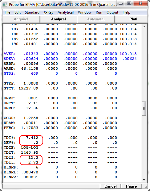

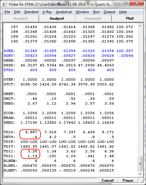

We can confirm this numerically but running the quantification. Here is the TDI without aggregation:
Note the DEV% number. Now, here with intensity aggregation:
Notice that the TDI DEV% went from 0.6% to 0.2%, a decrease of a factor of three. TDII: is the intensity intercept and TDIL: is the log intensity intercept.
Super cool. Many thanks for developing and implementing that over such a short span, I think it will be very useful. I have sort of highjacked the Wishlist thread into a development thread, so feel free if you want to take these Alternating On/off posts from the Wishlist thread and make a separate thread out of them...
Time to play with the new feature~
