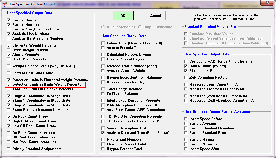

Hi Owen,
OK, I added detection limit output in oxide wt% to the user specified format in PFE.
Update to v. 11.8.2 and you should be good to go.
