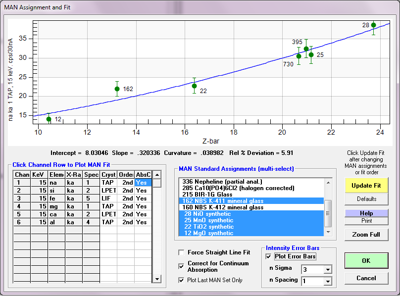

Now that we have error bars for TDI and Multi-point, can we have them for the MAN fits too :D? I always wonder if I am overly critical when fitting and excluding standards.
Hi Anette,
Finally got around to implementing errors bars for the MAN fit dialog in PFE (as usual please use the Help menu to update):
This plot is interesting because it shows that all the MAN standards have zero Na within variance, except for the K-411 glass (#162), which I've determined using off peaks is around a couple hundred PPM... so technically, it should be removed from the fit.
Sorry this feature took so long.  I've been busy!   :)

The MAN errors are very nice.
At the moment these are count stats (approximately square root of counts) right? I wonder if it is better to use count stat error or the standard deviation. If people collect multiple points per standard for the MAN backgrounds then the standard deviation of the points is more representative - or maybe a choice?
Quote from: Ben Buse on August 16, 2017, 06:04:24 AM
Yes, they are the square root of the raw intensities, so a 1 sigma variance.
Yes, the standard error would be more appropriate since these are usually the average of several points, but well, no one seems to utilize standard errors even when they should!
I once asked a statistics person why don't people use the standard error rather than the standard deviation for the variance of the average and he said: "I don't know, maybe because it's a more conservative number?"
I normally acquire at least 3 data points on each standard (including MAN standards), but others may not, so the variance is a safe bet to display.

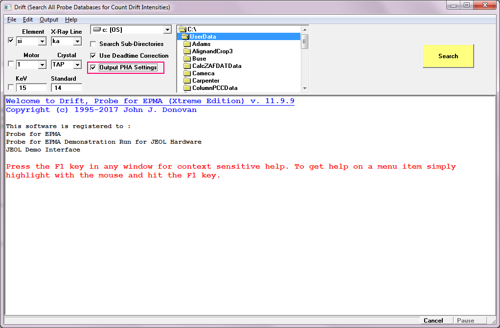

not so much a request for PFE but for Drift. Would it be possible to add detector baseline, gain and bias to the output variables?
#328
Quote from: Anette von der Handt on September 28, 2017, 06:53:15 PM
Hi Anette,
I didn't add the PHA parameters to the Drift app to begin with, mostly because I think of them more as settings as opposed to measurements, but I can see how (user) changes in the gain or bias settings over time might be interesting.
So the latest version of Drift.exe has a new checkbox as seen here:
Ready to download.
