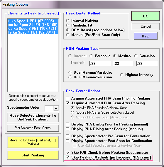

What would be nice is in acquire window, under peak options - allow the PHA scan without running a peak scan.
So you can Peak and Bias scan. Then set the bias. Then run a base scan for all spectrometers without having to rerun the peak scan
What do you think?
Quote from: Ben Buse on March 15, 2018, 03:27:17 AM
I second that!

Hi Ben and Karsten,
Ok, so I let this idea (which is a good one), ferment around in the back of my mind for a few days and finally thought of a cool and easy way to do this.  To be honest I think Paul Carpenter asked for something like this a few years ago, but that the time I couldn't think of a nice way to implement it.
So the latest version of Probe for EPMA now has a new checkbox in the Peaking Options dialog as seen here:
So now one can acquire multiple spectrometer PHA only scans (for up to 72 elements), automatically on a sample from the Acquire! window.
And from the Automate! window one can run multiple spectrometer PHA scans for multiple standards, also automatically. And on the primary standards, if those standards are assigned as primary standards for the current sample (or on any sample that has sufficient intensities for peaking or PHA scans).
And as usual with PFE, all scans (peaking or PHA) are saved to your run automatically...
Please update from the Help menu and let me know how it works for you all.
