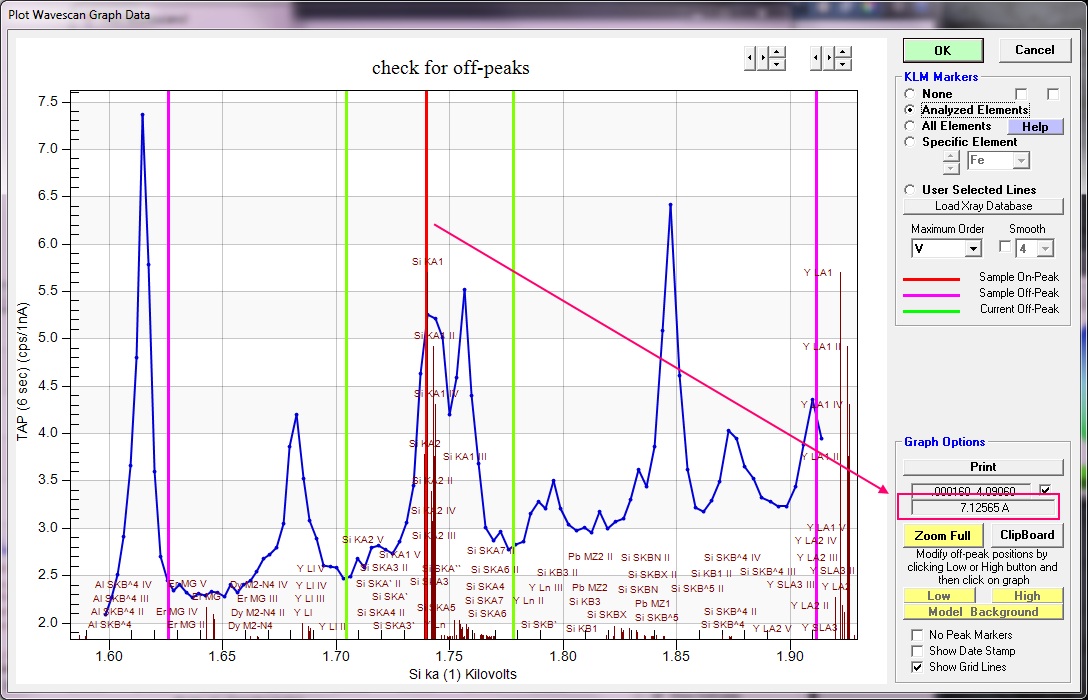

You already have the possibility to show absolute spectrometer positions. It is a little check box in the plot window (it always is ;)) See attached screen shot.

Thanks Annette and John, I wondered what the check box was for, now I know. Is there any reason, though, why the relative and three sets of absolute values couldn't all be displayed at the same time rather than having to switch between? There's plenty of room that side of the plot window. I'd particularly like to have the absolute energy so I can check my EMAS desk mat (every probe lab should have one😉) to see if it might be an unexpected element in the sample.

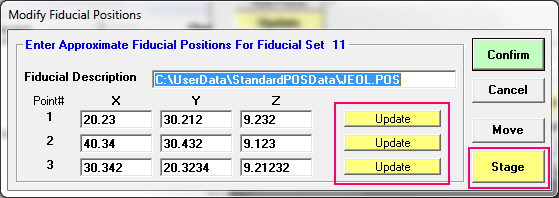

Note the Stage button in the fiducial confirm dialog?  If you click this button you can use the StageMap to get you close to the fiducial position and when you close the StageMap window you can click the Update button to update the fiducial you are on.

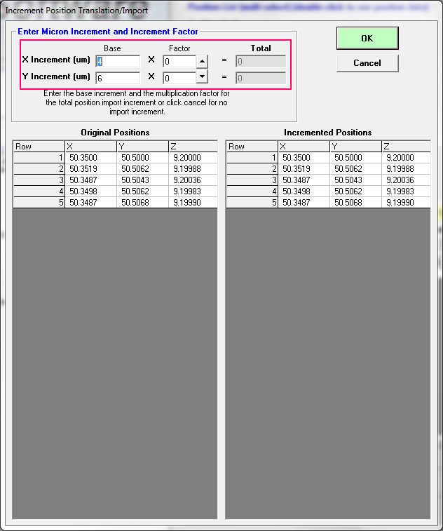

Also, as an alternative, since the FEI and JEOL instruments use mm stage units, you can click "No" when it asks if you want to transform the fiducials and simply apply some mm offsets using the import increment dialog:
Edit by John: Ooops! just remembered JEOL is anti-cartesian and FEI is cartesian so the import increment feature won't work!  Better to use the fiducial transform or PictureSnapApp as described below...

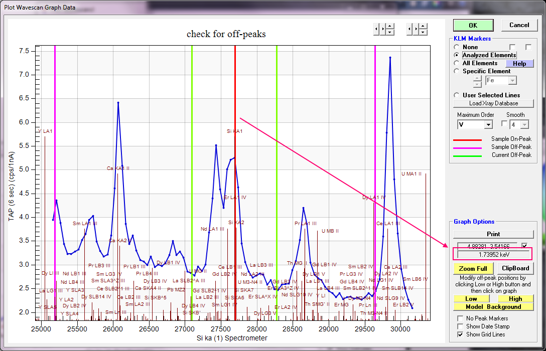

I think we implemented what you want.  Here is the modified Plot! dialog in spectro unit mode showing the actual keV of the mouse position:
The keV cursor position is also displayed when the plot is in angstrom mode.  And here is the same plot, but in keV mode, in which case I decided to plot the additional mouse cursor position in angstroms (not nm, but hey, that's easy to convert in your head!):
Update from the Help menu and it should all work.  Remember to uncheck the little checkbox for absolute x-position display in whatever plot mode units you are already in.

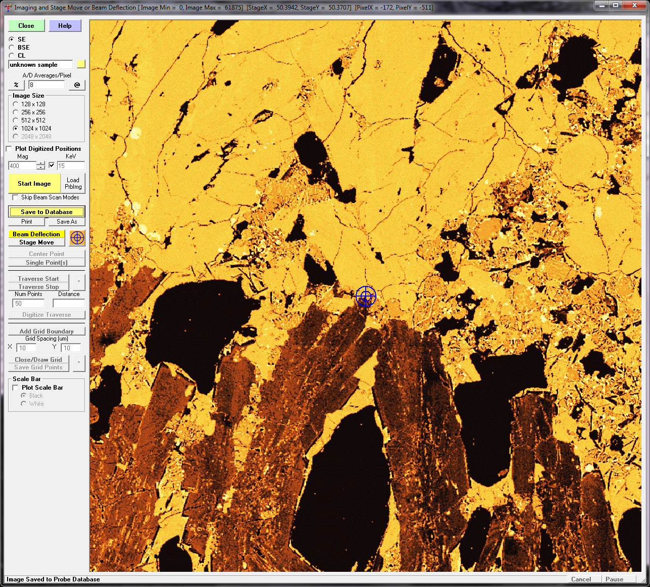

Digitize Image is very useful to set positions to be analyzed on the acquired image.
It would be better if the window is resizable or if the image is zoomable. That is, if the window size for 1024 x 1024 is ~4 times larger than that for 512 x 512, it would be much easier to find good points for measurements. (Same suggestion for displaying window.)

I modified the code for the Imaging and Digitize Image windows. You can now make them as large as your monitor allows.
I tested the beam deflection and digitizing functions and they all seem to work with the resizable window. But please let me know if you find anything that doesn't seem right.  I haven't had a change to look at the Display Images dialog yet, but I will get to that.
Changkun
I tested both the Imaging at Acquire! and Digitize Image and both work nicely.
Thanks a lot.
