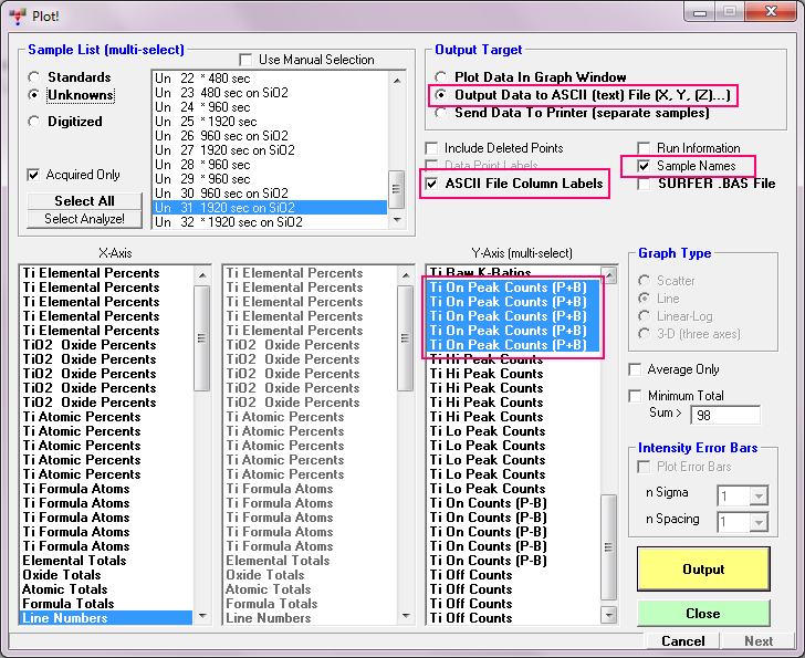

#412
I am trying to use the user specified output from PfE for some data, where I am only interested in the counts. So I did not measure any standards. The program is complaining that it cannot find standard counts...
Is it possible that if I select in user specified output only net counts and things like that PfE does not check for standards?

#413
Hi Philipp,
The user specified output format is intended for quant output, but did you try the NIST output format?  It outputs raw intensities.
also the NIST format is asking for standards.  :'( :'( :'(
Just would like to export my data. But I do not have standard measurements for this project and it is a lot of work to measure fake standards for many elements and different HVs.
No way to use the user output for intensities without standards?

I am aware of the copy buttons. But this involves many clicks and lots of sources for errors. It is really not advisable.
So I will make myself some fake standards or something, just to get the data out. It would be really nice to have a tick box somewhere that allows to export unquantified data without the need of fake standards.
Philipp

Hi Philipp,
I think I have an output solution that will work for you (I don't know why I didn't think of it before!).
Simply go to the Output | Output Standard and Unknown XY Plots menu and change the "output target" to Output Data to ASCII as seen here:
As long as you don't select one of the quantitative output types, it will just write your data to a tab delimited file, and optionally export it to Excel.  Please let me know if this works for you.
good idea! I tried it and it worked. But I also have the 42 fake standards now (7 HVs * 6 elements). So not certain if it would throw an error.
But it looks like it does not try to read any standard data and just spits out the counts. Maybe you should mention this in the PfE tricks thread.
Philipp
#419
I think you should post about this output option and also your "fake standards" method also in the PFE Tips and Tricks topic.  Sounds like it could be useful.  How did you fake standards?  Did you use the simulation mode?
