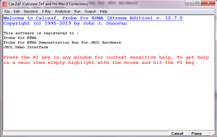

We've had a bit of a "hodge-podge" of keyboard shortcuts in PFE and CalcZAF and decided to make them more consistent and uniform for all the apps. First of all we removed all the <ctrl> shortcut keys and replaced most of them with <alt> key shortcut combinations. We also added some new <alt> key shortcuts for some menus, such as the Edit MAC Table as you requested.
As an example, here is what the main main log window in the CalcZAF app looks like when started up:

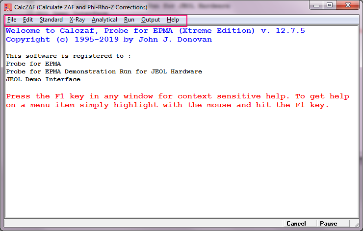

Now when one holds down the <alt> key things change. Can you see that?  Yes, each main menu item now has the first letter of each menu *underlined* as seen here:

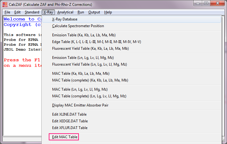

This underlining will now be the new "hint" for the <alt> shortcut keys.  Now if the user say, hits the "x" key for the X-Ray menu, the X-Ray menu will be displayed as seen here:
Then the user simply hits the "e" key and the Edit MAC Table dialog will appear for custom editing of the current (default) MAC  table.  So <alt> "x" and then "e" now opens the Edit MAC Table dialog. The tab order should be OK now too.

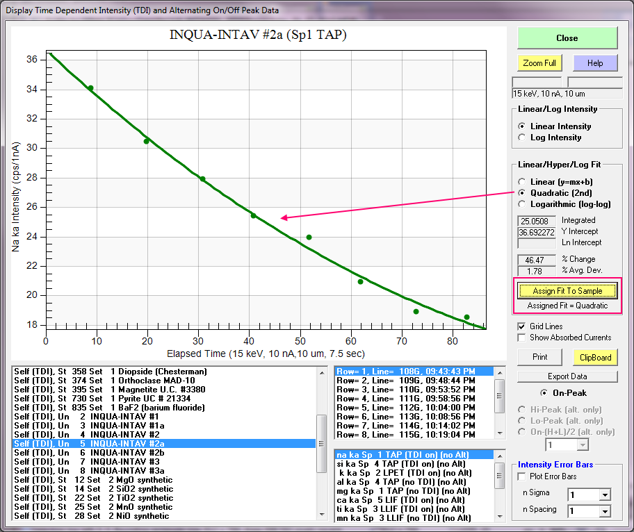

So what we did was add a button to assign the currently selected and displayed TDI fit method (linear, quadratic, and logarithmic) to the selected element in them selected sample.
Note that unlike the TDI fit display in the Standard Assignments dialog in the Analyze! window, this TDI dialog only displays one data point (line) at a time, but the TDI fit assignment is applied to all data points (lines) in the sample. So one should be sure that the selected fit is appropriate for all lines in the sample, not just the one displayed.
That said, once we added an assign TDI fit button we then saw a problem, and that was that there is no display for what the current TDI fit assignment actually is!  So we added a label that displays the current TDI fit for the selected element and selected sample as seen here:
Then when the user selects a different TDI fit, that is displayed in the TDI graph and so if one then clicks the Assign TDI Fit To Sample button the TDI fit is assigned to the selected element and sample as seen here:
And the label is updated to reflect the change in the TDI fit type.

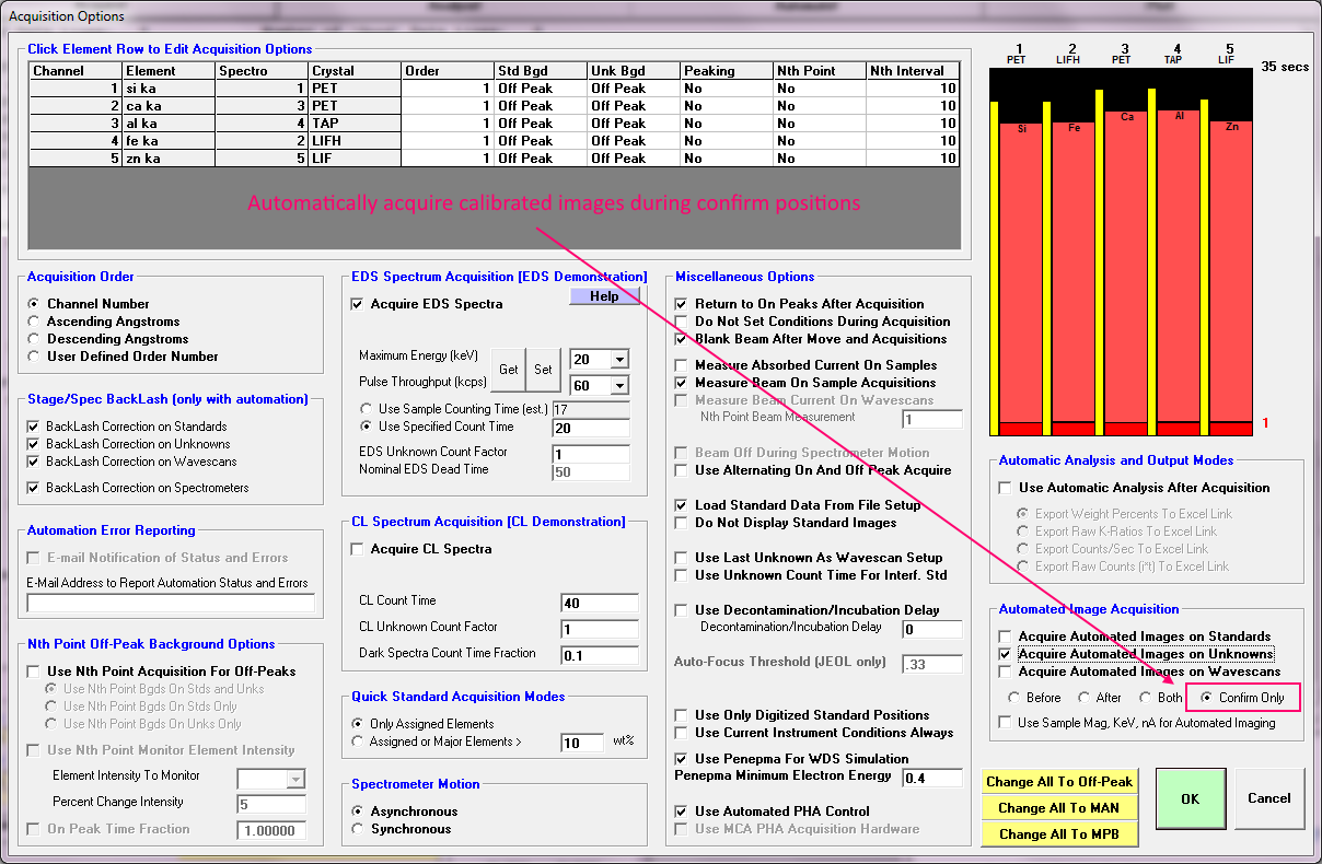

My wish is to have an "Acquire Images" tick box in Automate | Automation Actions, which would then acquire an image for every sample in the Automate position list (e.g. using the "last unknown" beam settings and Acquire | Imaging image settings) without running an actual x-ray acquisition.
Or is this already possible somehow?
We often acquire automated BSE images during Automate! runs using the functions in the Acquisition Options dialog, as they are very useful for providing textural context to the analysis data, but sometimes something goes wrong - e.g. we've picked the wrong beam current, magnification, brightness/contrast, detector signal for the image acquisition without noticing... and all images (sometimes hundreds...) are useless. So it'd be great if I could just fix the settings and quickly acquire all images again without repeating the actual analyses.

Your wish is granted!     :)
It took a bit of thinking and some code re-arrangement, but we found a way to allow automated acquisition of calibrated images in PFE from the Automate! window when simply confirming stage positions.  These images will be automatically saved to your currently open probe database.
Download v. 12.8.5 from the PFE Help menu when you are ready to try it out.
