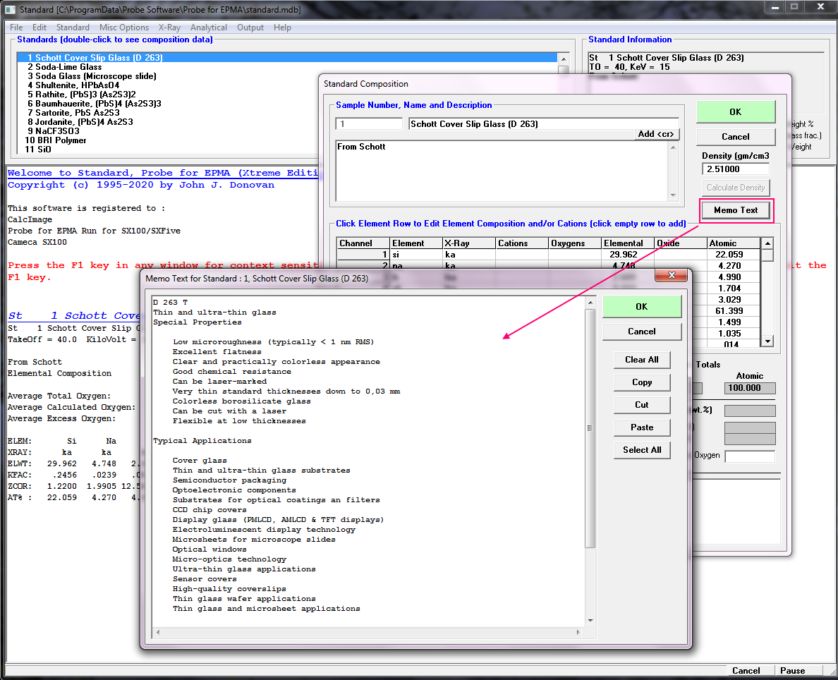

Along the lines that Mike Matthews suggested I think we've implemented something you can use. Update using the Help menu to PFE v. 12.8.9 and open your standard database. There's now a new button in the Standard | Modify menu dialog called Memo Text as seen here:
This gives you a 64K character memo field for additional documentation (in addition to the existing 255 character description field).
Let me know if this works for you.
