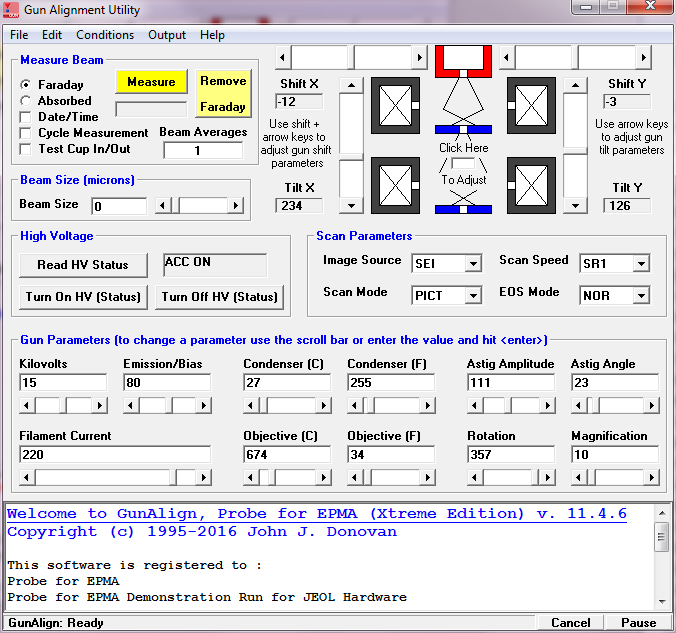

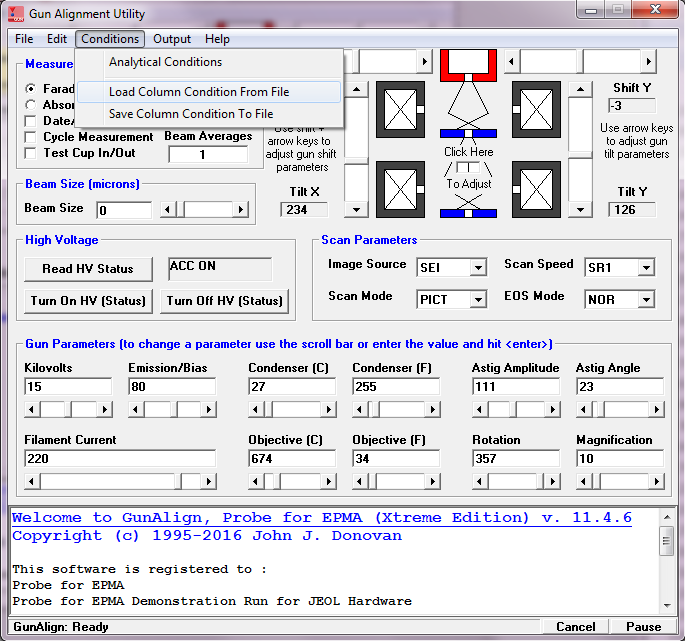

Here are some screenshots of various JEOL utilities that are provided with Probe for EPMA. First the GunAlign utility:
and here with the Conditions menu open:

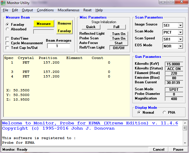

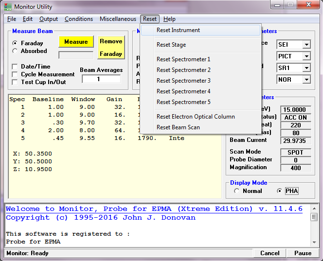

Here is the Monitor utility:

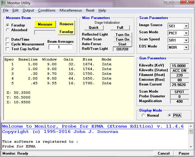

and now in PHA mode:
and now with the Reset menu shown:

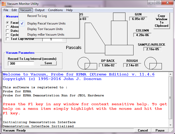

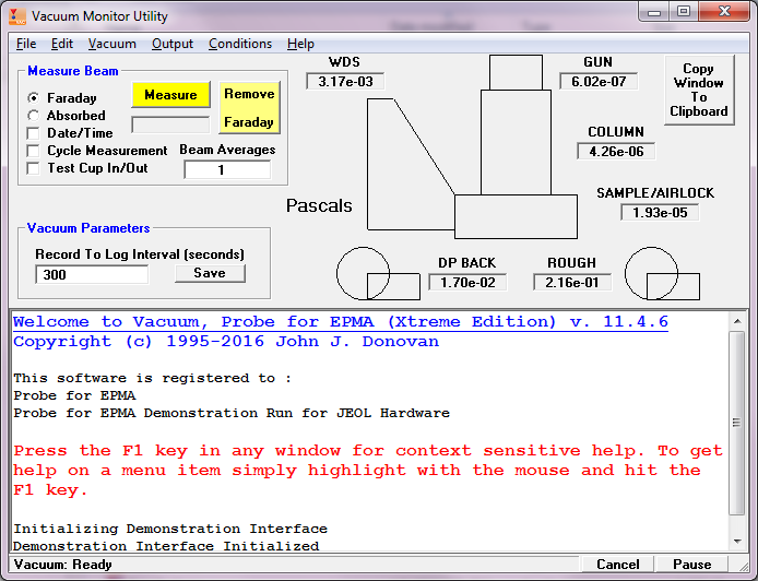

Here is the Vacuum utility:
and with the Vacuum menu shown:

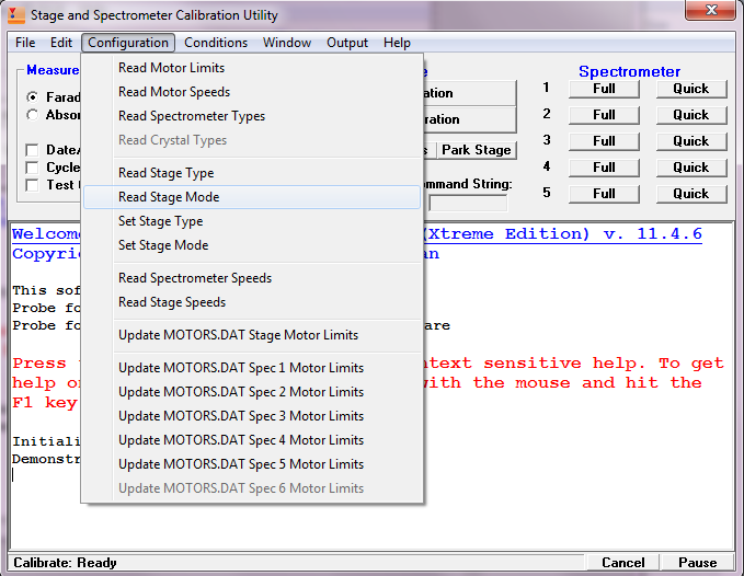

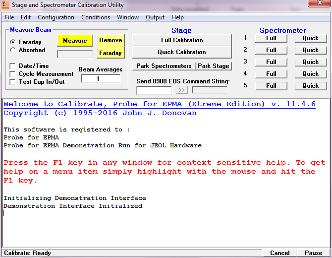

and here is the Calibrate utility (you'll need to run the TestProbe.msi installer to get this utility):
and here with the Configuration menu shown:
Note that the Calibrate utility should only be used by advanced users.
Quote from: Anette von der Handt on April 14, 2016, 04:22:02 PM
Where do I find this TestProbe.msi? :)
Hi Anette,
Check any of the PS FTP sites and it should be there.     :)
I'm just uploading a new version at the moment, so please wait a few hours before you go looking for it.
Edit by John: Ready to download now.

Sorry, I can't see how to get to TestProbe.msi. I always update either direct from PfE and CalcZAF or use the link for PI, both methods just start the relevant downloads so I don't see the ftp site itself. How do I get to this?
Quote from: Mike Matthews on April 16, 2016, 01:21:57 AM
Yes, sorry.  It's only available to beta testers at the moment.   We need to make sure it all works first.
But because you're such a cool dude, I'll add it to the PFE Dropbox and invite you.   8)

The GunAlign, Monitor and Vacuum utilities have been recently tested and appear to all be working fine for the 8900/8200/8500 JEOL instruments.
Except for the JEOL 8900 which only has an analog vacuum meter and therefore has no interface for vacuum readings from software.  Please let me know if you see anything that doesn't appear correct.
