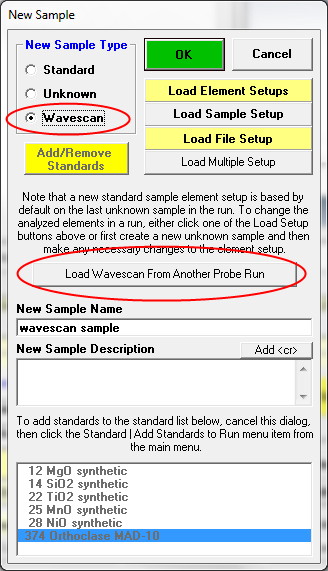

I have a large number of wavescans that I have done over the years using the JEOL 8200 Qualitative Analysis software. Most of my standards have been scanned for the full length of all 5 spectrometers, each with different crystals. Is there any way to import that data into PFE to display in Plot! to check backgrounds for example, without having to rescan from PFE?
How would you like to do this?
For example, you might already know about the Load Wavescan From Another Run button in the New Sample dialog from the Acquire! window:
Would it be ok to have all your wavescans in a probe database that you could select from to import?  What form are the data files in now? Can you send me an example?

Quote from: John Donovan on October 14, 2013, 03:17:04 PM
That is clear, but could you explain how I can use one WS for different elements?
For instance, if we collected WS with LIF (from edge to edge), channel 5 on CuFeS2 standard and indicated to the system we collect signal only for Cu. Is it possible to use this WS for choose, correct and analyze   peak and BG positions of Fe?
Thank you!
Each wavescan sample can contain multiple elements. You can import full range scans but the calibration is based on the peak element.
This feature will load the wavescans for all elements contained in the wavescan sample,  So up to 72 elements.  Try it and you will see.
