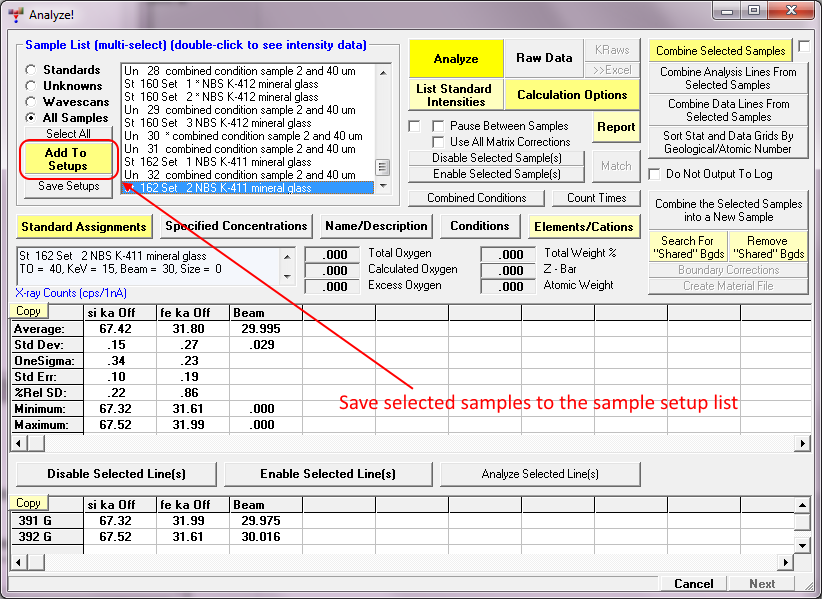

If you create a 'master list' of elements as an unknown, then use the 'add to setups' button in Analyze! you can subsequently reuse the master list sample setup when creating new unknowns. You can then modify the list of elements in the new unknown 'on the fly' by either deleting (or adding elements), or simply disabling the acquisition of elements.

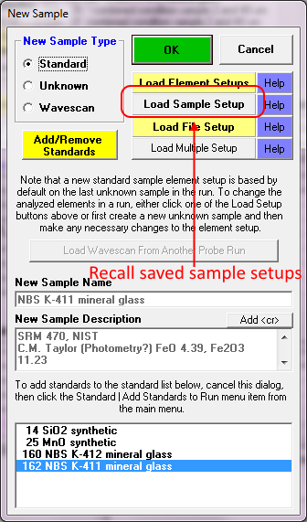

In fact you can make multiple sample setups in Probe for EPMA by clicking the Add To Setups button in the Analyze! window,
and then recall them with a mouse click, from the Load Sample Setups button in the New Sample Setup dialog whenever you want to.
For example, you can have a feldspar sample setup, an olivine sample setup and a glass setup all with different elements and conditions all in the same run.
