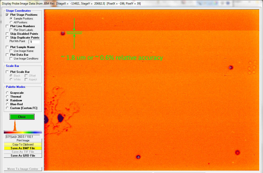

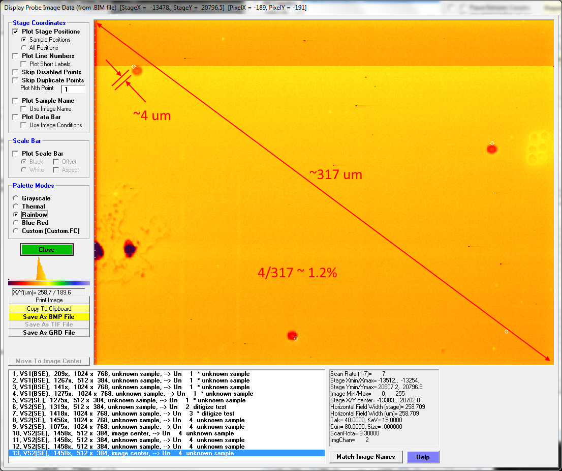

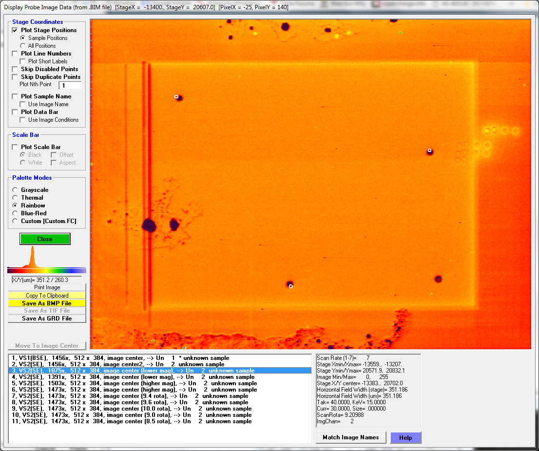

First let's look at an image I acquired with the analysis positions displayed (you'll probably want to click on the embedded images to see them better):
So there is some offset from the beam burn positions, but please note that this image was acquired using my default calibration from ~6 months ago, which could be suspect as we had a complete column rebuild since then, but a larger issue I soon discovered was that I only calibrated up to 1335x and the recent image calibration testing I did was at magnifications a little higher than that. So there is some extrapolation involved. (By the way, I've never had our engineer adjust the scanning coil electronics, and instead have always opted for a software calibration.)
But first let's calculate the relative accuracy of these displayed positions relative to the beam burn positions on the above image.  Using the click and drag feature in the Display, Annotate and Export Analog Signal Image dialog, I found that the image diagonal length is ~317 um and for the upper left analysis point, the distance between the beam burn and the displayed circle is about 4 um, which is an error of about 1.2% relative, or about 2.4% relative based on just the radius.  Since Cameca instruments have a specified accuracy of 3% relative for magnification, that doesn't seem all that awful, but perhaps we can do better.
But first let's look more closely at the same image and see if we can determine whether it's the displayed image or the displayed analysis positions that are in error. The coordinates of the analysis positions are listed here:

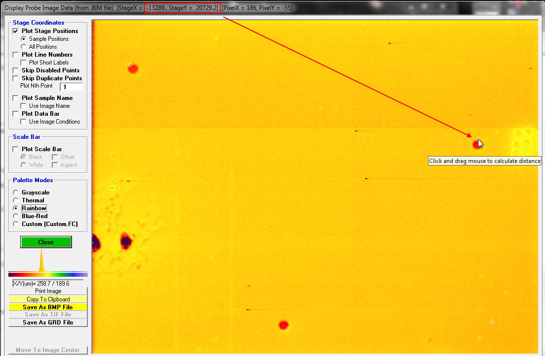

Stage (or Beam Deflection) Coordinate Positions:
          X          Y          Z                X          Y          Z
    4G  -13490.00  20771.00  69.00000    5G  -13289.00  20729.00  69.00000
    6G  -13399.00  20622.00  69.00000    7G  -13281.00  20626.00  69.00000

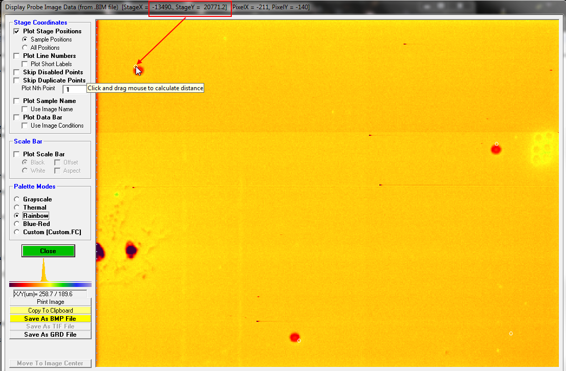

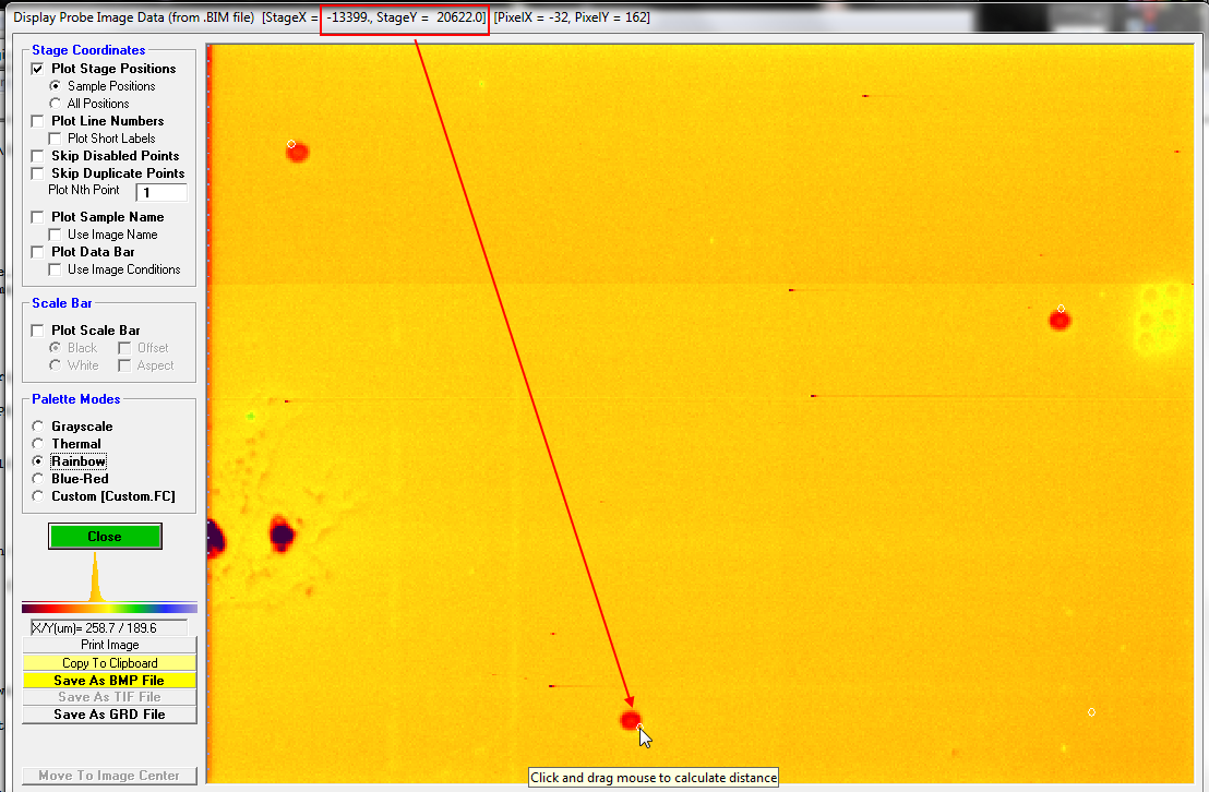

Starting with the first analysis position (point 4), we have a recorded stage coordinate of -13490 for x and 20771 for y. Here is the mouse cursor captured while sitting on the displayed analysis position for point 4:
We can see that the displayed analysis position is exactly at the acquired stage coordinates, and in fact it is the image (and beam burn) that is off from the calibrated stage position!  We can do the same for the other two positions and in all cases the displayed analysis position is *exactly* at the acquired stage position, while the beam burn (image) is off in calibration. Here is point 5 (-13289.00  20729.00):
And here is point 6 (-13399.00  20622.00):
So, to me this means that the software is correctly displaying the stage positions, but the image itself is not exactly calibrated.  In the next post I will continue the discussion of my testing, but please feel free to disagree with me...

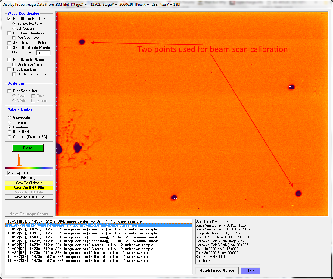

Now, as I mentioned above, my highest mag beam scan calibration was at 1335x, while the image was acquired at 1458x, so I decided to perform an additional calibration using the "@" symbol button in the Imaging window at a higher mag (note that generally I suggest that one should utilize the stage image/beam image calibration method in CalcImage as described in the CalcImage board, as that method will utilize a three point calibration and therefore also calibrate the scan rotation, which as we will see is also very important.
After the two point beam scan calibration at 1456x I started a new probe MDB file (this is very important as the MDB file contains the beam scan calibrations for the images stored in that MDB file, and if you re-open the MDB with the old calibration, that is what you will get) and re-acquired the images and analysis positions and now the Display... Analog Images dialog shows this:
The beam burns in the image are now much closer to the displayed stage positions, but not exactly perfect.  In fact, to me they seem a little rotated. So I adjusted the scan rotation (probably from the column rebuild we recently had) to 8.5 degrees and re-acquired the image (remembering to turn off the scan rotation send by unchecking the little checkbox next to the Start Image button in the Imaging (or Digitize Image) window) and here is what I got with the same analysis positions:
So this image shows about 0.5% relative error in the image (or ~1% relative) in the radius (for point 4, though better for the others). To which I say: good enough for me!

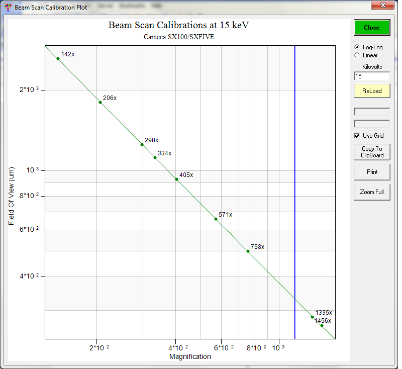

I went and did a few low mag beam scan calibrations in PFE today, to check on the calibration accuracy when below 1000x. I only did two point calibrations from the Imaging window, but when plotted up in CalcImage, the fit looks pretty good:
Here are the calibrations for my Sx100:
[tt]; Beam scan calibration
ImageInterfaceCalNumberOfBeamCalibrations="9"
ImageInterfaceCalKeV="15,15,15,15,15,15,15,15,15"
ImageInterfaceCalMag="142,206,298,334,405,571,758,1335,1456"
ImageInterfaceCalXMicrons="2621.54,1799.7,1248.7,1118.275,926.9622,659.7579,498.7495,282.546,263.027"
ImageInterfaceCalYMicrons="2001.77,1378.0,957.1,848.4153,705.2865,504.1712,376.3542,207.0935,195.326"
ImageInterfaceCalScanRotation="8.6,8.6,8.6,8.7,8.8,8.9,9.1,9.3,9.3"
[/tt]
When I load a low mag image (~150x) into PictureSnap and double click on various features, the stage drives to within 5 to 8 um or so, which considering the 2600 um width of the image, that amounts to roughly 1/2% accuracy. That I think is about as good as we're going to get given the hysteresis and non-linear lens effects in EPMA instruments.
