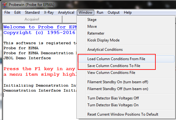

Here are some screenshots to show you where the PCC file (which stands for Probe Column Condition by the way), can be accessed.
First from the Probe for EPMA Window menu as seen here:
I usually start the morning by loading the last saved PCC file, which will properly warm up the filament and set all the necessary gun parameters.  Note that for FEG or LaB6 guns (ThermalFieldEmissionPresent=1 in the Probewin.ini file), the filament parameters are not utilized.

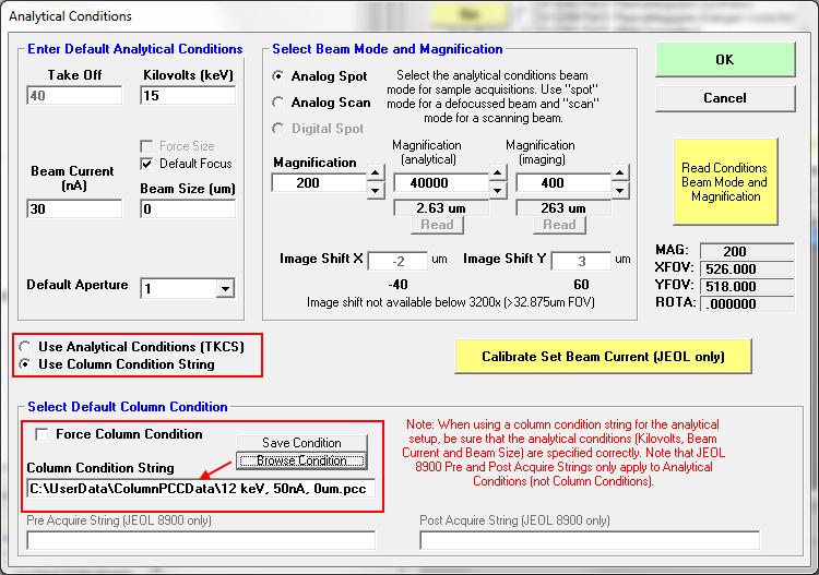

One can also save/load Probe Column Condition (PCC) files from most of the Analytical Condition dialogs as seen here:
