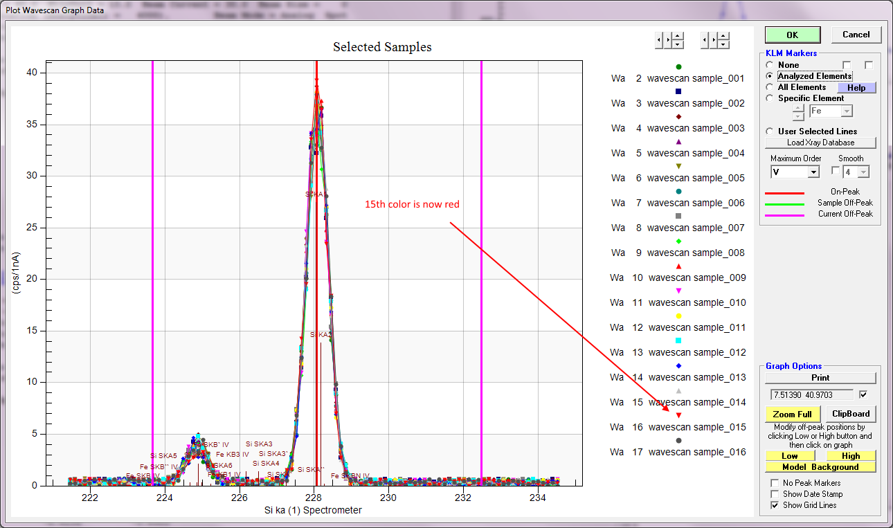

OK, I fixed the 15th plot white color issue (for both wavescans and unk/stds) in the latest version of PFE as seen here:
Note that the above wavescan plot data were generated using the new WDS simulation in PFE!
Many thanks John, works great now - no more white wavescans on white background!
