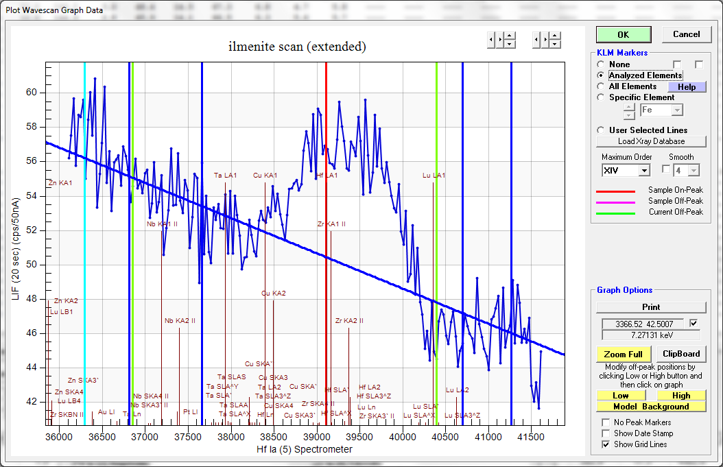

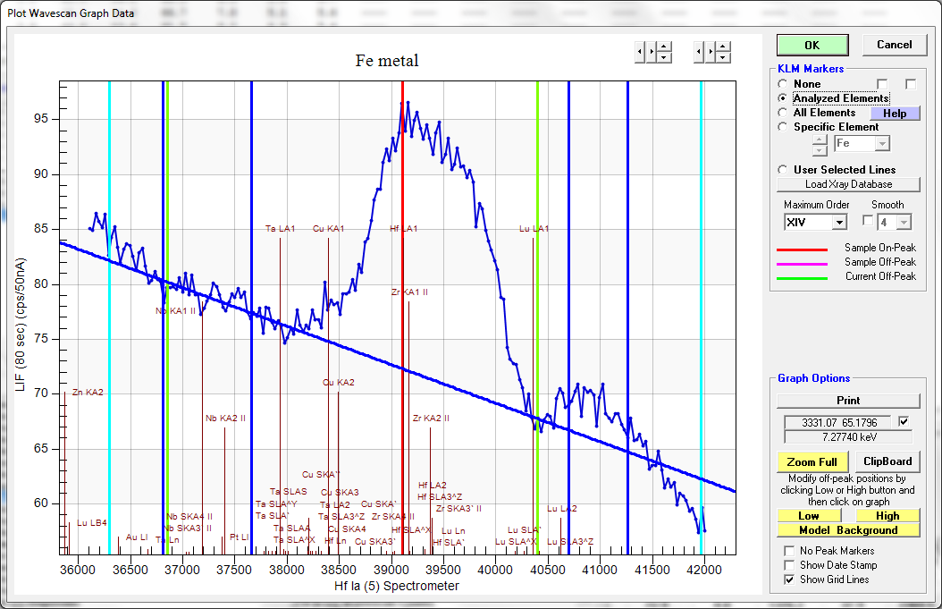

Anywho, during the method development I acquired some high precision wavescans on of their ilmentites and noticed this odd "peak" in the Hf La region on an LiF crystal:
You can see (most) of the MPB (multi point background) measurement positions that I decided to utilize for this effort. But the thing is this peak is *way* too wide to be a normal spectral emission peak and I have no idea what it is, but it creates an "interference" of around 0.3 wt% Hf in pure iron metal.
Then last night I extended the range a bit more to see the remaining MPB position and increased the acquisition time for better precision and now we see this:
So what the heck is this "peak"? Has any body seen this on their instruments/crystals?

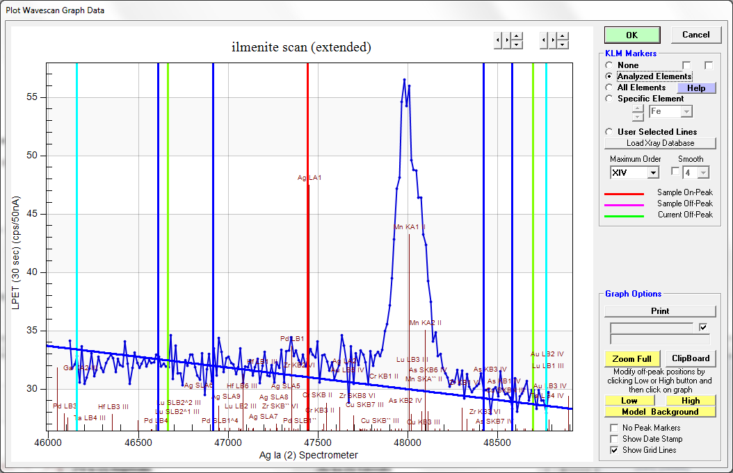

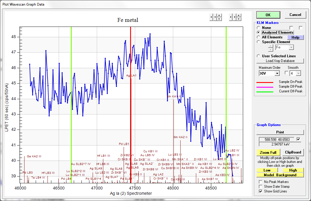

Here's a similar looking artifact, but this time on a PET crystal and sitting right on top of the Ag La emission line position!  It's hard to see in this scan but look closely:
Again it seems to be associated with the presence of iron, because here is a higher precision scan on our pure Fe std:
Has anyone seen anything like this before?

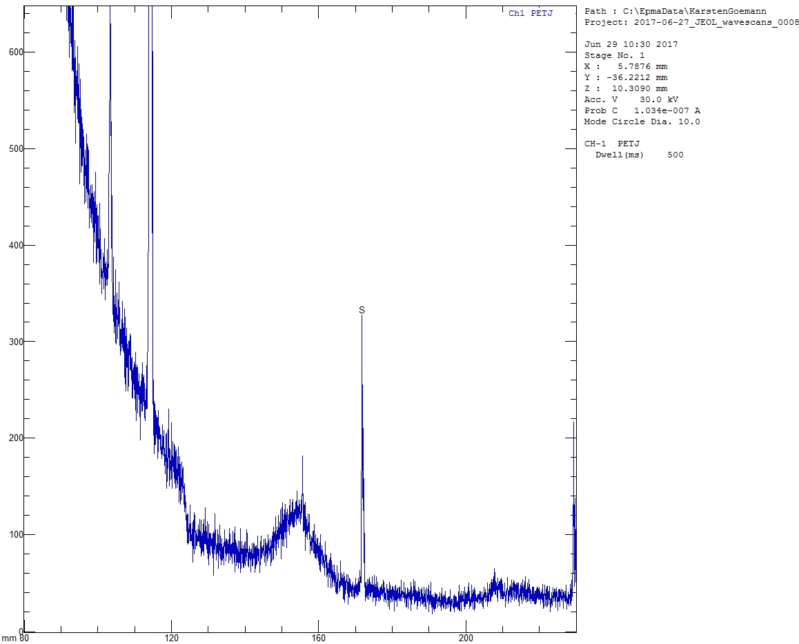

It looks similar to what we in JEOL land (Karsten G., Dave A. and I) called "the hump" and was caused by BSE electrons making it into the detector despite the electron trap. It showed at the same position on all crystals and scaled with BSE yield of whatever you ran on. Not sure if its the same as I lost my ability to read Cameca positions but run a scan on something like gold and see if it gets worse?

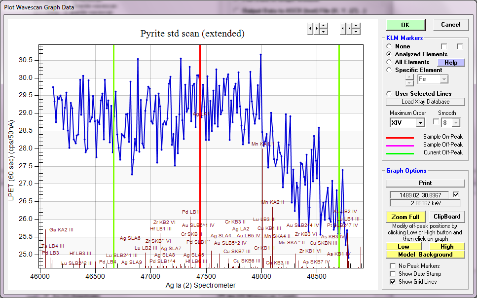

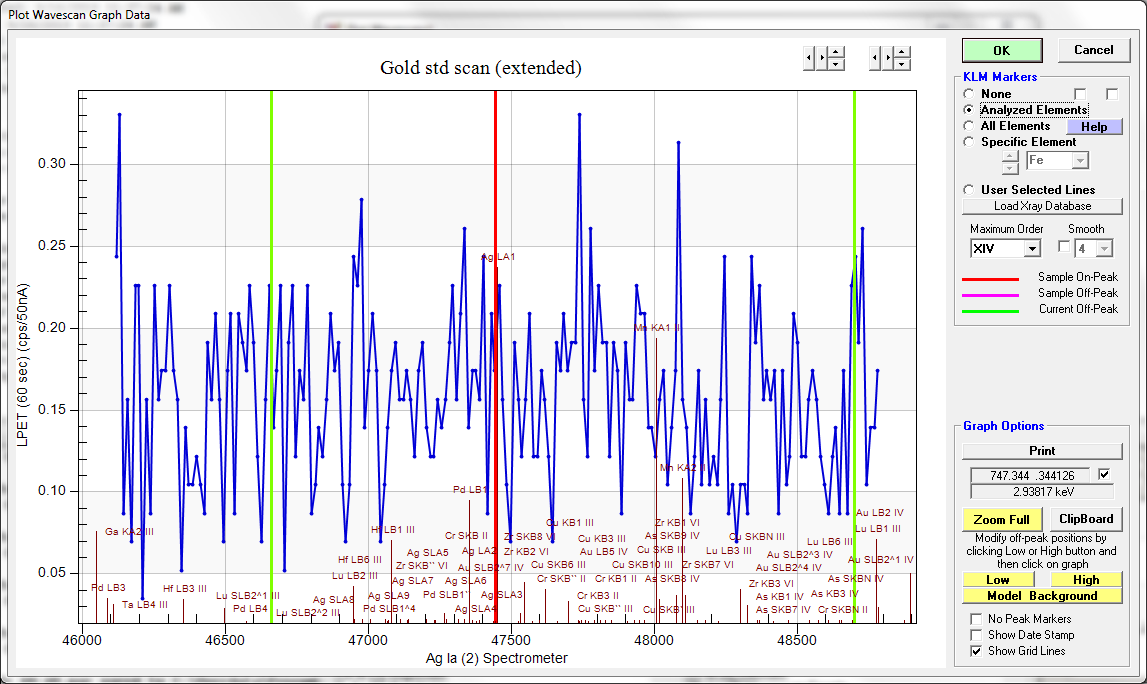

Here's a scan on my gold standard as you suggested:
Same conditions, but nada on the "hump".  Compare this to the 2nd scan in this above post:
https://smf.probesoftware.com/index.php?topic=928.msg8730#msg8730
Here is a scan from last night on my pyrite std:
This "hump" artifact on the Cameca definitely seems correlated to Fe concentration (compare with above Ag La scans on ilmenite and Fe metal). The good news is that it's only a few hundred PPM in magnitude and I can utilize the interference correction to remove this artifact (even though I don't quite see how it could be related to Fe emissions as even plotting up 20th order reflections shows nothing with KLM markers).  Possibly a secondary Bragg diffraction from the PET lattice?

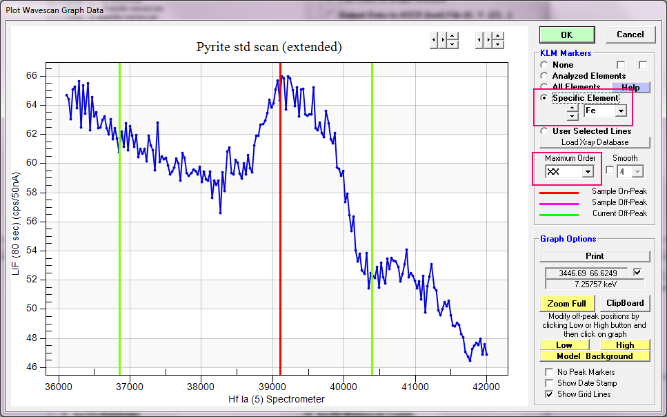

Though a possibly related spectral artifact on LiF near the Hf La peak position (as posted above) is a bit larger, around 2800 PPM in pure Fe.  Here it is from the pyrite scan from last night:
You can imagine my customer's excitement when he initially thought there might be several thousand PPM of Hf in there ilmenites, only to have it disappear after I also noticed Hf in my Fe std and I applied an interference correction.

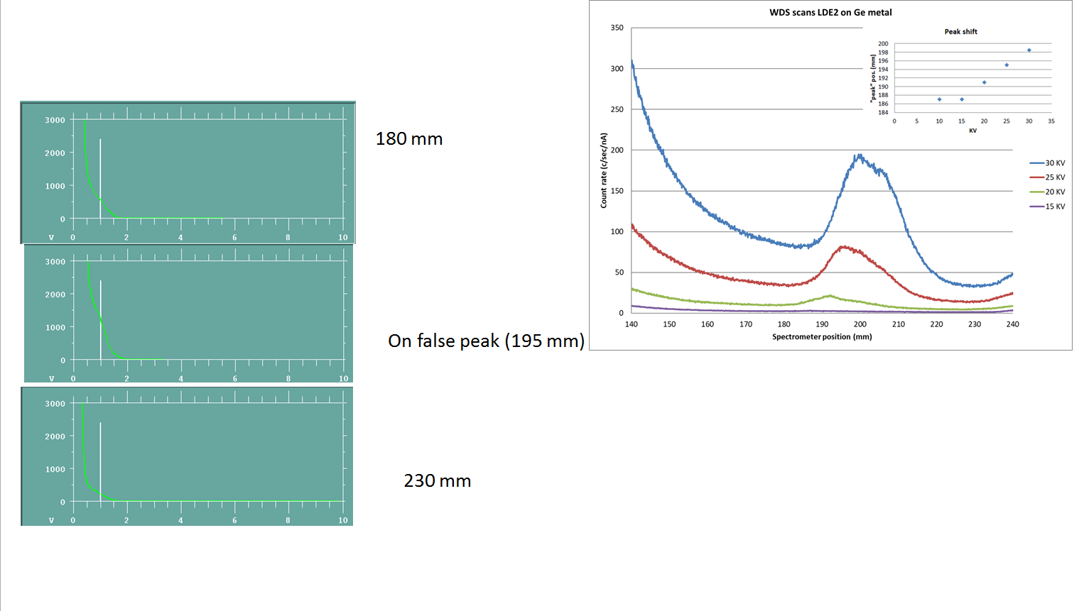

So Ben Hanson (Corning) reported to me that he sees something on his JEOL instrument that might be related. He says:
QuoteI saw something similar while doing boron.  I couldn't figure it out for the life of me until I did some SCA scans.  It seems the low-energy noise tail moved across my baseline at the "peak" position, but not at the positions just away from the "peak".  I couldn't fathom this and thought that I must be dreaming.  WTF could affect the low end noise by simply moving the spectrometer?  I don't know.  May be worth a check?  I know that I'm insane but I did check this a bunch of times.
Here is a slide he sent me:
I'm wondering if this is related to the stray electrons Anette mentions.  He suggests running a PHA scan at different wavelengths.

So on the JEOL probes the "hump" (a wide, asymmetrical peak) was caused apparently by some BSE striking the detector (bypassing the monochromator crystal). Only visible on the P10 counters. Assumedly the thick Xe counter entrance window absorbs these. Presumably they were high energy BSEs as they made it through the P10 counter thin window and the intensity could be reduced with differential PHA, whereas changing the baseline had no effect. It got worse the higher Z the material (e.g. gold) and the higher the accelerating voltage.
JEOL re-designed shields in the spectrometer so we don't see this hump anymore. On our machine we had these at around 155 mm L value in the vicinity of Rh La on PET. You can use your tool to convert to Cameca units :-)
Here is an old wavescan at 30 kV showing this hump (and a few other things like some small characteristic peaks and the Ar K edge):
But on the Cameca the WDS are separated from the chamber with only the small "separation window" for the x-rays to pass through, so I don't see how your artefact can be the same thing. I assume your scans are from a high pressure P10 counter, so it's not very likely any BSEs make it through that thick separation window? I don't think it is the same thing as it appears related to the sample material which ours isn't.

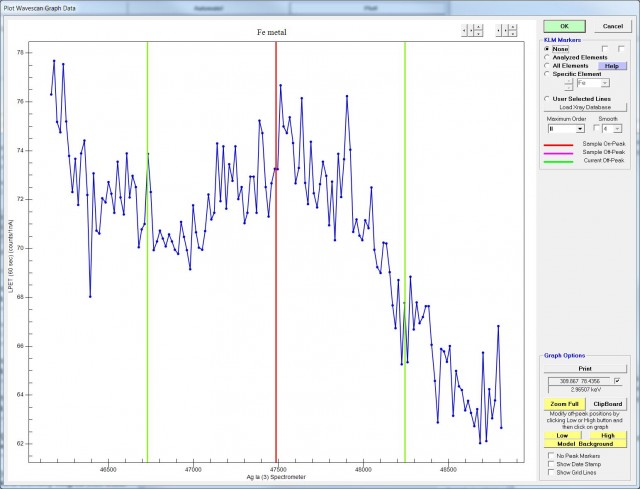

Would you be willing to run a high sensitivity scan on your PET on the JEOL around the region of Ag La? That would be ~133 mm on your JEOL instrument? Please do the scan on an Fe metal or other Fe bearing standard.
