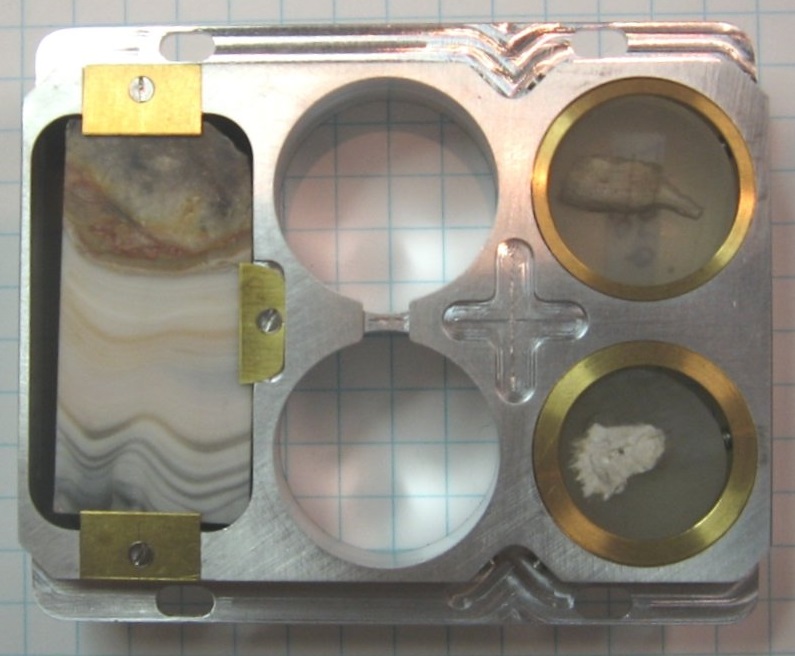

I wanted to share some photos of a special sample holder that our machine shop made for us in case anyone else runs into a similar situation.

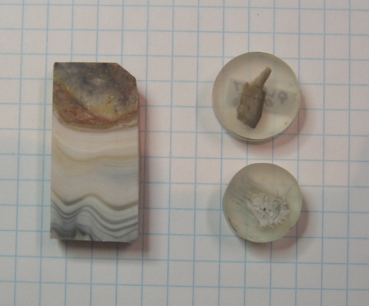

The basic problem is that a scientist from PNNL had a thick rock chip sample that cannot be modified as they want us to also do EPMA on a traverse previously analyzed using SIMS.  Also they had some non standard round mounts that were smaller than 25mm.
Here is what the samples looked like:
Note that the rock chip is very thick, approx 10 mm and needs to be top referenced on the Cameca because of the limited Z range.  Also the round mounts are very unround!
So our amazing machine shop made this holder for the thick rock chip and some adapters for the round mount:
Here's what they look like all mounted up:
Nice!

I'm interested.  Can you make a rough sketch of what you are thinking of?  I assume you are looking for a sort of adjustable bottom plate that pushes a flat sample up against the reference surface?   Maybe better to describe the shapes of samples you want to hold at a specific Z height?
The brass tabs on the holder we made could be swapped out for differently sized ones...

By "as shown below" do you mean like the picture here:
But instead of a rectangular rock chip, have it hold a rectangular petrographic slide?   Are you asking if our machine shop can make one for you?

         Yes I am currently trying to source a holder as per your image, to hold 4 x 25mm blocks and a petrographic slide. A metal plate held by grub screws to go up against the bottom of the slide would probably be the simplest fixing scheme. We currently have 3 SEMs (two Zeiss instruments and a new JEOL IT500). These instruments have a cameca holder adapted to take any of the cameca sample holders. I would like this holder so that I can have two standard blocks installed (Astimex) with the option of adding 2 x 25mm samples and  / or a petrographic slide. The really nice thing about the cameca holders is that they are top referencing which means that moving around the sample in the SEM requires little change in Z, which is safer for the chamber furniture when students and staff are using the instruments.This also means that samples can be swopped into any of our instruments. I am currently upgrading our Oxford EDX detectors to the AZTEC software along with our suite of off-line processing PCs and have also upgraded the Cameca SX100 to Peaksite 6.2. So things here are about to get manic. I also have an adapter so that our new JEOL 5830 plus microprobe can use our cameca standards and samples. If you could give me a quotation for your machine shop to make one for me that would be good.

Our machine shop says they'll make you one for US $380.
Such a deal.
