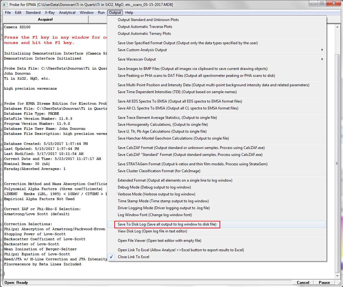

If you are asking about the "Save To Disk Log" menu as shown here:

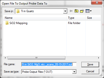

This menu allows the user to record all information logged to the main PFE log window, to a disk file with the extension .out.  The default .out file is the name of the current probe data file. This file is created whenever this menu is selected and is only appended to within the current probe run. It is saved to the folder selected by the user when you are prompted for the file name as seen here:
