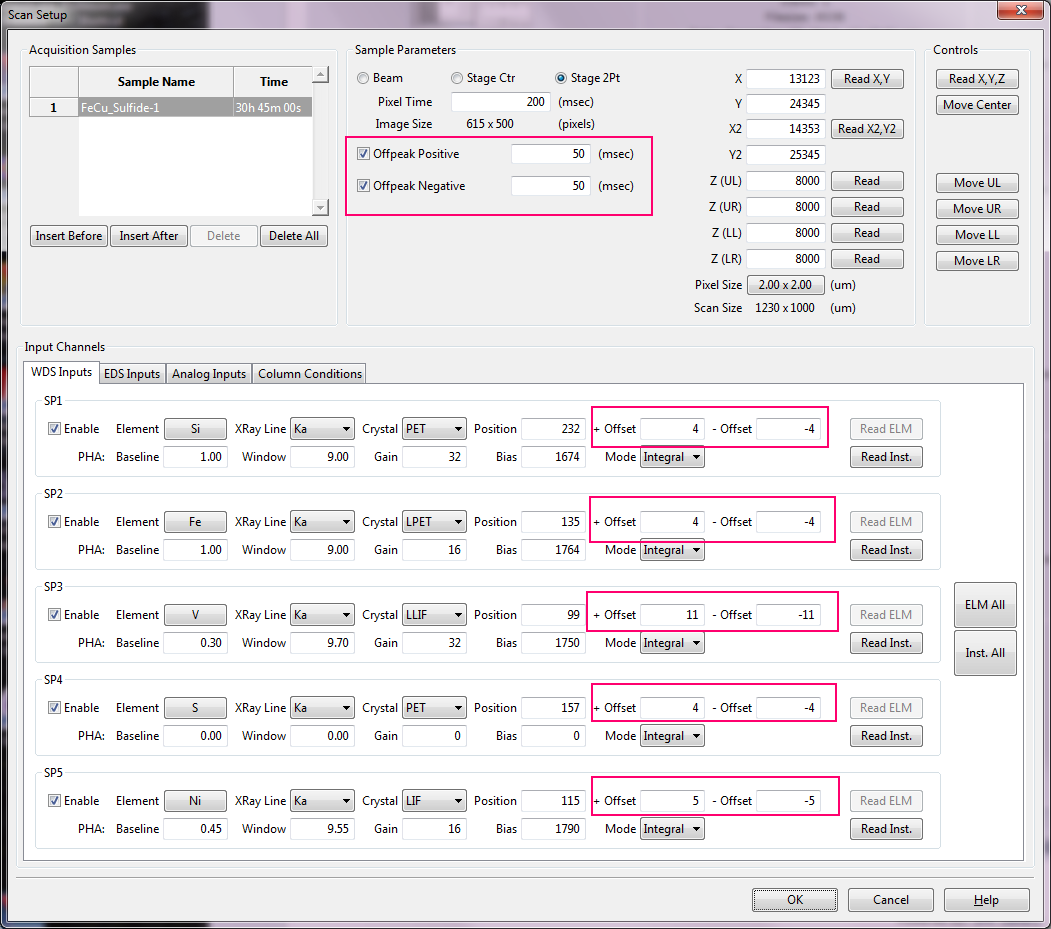

So my question is: if one acquires an off-peak map in PeakSight will the "Position" in the "Analysis Parameters" section be different from the position in the "Peak Position" line?
I ask because in Probe Image one can acquire no off-peak maps (and utilize the MAN correction), or one can acquire only high side maps (high only off-peak correction), or one can acquire only low side maps (low only off-peak correction), or one can acquire high *and* low side maps and utilize any of the off-peak interpolation methods (linear, exponential, etc.).  That is, how does PeakSight denote that the txt export x-ray map is on-peak or off-peak?

The mapping functions are in our Probe Image software. It utilizes the same firmware calls as PeakSight, but it does automatically handle acquisition of off-peak maps:
This is an example from a JEOL instrument, but the cool thing is that the software automatically acquires the off-peak maps specified (based on the off-peak positions from Probe for EPMA) after the on-peak acquisition. Of course most people nowadays just acquire on-peak maps and utilize our MAN correction which gives better sensitivity and in roughly half the acquisition time:
