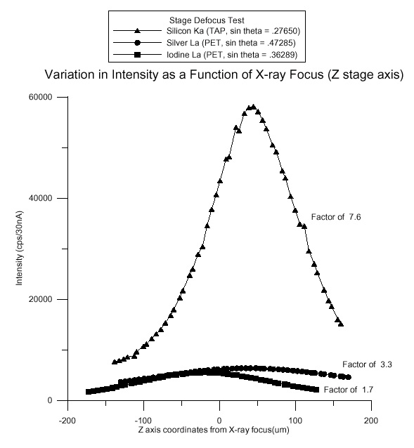

Hi Philipp,
I haven't performed such an "alignment" peak center for some time on my instrument (Cameca spectrometers are so stable!), so I would have to do some searching next time I'm in the office.   I think Paul Carpenter has also performed a number of these sorts of alignment peak centers on his JEOL instrument.
This isn't exactly the same thing, but it does show the intensity as a function of Z:
