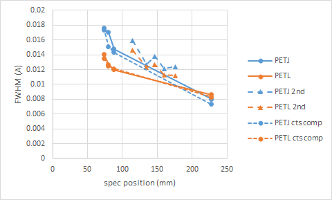

The reason I was asking is that I know I don't get good results using albite as the standard for a number of silicate elements (aluminosilicates, biotite etc), which I am sure is due to the peakshift (see attached images for my quick and dirty maxima values I measured on some of my silicates). Doing some back of the envelope calculations these shifts can affect the Si/Al values markedly, which is quite obvious in real data when you change standards around. As a result I have been switching standards to matrix match, which in effect I guess is like a "fudge" factor as that matrix matched standard would have its peak measured slightly "off peak" similar to your unknown.

If you repeak on each of the materials do you see a significant change intensity. How large a shift in intensity do these peak shifts equate to. Although it will depend on spectrometer resolution

I confess that it was very quick and dirty and only had the time to repeak and check on a couple of other minerals at the time. There was some movement in the peak maxima after repeaking again but only of a couple of units.
Just to take the extreme for Si, looking at my wavescans if measure at the albite Si maxima position in kyanite, my intensity is ~4.5% lower than it should be (275 CPS/nA vs 288 CPS/nA). This is almost exactly what I see in spot data if I use albite as the Si standard for kyanite (I get 16.55wt% Si when it should be 17.33wt%).
I guess this is the extreme though. Was curious as to how people were dealing with it.
