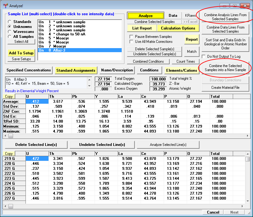

* Delete line does not work when showing "combine analysis lines from selected samples". Is that correct? Would it be possible to delete lines also when viewing combined analysis lines?
That's right, because the "combined sample" is not actually stored in your probe data file and is only present as a "view".  If you want to permanently delete some lines from a number of samples that you will be subsequently "combining", just delete the corresponding lines in each of the samples that will be "combined".
Or... even easier, just use the "Combine Selected Samples into a New Sample" button to create a new samples from the selected samples. This means that you now have a new permanent sample from the selected samples that you can apply all data processing options to. For example, deleting and undeleting analysis lines as seen here:

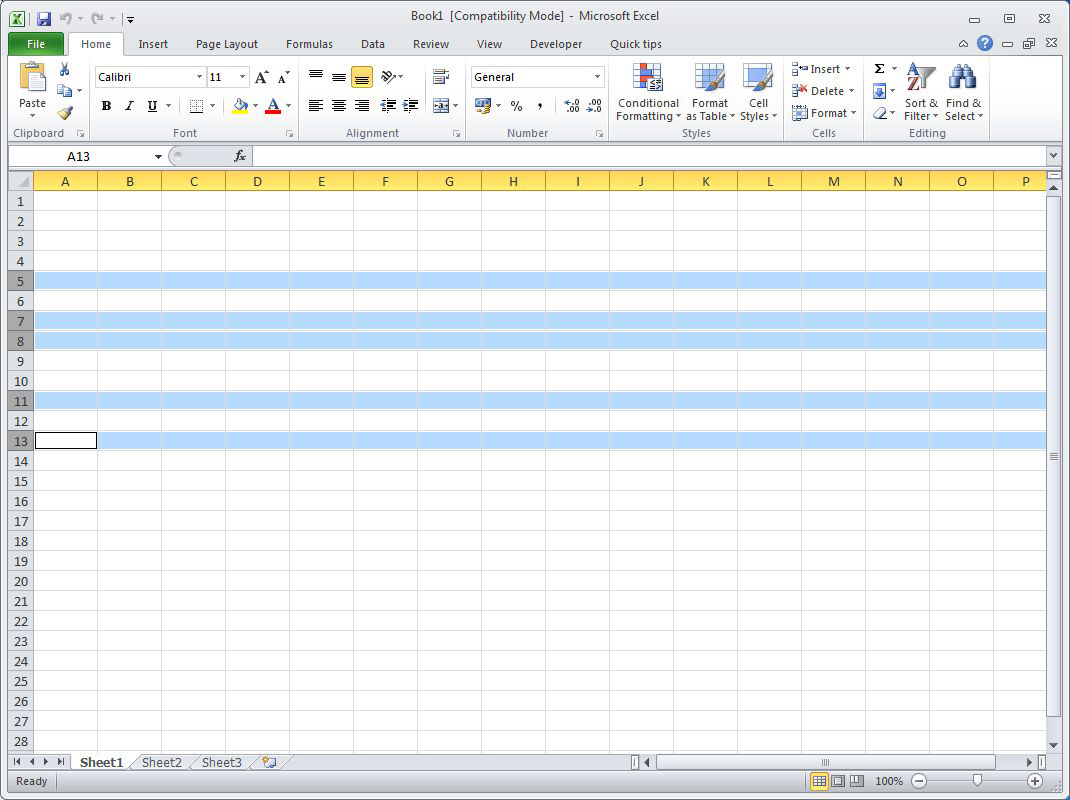

Hm, I am not sure what you mean. If I go to excel, I can use the control key to select as many indivitual lines as I like.
Would there be a way to include this into the analyze window?

Hm, I am not sure what you mean. If I go to excel, I can use the control key to select as many indivitual lines as I like. Would there be a way to include this into the analyze window?
Ha, I did not know that about Excel, unfortunately the spreadsheet control my app uses is not that sophisticated.  You will have to use the Analyze Selected button more than once, or (and maybe this is the best answer) just delete all the points you *don't* want to analyze, and then just use the regular Analyze button to analyze them.  You can always undelete those points later if you want. What I'm saying is that if your goal is to get the average of points only with totals over a certain number this method will propagate through the program.  In other words, once you delete lines with low totals, PFE will ignore all these deleted lines for output or plotting.

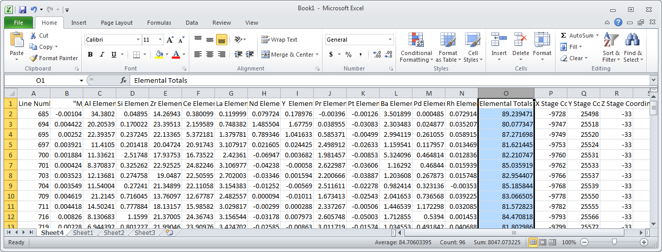

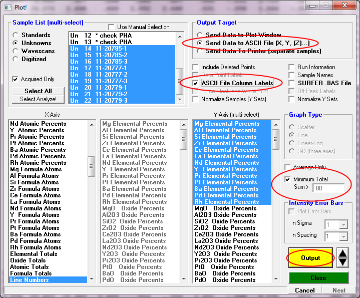

I have modified the Plot! window output to offer the option to export to Excel based on the Minimum Total value. So just select your samples as shown here, select the Send Data To ASCII File option, and enter the Minimum Total (e.g., 80%) and then click Output. The program will calculate all, but only output the ones that have a minimum total as specified.
Then PFE will ask if you want to export to Excel and you will get output that has all the low totals eliminated as seen here:
Will that work for you?  I will upload this modification tonight so you can download it tomorrow.

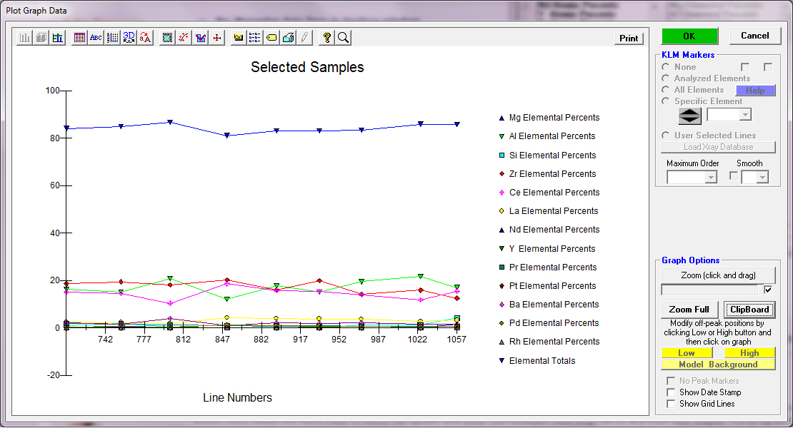

The program now handles using both the average only and minimum total options together on multiple samples. Here's the plot output from a bunch of samples (average only) and an 80% minimum total:
But do also consider using the Send Data To ASCII File option in the Plot! window as that also allows one to import the same data into Excel with a mouse click.

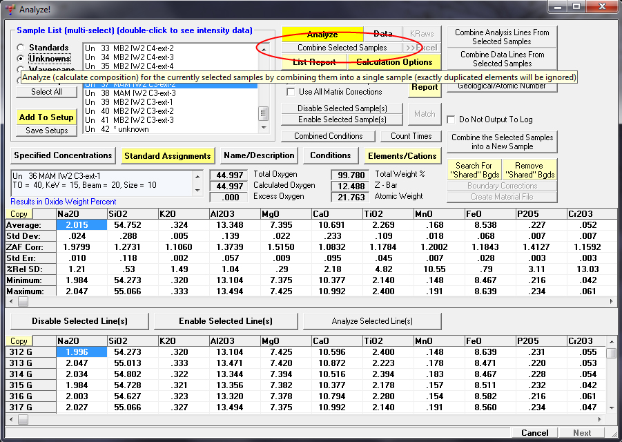

I wonder if it makes any sense to "combine" EDS spectra when combining WDS elements from multiple samples in the Analyze! window when using the Combine Selected Samples button as seen here:
I'm thinking this might be worthwhile to do (not too hard to code) and besides it will improve precision for the EDS elements.  Of course this improvement in precision is slightly different from the improvement in precision from increasing the geometric efficiency as is the case with the "aggregate intensity" feature, where the same WDS element is measured on more then one spectrometer as discussed here:
http://smf.probesoftware.com/index.php?topic=155.msg646#msg646
Instead this improvement in EDS precision from the "combine samples" button is essentially from increasing the count time time (2x, 3x, etc) by combining EDS spectra from multiple samples...  so I will need to normalize the EDS spectra intensities properly depending on the total "combined" EDS acquisition time.
