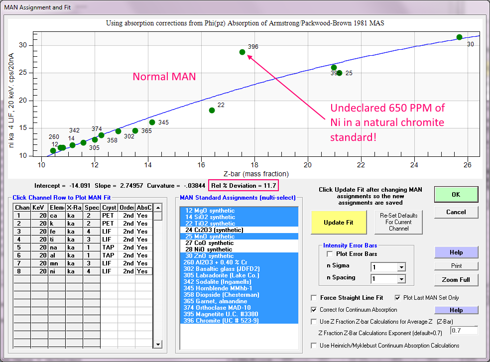

It turned out that several of Ben's standards had trace amounts of elements that weren't declared in the standard composition database, so of course they showed up as high intensity outliers in the MAN plots.  The same thing can occur when the on-peak position is interfered with as seen here:
https://smf.probesoftware.com/index.php?topic=4.msg5136#msg5136
So basically the idea was to utilize standards that might have undeclared contaminations and/or on-peak interferences that need to be avoided, and by using this "interpolated" off-peak MAN feature we could do just that.  And for these situations it works great.

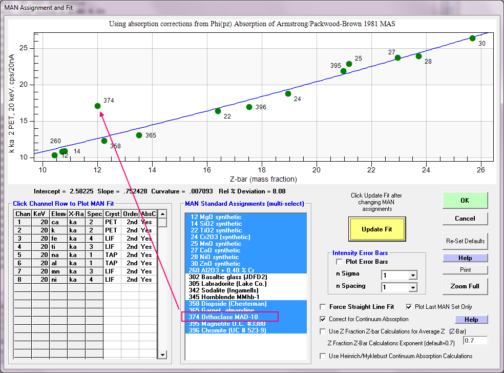

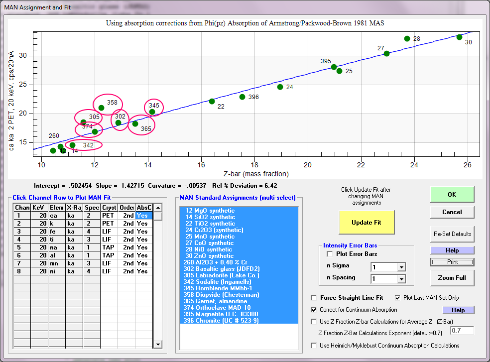

So backing up a bit, when I first tried checking this new flag on some off-peak measured standards, then checked the Use Off-Peak Elements For MAN Fits menu, selected Clear All MAN Assignments, and opened the Assign MAN Fits dialog, I didn't know what I expected to see, but here is the first MAN fit that displayed which is the Ca Ka MAN fit:
Well heck, it's not a great fit but considering that all the circled standards contain at least some Ca, it did a pretty good job. I learn something new every day, thanks to sharp, young guys like you!
Now one could argue that some of those high outliers are a little too much outside of statistics (I should have turned on the error bars option when I captured this image!), but let's not worry about it and go to another emission line, this time K Ka and this time there's definitely a high intensity outlier for the orthoclase standard, which of course contains 15 wt% K:
Now what could be causing this?  Well there are at least two things I can think of that would cause a high outlier for off-peak measurements. First, the absorption edge effect. That is, if one of the off-peak backgrounds is on the other side of an absorption edge it might cause an under estimate or an over estimate of the continuum intensity under the peak, depending on which side of the absorption edge, the emission line of interest is on.  The other reason for a high outlier is that the background is curved and we had utilized a linear fit between the off-peaks. Of course then there is the situation that if our off-peak measurement positions are on the tails of the peak (and a major peak from the element is present), we will again also be over estimating the intensity of the continuum intensity under the emission line of interest. Oh yeah, also if there is an off-peak interference, we will over estimate the on-peak continuum using off-peak measurements whether they are applied in the off-peak correction normally, or in the MAN fit as we are doing here.
All good reasons to avoid off-peak backgrounds!    ;D

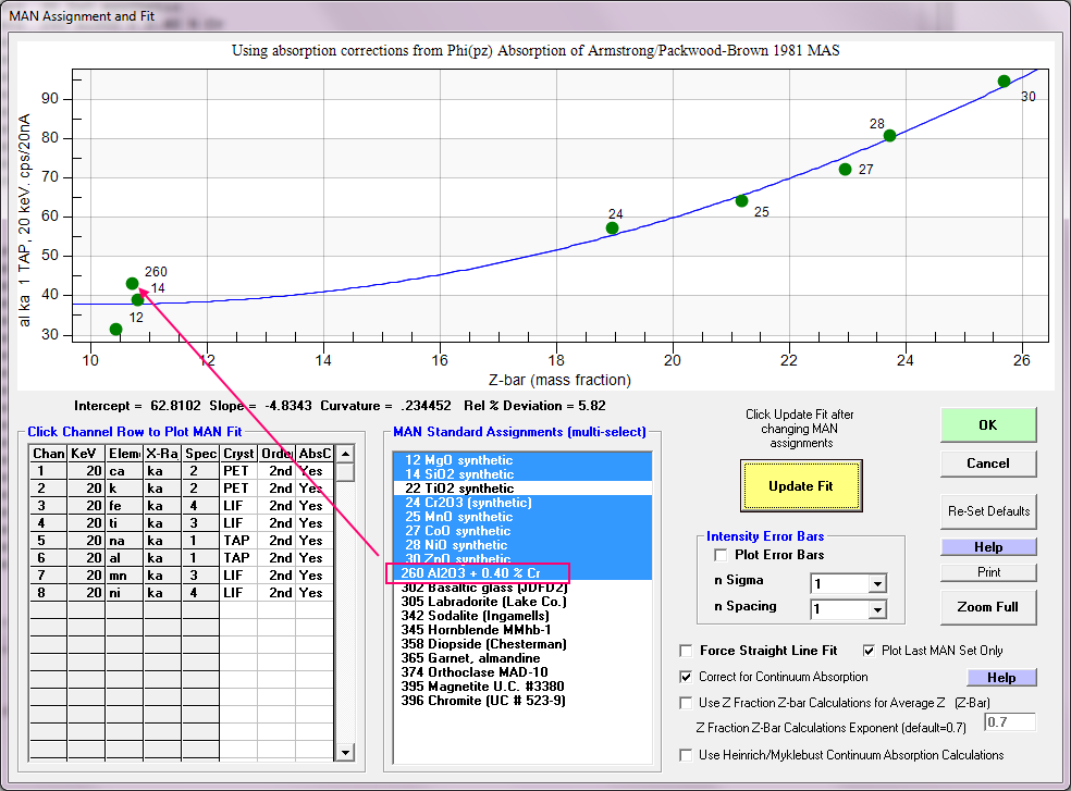

And just to demonstrate that even in the case of a large concentration of the element of interest being present, there's sometimes no significant observable off-peak accuracy effects:
This standard 260 is pure synthetic Al2O3 measured at the Al Ka peak position. And while probeman did select the off-peak background positions carefully, it is still pretty good considering the intensity of the Al ka peak.  At least the background in this vicinity is not curved as it is in SiO2!
So please update your PFE and try it out. One helpful hint, you can "use" your MAN intensities from older probe runs by creating a new MDB file, then making a new sample, clicking the Load File Setup button and saying "Yes" to load standard intensities. It won't import your unknowns, but it will allow to to try out this new feature on some existing standard data.

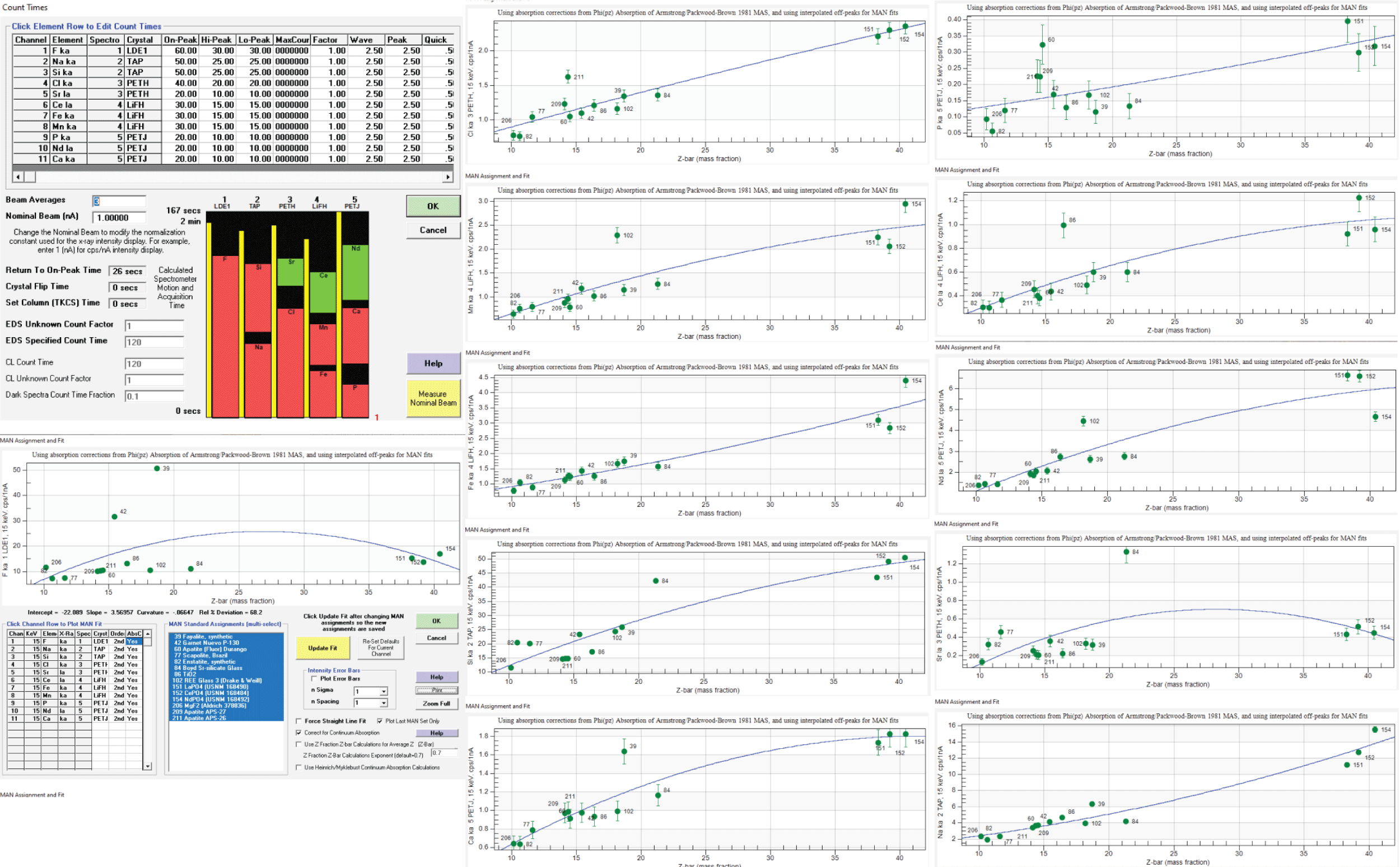

Ok, so I didn't want to leave everyone thinking that the use of these (interpolated) off-peak measurements for use in the MAN fits is not entirely worthwhile.
It's just that using off-peak intensities for the background correction (whether they are utilized in normal off-peak background corrections or in MAN background corrections), is fraught with a number of issues because, they *are* interpolations. With off-peak background methods, we are *not* measuring the background intensity *at* the actual emission line position, we are interpolating to it.
For one thing these off-peak (interpolated) MAN fits are worthwhile if one doesn't have a nice set of pure simple synthetic oxides. Which is the situation that Phil Orlandini in Austin is in (Phil: please show us some of your interpolated off-peak MAN fits when you get some!). Probeman in Oregon is lucky because he managed to obtain a number of pure synthetic oxides, specifically MgO, Al2O3, SiO2, TiO2, MnO and NiO early in his career and has added these simple oxides to all his standard mounts.
Of course one can also utilize pure metals, but for background correction of common oxides and silicates their average Z values will be roughly between 10 and 18 (SiO2 and Fe2SiO4). So while one can utilize Si metal, and maybe Ti, etc on up for one's MAN calibrations, the Z of Si starts at 14, so not ideal for the lower average Z silicates such as forsterite (Mg2SiO4).
That said, there is one other really nice use for these off-peak (interpolated) MAN fits and that is when one has undeclared concentrations of elements in ones (usually natural) standard materials (as was the case for Ben Hanson at Corning). Let's examine the case here which is a normal (on-peak) MAN fit for Ni Ka showing that the natural chromite standard has an undeclared trace concentration of around 600 to 700 PPM of Ni:
Now, of course we can simply remove that standard from the fit as is usually done as seen here:
But of course now we can also utilize the (interpolated) off-peak MAN fit as seen here:
Note that the above plot also documents the use of the (interpolated) off-peak MAN fit.  The idea with all this stuff being that we can acquire our standards using off-peak measurements, use these off-peak standards to fit our MAN curves as described here:
https://smf.probesoftware.com/index.php?topic=987.msg8889#msg8889
and in other posts in this topic, and then utilize MAN acquisitions on our unknown samples to save time and improve precision for point analyses and quantitative x-ray maps. And depending on the samples, maybe even improve the accuracy of our unknowns by avoiding possible off-peak interferences.   8)

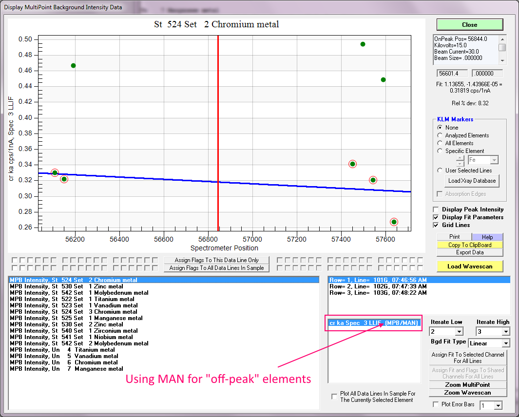

I hadn't considered this option before, but I thought, well why not?  After we examined the code, it appeared to us that this might already be taken into account since an MPB measurement is really just multiple off-peak measurements! So I ran a quick and dirty simulation in Probe for EPMA, acquiring an element using the MPB method on a number of standards, as seen here for Cr Ka in chromium metal:

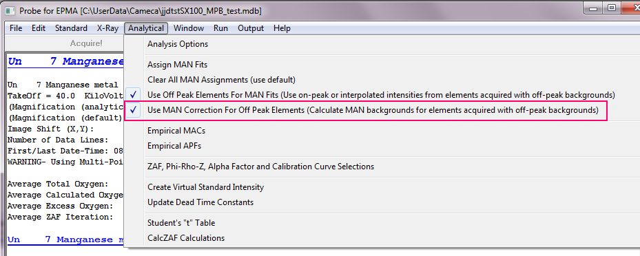

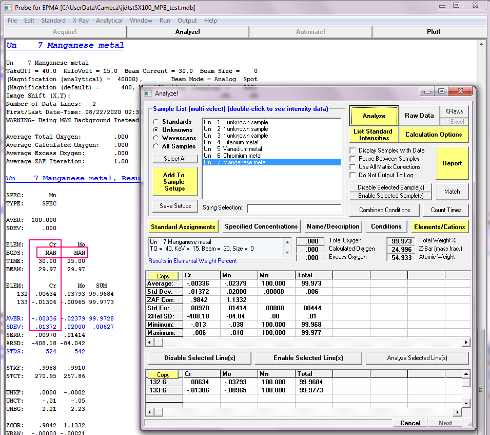

I then checked the menu shown here to enable the program to search for MAN standards even if they were acquired using off-peak (or MPB) methods:

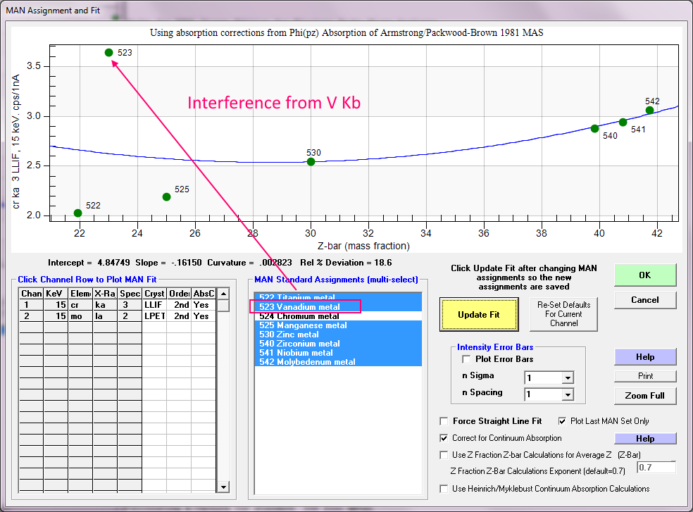

Then after opening up the Assign MAN Fits menu dialog we see the following results for Cr Ka:
Oh, right, the chromium peak is slightly interfered by the V Kb line in the vanadium metal standard, even in simulation mode! But after deselecting the vanadium standard we update the fit and now obtain a much better MAN calibration curve for Cr Ka:

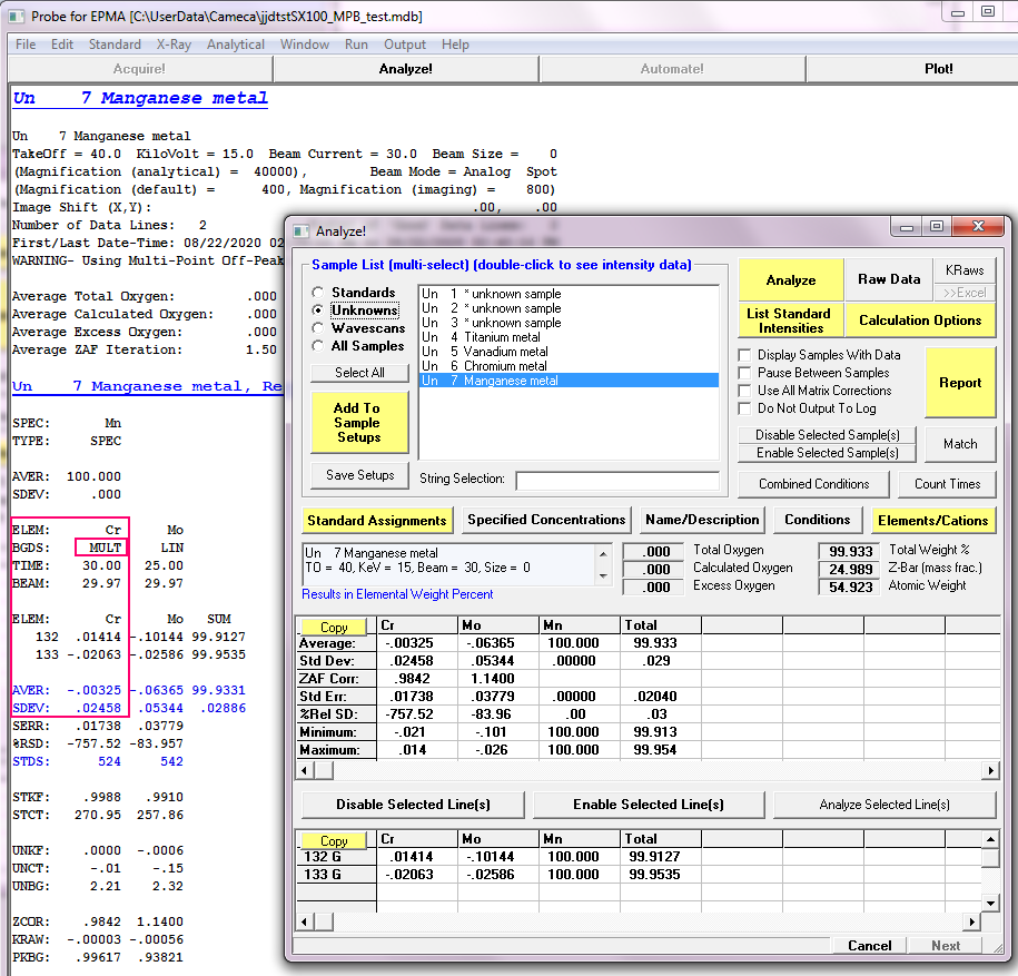

So we now go to the Analyze window and analyze one of our standards (just for fun!) and obtain the following results:
Note that Cr is acquired (and still quantified) using the MPB method, while Mo is acquired (and quantified) using the traditional off-peak (linear fit) method. Next we go back to the Analysis Options menu and check the menu for analyzing off-peak elements as though they were acquired using the MAN method as seen here:
Now there was one tiny change we did have to make to the code which was a labeling issue when this Use MAN Correction for Off-peak Elements menu is utilized and one opens the Display Multi-Point Backgrounds dialog from the Run menu as seen here:
Because previously, it would indicate that the element was acquired as a "shared" MPB. Which is (yet!) another option for using multiple off-peak elements on the same spectrometer and Bragg crystal to create a pseudo MPB sample as described here:
https://smf.probesoftware.com/index.php?topic=9.msg9043#msg9043
Anywho, now we go again to the Analyze window and analyze our standard again, and now the results are based on the MAN calibration curves which utilized interpolated off-peak measurements (MPB for Cr and traditional off-peak for Mo):
OK, now data 2 points isn't enough to draw any conclusions with, but it is interesting that the variances for both Cr and Mo are smaller when utilizing the MAN method (as one would expect)!
