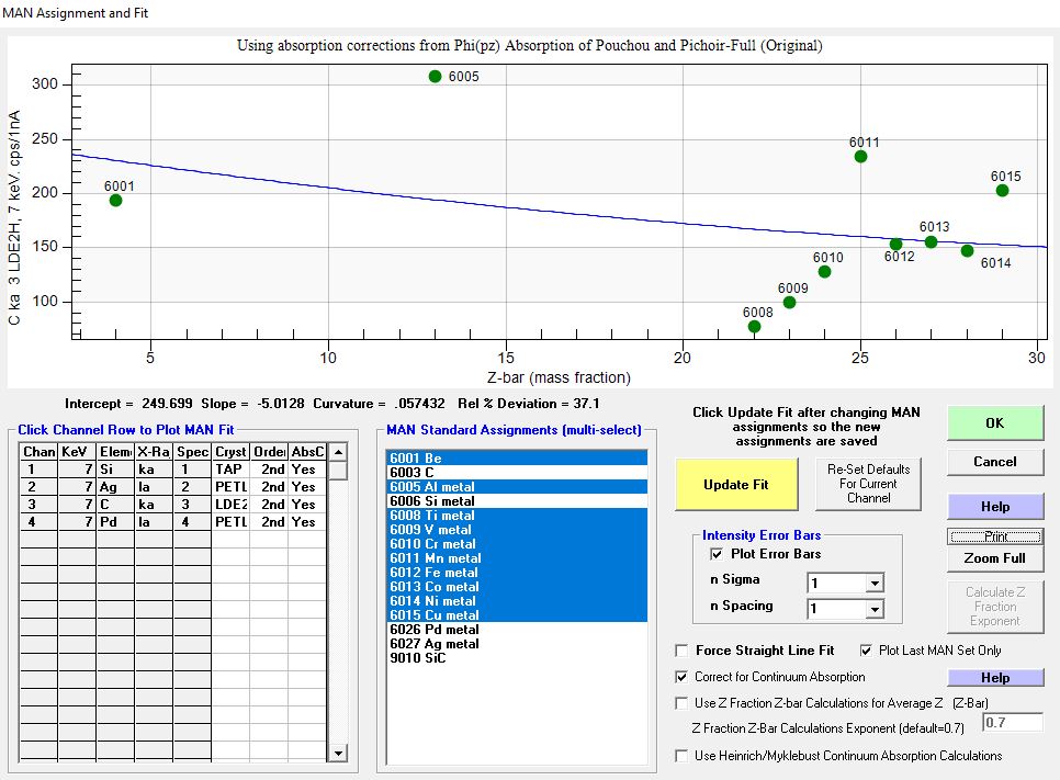

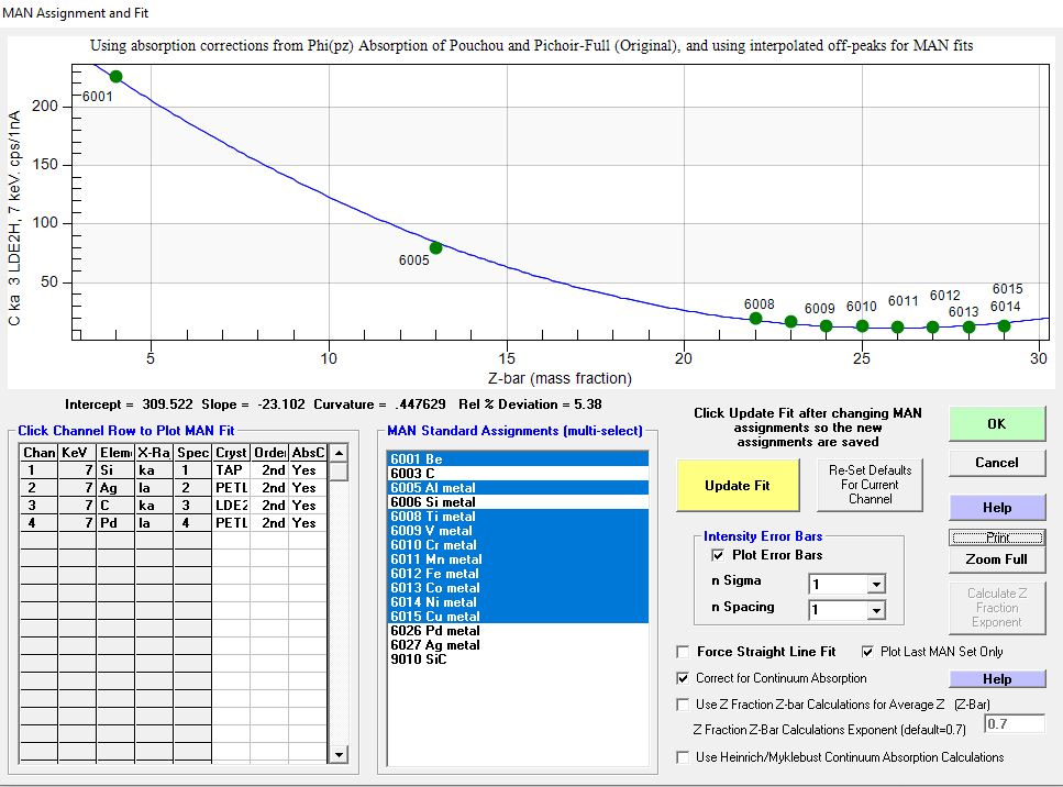

Brilliant, cheers John. That fix seems to work beautifully. Below is a before/after for the C Ka energy using the on peak C Ka and the MPB interpolated off peak from a larger range of standards.
Before (on peak C Ka)
After (MPB interpolated)
This is going to help a lot with light element mapping! It'll certainly help with oxygen, as that's even more a pain to get around.

That is cool, but the Be and Al intensities bother me.  Continuum intensity should be proportional to average atomic number.  That is, the intensities should be lowest at the lowest atomic numbers.
If this is real then there could be some interesting physics going on (absorption correction?), but it's probably just some sort of artifact.  Please share some plots with us showing intensities with and without the absorption correction.  Or with different absorption corrections.
