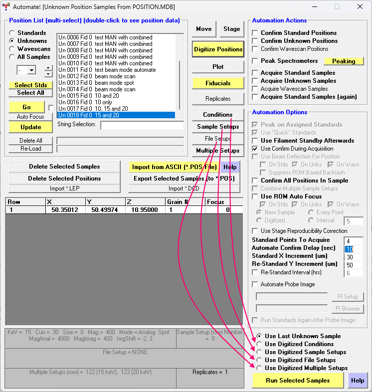

I think I know what the problem is but let me first illustrate an example of using different numbers of sample setups for different position samples in Probe for EPMA from the Automate! window.

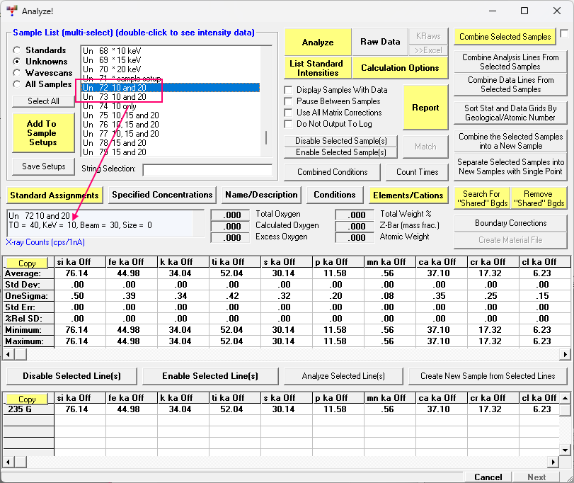

One first starts (as you did) by creating the several sample setups they want to automate from the Acquire! window. These samples setups could be different sets of elements (minerals, glasses, etc.) with different backgrounds, interference assignments, etc.:
https://smf.probesoftware.com/index.php?topic=1559.msg13587#msg13587
Or for automated acquisition of multiple keV samples for thin film characterization:
https://smf.probesoftware.com/index.php?topic=111.0
Then once all your various sample setups are properly configured, save them from the Analyze! window as shown here:
https://smf.probesoftware.com/index.php?topic=531.msg12600#msg12600

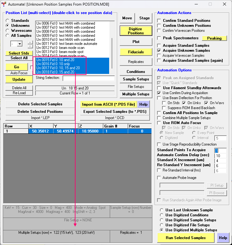

Finally you assign your multiple sample setups (one or more) to your digitized position samples from the Automate! window as shown here:
Note that some position samples only have one sample setup, others have two or even three. Each position sample can have different numbers of (one or more) sample setups.
In the above example, I acquired different numbers of setups using different keV conditions, 10, 15 and 20 keVs and assigned them to the position samples as named. The results after automation are here, as seen in the Analyze! window:
Note that some samples were acquired with two sample setups, others with more or less numbers of sample setups.
Now here's where you might have gone wrong. If you have different sample setups per position sample, you'll want to run them using the default option with the Run Multiple Sample Setups option UNchecked:

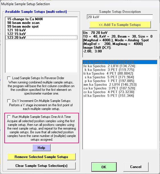

That is, only check the Run Multiple Sample Setups One at a Time checkbox if you want to run the first sample setup for all samples, then the second sample setup for all samples, etc.  If you check the Run MUltiple Setups One at a Time checkbox, all selected samples have to have the SAME number of setups assigned! This feature is especially useful for running the Constant K-Ratio dead time calibration discussed here:
https://smf.probesoftware.com/index.php?topic=1466.msg11102#msg11102
where one wants to run all samples at say 10 nA, then all samples at 20 nA, then all samples at 50 nA, etc., etc. Hoping this helps and let me know if you have further questions.

That's not the way to think about the automation in PFE.
Basically you use either the current unknown as the sample basis or the digitized conditions, sample setups, file setups or multiple setups as shown here:
Remember, one can have a single sample setup assigned when using the Multiple Sample Setups mode, or more than one, so this mode should work for you I think.
What both of the sample setup and multiple sample setup methods will do is check that you have at least one sample setup assigned to all selected position samples, when you start the automation.
Quote from: KerstinGruender on November 26, 2025, 08:23:16 PMI do think I'd want the Run Multiple Sample Setups One at a Time checkbox ticked for it to not switch beam current conditions at every position sample (with multiple setups, 8nA and 60nA current) in order to run them all at one current first, then move back to the same positions and run the second setup? It would skip the position samples where there is no second sample setup assigned? Sounds like this will pop up an error though if it absolutely expects the same amount of setups for every position. I'll try this out next week!
No. When the Run Multiple Sample Setups One at a Time checkbox is checked it basically runs the sample setups in a loop.  So the number of sample setups assigned to each position sample needs to be the same.
But these sample setups can be in any order. For example, the first position sample could have a 10 keV and 15 keV setups assigned, and the next position sample could have a 12 and 20 keV setups assigned. If the Run Multiple Setups One at a Time checkbox is checked, it will run these position samples like this:
First position sample, at 10 keV
Second position sample, at 12 keV
First position sample, at 15 keV
Second position sample, at 20keV
