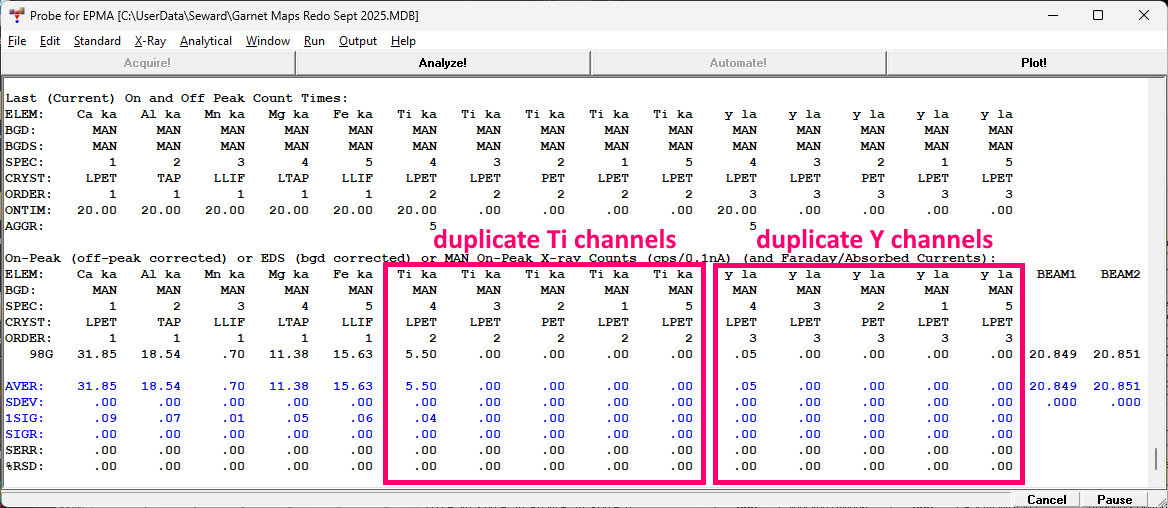

First note that we are acquiring Ga La on two spectrometers and Ga Ka on one spectrometer, plus As, In and Sb. GaSb is the primary standard for Sb and GaAs is the primary standard for Ga.
Next we note that the analysis is crazy.  The total is over 150% and we have three times as much Ga as we should... we makes sense because we are measuring Ga on three spectrometers!  So let's begin by turning on the "aggregate" mode in the Analytical | Analysis Options dialog as seen here:

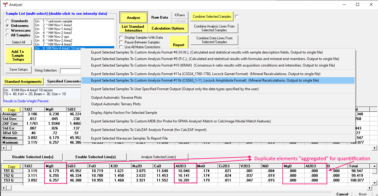

This is a little better because the two Ga La channels have been "aggregated" as we specified, but we still have duplicate Ga La and Ga Ka.  What we need to do here is to "turn off" either the 2 Ga La channels or the single Ga Ka channel using the "Disable Quant" feature.
Since the Ga La channels are being "aggregated" it is critically important to use the "Disable Quant" feature on *both* the standards *and* the unknowns.  Since this is a secondary standard for Ga, we would want to apply the "Disable Quant" flags to both the primary GaAs standard and the GaSb secondary standard.
Or we could just set the "Disable Quant" flag for *only* the Ga Ka channel in this standard sample as seen here:
since it is not duplicated as far as the "aggregate" mode is concerned.
Now, when we again click the Analyze button in the Analyze! window we obtain these reults:

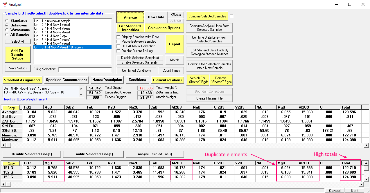

Here's an important tip on using the aggregate mode with duplicate elements:
The duplicate elements on your spectrometer/crystals that are aggregated for your unknowns, must match the duplicate elements on your spectrometer/crystals that are aggregated for your standards.
Why?  Because the intensities from each duplicate elements are summed for both the standards and the unknowns.  If they don't have the same geometry efficiency (intensity/area) then when the k-ratio is formed, it will not be accurate.
It would be like standardizing on one crystal/spectrometer combination and using a different spectrometer/crystal combination for the unknowns.  I thought about adding code to check that the user does this properly, throughout a run that could be any combination of duplicate elements/spectometers/crystals, but my brain exploded...  so I decided to leave responsibility for this to you, kind users.

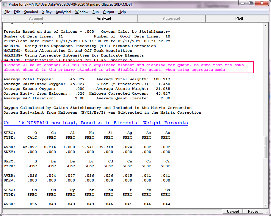

I recently had a colleague of ours contact me because they were analyzing a trace element on several spectrometers to improve their sensitivity. That is, by improving the "geometric efficiency" of the instrument by tuning up the trace element on several spectrometers. Here is an example (posted above) of analyzing some duplicate major elements, which shows the issue more clearly:
https://smf.probesoftware.com/index.php?topic=155.msg646#msg646
However in examining their trace element data, they found that they needed to "disable quant" on one of the spectrometers for an electronic/mechanical reason, but when they disabled the quantification for that element/spectrometer, the k-ratio was no longer correct.
I wanted to recall this topic to remind everyone that because Probe for EPMA aggregates the intensities for *both* the unknowns *and* the standard samples (both are necessary to construct the k-ratio!), both the unknowns and the standards need to be treated the same. So if one disables an element in the unknown sample, one should also disable the quantification for the same element in the standard sample.
Now maybe a really smart developer would find a way to warn the user that the element /spectrometer for a particular unknown is disabled, but that the same element/spectrometer for the corresponding standard is not disabled, but it gets complicated let me assure you!  But we are thinking about how such a warning in the code could be implemented!
So in the meantime, if you decide you want to disable quantification for a particular duplicate element in an unknown sample, be sure to also disable the quantification for that same duplicate element in the standard samples.

And now the average Cl is significantly lower. How is this possible?  The answer is that because one of the unknown elements was disabled for quant, but the same element channel in the standard was *not* disabled for quant, the k-ratio was improperly constructed.
The solution is to also disable the 5th element channel in the standard sample. Once we've done that, we get the following correct results:

My bad was that I did not have a warning about this possible situation, where once is acquiring duplicate elements, using "aggregate" mode to combine the intensities, but then disabling one of the duplicate elements channels.  This now fixed in the latest version of PFE as seen here:
Again, my apologies, and thank-you to Ben Wade for noticing this oversight and reporting it to me.  Update, as usual, from the PFE Help menu and you will now have this warning when it is appropriate.

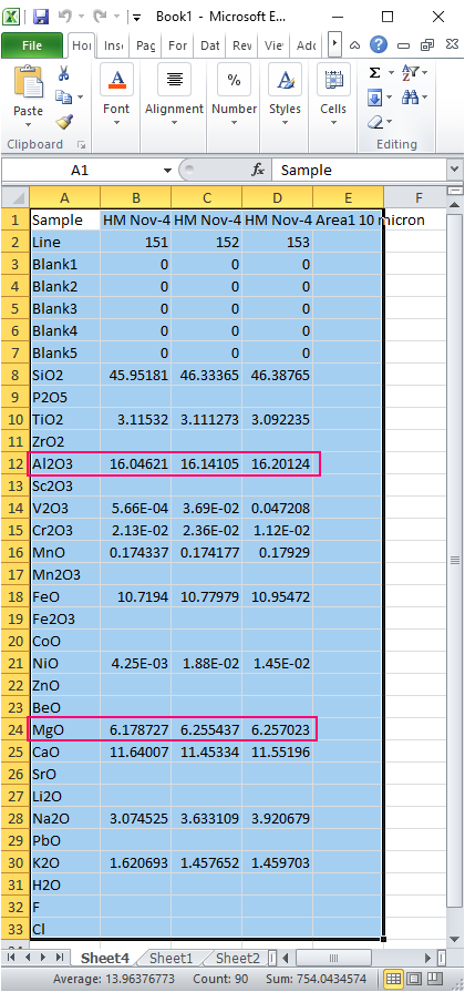

Here is an example that Andrew Locock sent me a few days ago where he acquire duplicate Al and Mg for an amphibole composition:
Note that because Al and Mg are major elements, the totals are too high and of course this affects the overall matrix correction adversely for all the elements. Note that if these duplicate elements were only present at trace levels, these adverse matrix effects would be minimal.
So, we now turn on the "aggregate" feature from the Analytical | Analytical Options menu as described earlier in this topic and now we get much more reasonable totals:
Note that the duplicate elements are now zero. This is because the intensities of these duplicate elements (from the unknowns *and* standards) has now been summed into the first instance of these elements.
Note also that I've highlighted the Locock amphibole export menu in the Analyze! window.  This is where Andrew found a problem because the amphibole export code was looking for each element and loading the results into the export format. But since the duplicate elements are after the first instance of the elements, these zero values from the duplicate elements were loaded into the exported file.
After a quick tweak of the code we now obtain the export output that we should expect:
This code modification fixes this export format for both the Locock amphibole export and the garnet export format.  Update as usual  from the Probe for EPMA Help menu to get this latest version.

Recently one of our colleagues had a small problem trying to use the duplicate element aggregate feature in Probe for EPMA where duplicated elements are aggregated to improve sensitivity (see above posts).
In his run he had this unknown sample containing all the elements which he had standardized on:
Note the order of the Ti (and Y) spectrometers: 4, 3, 2, 1, 5!
Actually this unknown sample was created after the standards were run, for use in quantifying some x-ray maps he had acquired also in Probe Image.
The problem was that he was able to quantify his point analyses and also his x-ray maps just fine when the aggregate mode option was unchecked. But he got a warning that the primary intensities for the Ti (and Y) had no standard intensities after he checked the Use Aggregate Mode in the Analytical | Analysis Options menu dialog.
He wrote me and then I noticed that his Ti standard he had this setup:
He had the Ti duplicate elements in his standard in a different spectrometer order: 1, 2, 3, 4, 5!
The thing is, when the duplicate elements in Probe for EPMA are aggregated, then are aggregated to the first duplicate elements channel, for the unknown sample that was spectrometer 4, but in the standard the first Ti channel was spectrometer 1!
Now one cool thing about Probe for EPMA for point analyses (and CalcImage for maps) is that the elements in the standards do not need to be in the same order as the unknowns (or maps). But when the duplicate elements are aggregated together, the spectrometer of the first duplicate elements does need to match, because PFE checks that the element, x-ray, keV (and takeoff angle), Bragg crystal and spectrometer all match for quantification!
Once they made a new sample and re-ordered the channels (using the Combined Conditions dialog), they were able to quant all their maps using the newly re-ordered sample setup in CalcImage.
We'd never run into this situation before, but OK, now you know!
