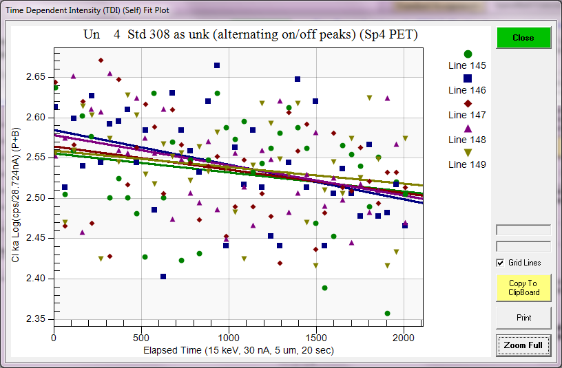

I figured out a way to utilize the existing TDI code for the alternating on/off intensity acquisition for correction of time dependent intensity changes as seen here (note the magnitude of the x axis):
You can assign these alternating on/off intensity corrections using the existing TDI corrections in the Standard Assignments dialog. This graph depicts a 3.1 % decrease in Cl ka intensity over the elapsed time.

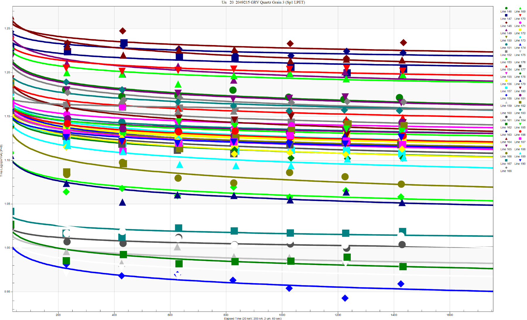

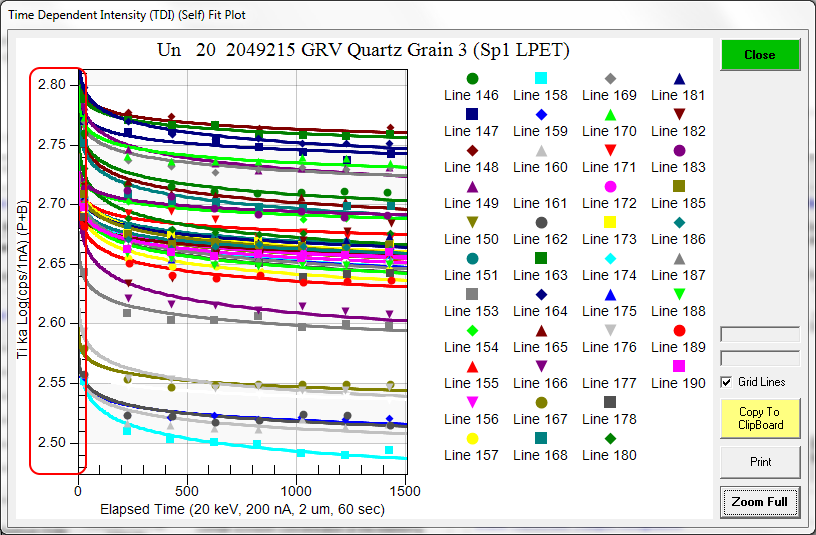

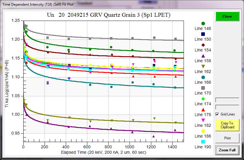

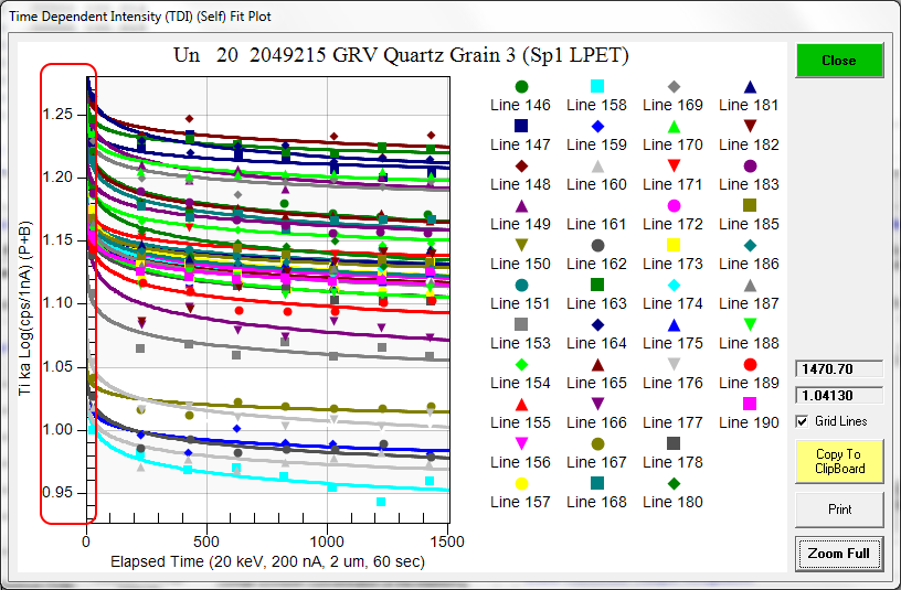

The reason it was a problem was because I've been thinking about how to implement an idea that Julien Allaz wrote to me a few months ago, but I hadn't been able to think of an elegant way to do it- until today!   (give John a "pat on the back")
The idea Julien had over the summer was that just as we "aggregate" the on-peak and off-peak intensities for better precision/sensitivity, we could also do the same for our (self) TDI correction for beam sensitive samples (and now also for alternating on/of-peak intensities).  The problem was, I couldn't think of a clever way to code it, but today I did and here is an example...
Here is one of Ben Wade's quartz samples measuring for Ti on all 5 spectrometers and using alternating on/off intensities to track the sample damage over time.  As with normal TDI, this allows us to also correct quantitatively for this change in intensity over time. So here are the data points using normal (unaggregated) intensities and fit to a log-log method:
A very busy plot but note the scatter in some of the data. Now the same TDI data but this time plotted with the aggregate mode turned on so all TDI intensities from all 5 spectrometers are combined prior to the actual TDI correction:
Obviously the (log) intensities are higher because we increased the geometric efficiency of our instrument by a factor of (roughly) 5 (for a single element!). But also note that the data scatter is reduced due to this improvement in precision.
