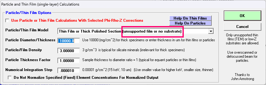

Yes, the thin film calculation in Probe for EPMA (and CalcZAF) is really a modified particle geometry correction and is not designed for samples on a substrate:
Or at least a very low Z substrate, such as a carbon plancette which wouldn't work for your effort!  See here for more info:
https://smf.probesoftware.com/index.php?topic=1241.msg8679#msg8679

Ah, OK. Based on your "measuring carbon coat thickness" topic and the fact that you posted this in the sample prep board you got me off-track.  So when you mentioned the Calculation Options dialog I thought you were going into the Particle and Thin Film calculations dialog from there trying to determine coating thickness!
OK, if you are only trying to correct for different carbon thicknesses between your standards and your unknowns you will need to specify the carbon thickness for the unknowns (from the Calculation Options dialog), and also for the standards in the Standard | Standard Coating menu dialog, and then you will need to turn on the carbon coat correction options in the Analytical |Analysis Option menu dialog.  Both of them!
This coating correction works well, so if you don't know your carbon coat thickness you'll have to adjust it until you get totals you are expecting.  Not an ideal situation as I'm sure you know.
