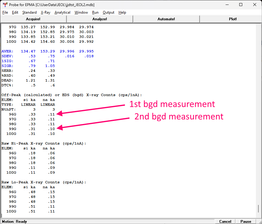

The Nth point bgd method was developed by Mike Jercinovic, Julien Allaz and myself to deal with beam sensitive samples that require high beam currents and long counting times, but are relatively homogeneous. In this example, the Nth point parameters (in the Acquire! | Acquisition Options dialog were set to "3" for each element:
The idea being that the background is only re-measured every N points.

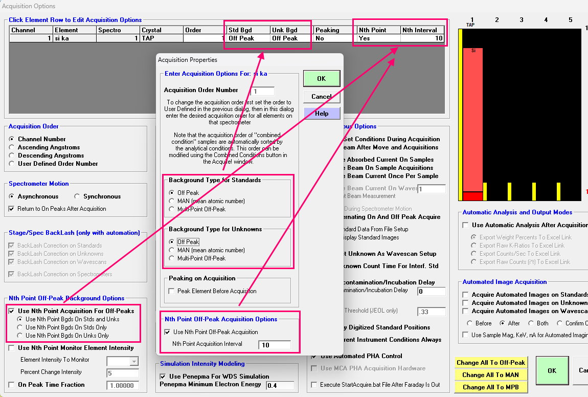

Ben makes a good point about setting Nth point parameters for unknowns vs. standards. You can set the Nth point parameters for standards vs. unknowns as Ben describes above by making samples of each type, but one can also do this from the Acquisition Options dialog.
In fact it's worth pointing out that a similar situation appears for standards vs. unknowns for the background acquisition type as well.  This visual may help:
Note however that if one adds an element to a sample, the default is no Nth point and off-peak, so those need to be changed for the standards and/or unknowns if desired.
