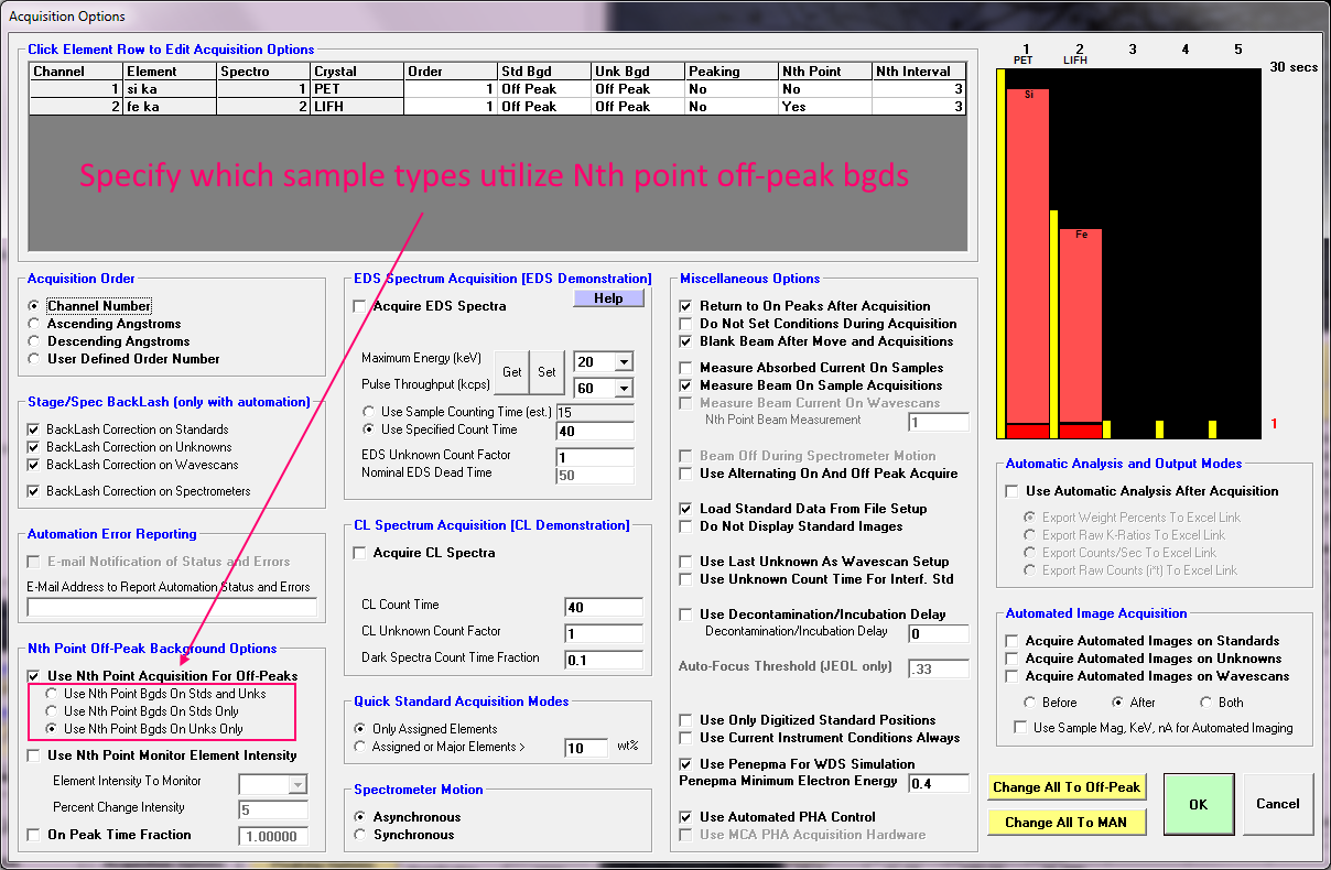

I really like the Nth point feature, we regularly use it for standards and turn it off for unknowns. What I find is many users forget to turn it off for unknowns. Could we have a warning when analysing unknowns - stating that Nth point is turned on - e.g. like the other warnings in the PFE window in the bright colors
Quote from: Ben Buse on November 28, 2018, 05:55:36 AM
I thought about your request about adding a warning message but I think I came up with a more elegant method. I thought of a way to treat the acquisition code as an "object", and simply utilize another parameter to specify whether standard and/or unknown samples are acquired using the Nth point background method as seen here:
For those of you not aware of this off-peak background method, the help file has this to say:
QuoteNth Point Off-Peak Acquisition
Another acquisition option method utilized to save time, is the Nth Point background method which simply acquires an off-peak background measurement every "N" points. That is, one performs an off-peak background measurement on the first point of a set of data and then re-uses that off-peak measurement for subsequent data points, instead of explicitly measuring the off-peak background for all points in the data set.
Typically this would be utilized on major and minor elements, with the trace elements continuing to be measured using normal off-peak background measurements.
The downside to this method is that if the composition changes, the average Z of the material will change and according to Kramer's Law, the continuum intensity will change as well. Although the change will be proportional to the degree to which the average Z changes and therefore will be small for a small difference in composition. However if the change in background intensity is greater than the precision of the measurement, it will affect the accuracy of the analysis.
A new option for the Nth Point off-peak background acquisition to handle samples with variable composition is the "smart" monitor element feature. Based on a user specified monitor element the software will automatically re-measure the off-peak backgrounds if the on-peak intensity of the monitor element changes by more than the user specified percentage.
Note that the monitor element should normally be a major element (with a statistical significance that is appropriate for the specified monitor element intensity change percent specified and also an element that finishes its on-peak count integration BEFORE the Nth Point off-peak ground elements in order to function properly.
Anyway, it seems to work quite well, so give it a try and let me know what you think.  Version 12.5.3 is ready to download now.
