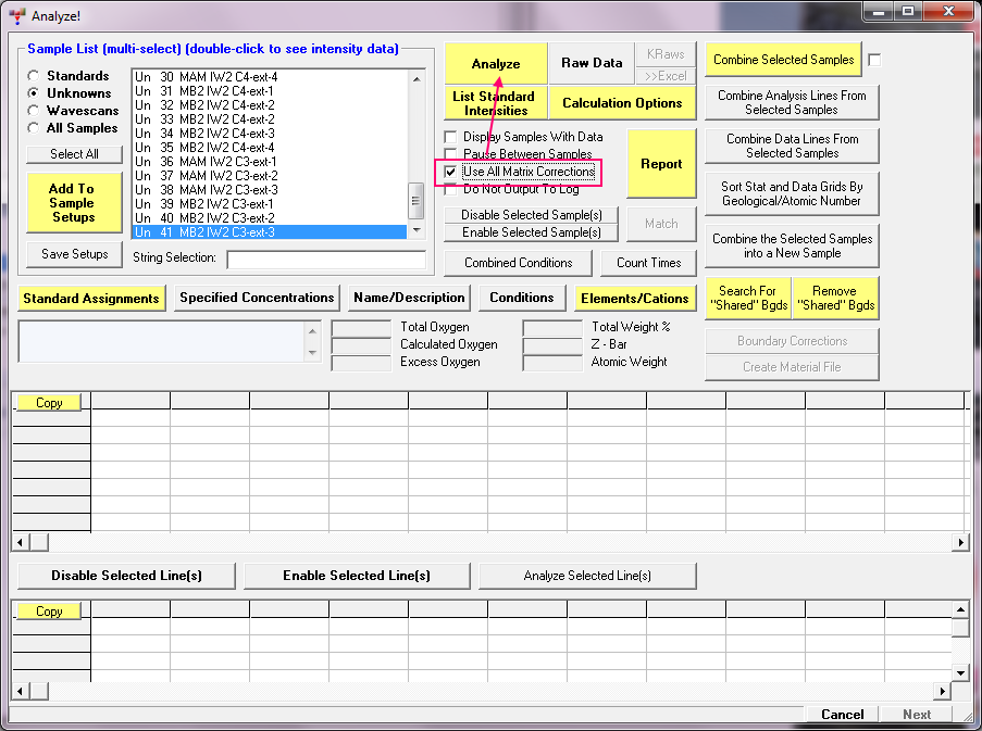

If you utilize Probe for EPMA for quantitative analysis you will have noticed that when one analyzes a standard sample, or an unknown sample that has been declared to be a standard:
https://smf.probesoftware.com/index.php?topic=71.msg10257#msg10257
the program will also display the "published" composition of that standard immediately after the composition is displayed, where the standard was calculated as though it were an unknown sample:

Some of you may also be aware that the "Use All Matrix Corrections" option in Probe for EPMA (and also CalcZAF) can provide useful information for a given composition for evaluating matrix correction accuracy:
Previously, this feature provided the following output, in this case a analyzing SRM K-412 (#160) as a secondary standard using SRM K-411 (#162) as a primary standard for the major elements:

As we can see, all 11 matrix corrections give very similar results, but the question is which matrix correction gives the most accurate result?
It would be helpful if we could obtain a % relative accuracy variance compared to the published composition. Now, in the latest Probe for EPMA v. 14.2.8, we also obtain this output as seen here:

Values enclosed with parentheses indicates that the standard (or unknown) sample is the primary standard, so these values can be ignored.
From this output we can quickly see which matrix corrections yield the most accurate results. The sharp eyed among you will also notice that the last matrix correction (DAM BSE correction) gives a more accurate MAN correction for complicated reasons explained here:

     4   -2.08  (-.09)     ---     .00           Love-Scott I
     5   -1.34  (-.06)     ---     .00           Love-Scott II
     6  -15.80  (-.87)     ---     .00           Packwood Phi(prZ) (EPQ-91)
     7    5.71   (.21)     ---     .00           Bastin (original) (prZ)
     8   -1.55  (-.07)     ---     .00           Bastin PROZA Phi (prZ) (EPQ-91)
     9   -2.80  (-.13)     ---     .00           Pouchou and Pichoir-Full (PAP)
    10   -4.17  (-.20)     ---     .00           Pouchou and Pichoir-Simplified (XPP)
    11     .89   (.05)     ---     .00           Armstrong/Donovan and Moy BSC/BKS (prZ)
AVER:    -2.14    -.13     .00     .00
SDEV:     6.29     .33     .00     .00
SERR:     1.90     .10     .00     .00
MIN:    -15.80    -.87     .00     .00
MAX:      5.78     .24     .00     .00
Update as usual from the Help menu or our Resources web page and see for yourself...
