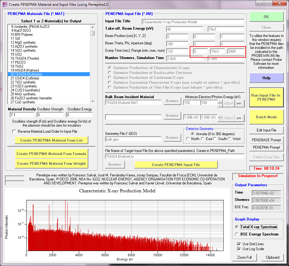

In v. 11.7.2 of CalcZAF (and Standard) I added three new parameter fields to the Penepma GUI. These are for the minimum and maximum energy range and the number of energy channels.  This required a re-compile of the Penepma.f to allow for more than 1000 energy channels.
The reason for doing this is also to allow me to synthesize WDS spectra for "demo" as described here:
http://smf.probesoftware.com/index.php?topic=837.0
where we will require some 10,000 to 20,000 energy channels for simulating WDS spectral resolution...
PS if you specify more than 1000 energy channels in the Penpma GUI, the software will remind you that you will need to utilize the CalcZAF Help | Update CalcZAF menu as seen here:
to update your Penepma distribution.
