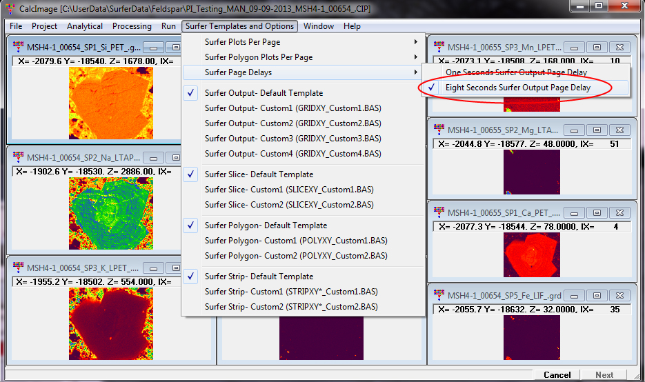

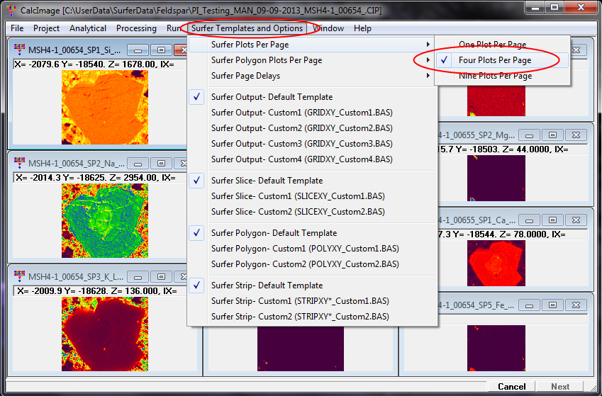

Hi Malcolm,
So awesome to meet you finally in Hobart.
I've implemented your ideas in the latest CalcImage release.  The "plots per page" script keyword (for both normal output and also polygon output) is ready to download in v. 10.7.1. Below are some screen shots:
