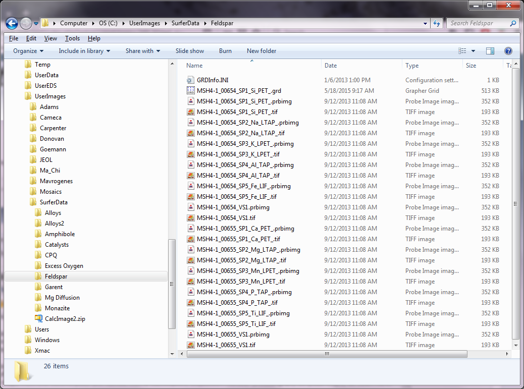

So normally when one wants to perform the align and crop method on multiple passes on more than a single set of x-ray maps, it's because one acquired more elements than they have WDS spectrometers, as originally described in this example from a few years ago:
https://smf.probesoftware.com/index.php?topic=1152.0
So if one needed to acquire their x-ray maps in more than a single pass, e.g., Si, Fe, Ca, Al, Mg, Na in the first x-ray map acquisition, and then say, K, Mn, Ti, Ba and Ni in the second x-ray map acquisition. And if the area of interest was very small and/or the stage was drifting, the first map acquisition might not be aligned perfectly with the second map acquisition.
Of course this example assumes that one is utilizing MAN background corrections for the background correction, so no off-peak maps need to be acquired! However whether or not off-peak background maps were acquired, the maps from the first pass are named with one acquisition number (including any off-peak maps), while the maps from the second pass are named with a subsequent acquisition number (including any off-peak maps) as seen here:
Where acquisition 00654 was the first pass elements and 00655 was the second pass elements (all MAN backgrounds).
Now in this "normal" align and crop case, one acquires the multiple pass x-ray map acquisitions, then one imports the PrbImg files into CalcImage using the Create New Project wizard menu, and then one has a set of GRD files with the same "base names" as with the original PrbImg files, which one can then (if necessary), apply the align and crop method to these (now GRD formatted) files, prior to the map quantification.
As a quick aside, any off-peak maps acquired will have the same acquisition number as the on-peak maps, and so would be included in the align and crop of the respective on-peak map acquisitions, so there is no way to apply an align and crop between the on and off-peak map acquisitions. Just one more reason to utilize MAN background corrections for your x-ray map quantification I guess!    :)

Now as you have described, currently these separate replicate (on-peak) PrbImg files are first converted to _TDI replicate files to all have the same acquisition number, using the Convert | Convert Replicate PrbImg Files to TDI files menu in CalcImage. Now these replicate PrbImg files have the same acquisition number, but are numbered _TDI_1, _TDI_2, _TDI_3, etc. as seen here:
Then one can import these renamed PrbImg files into a new CalcImage project for subsequent map quantification, just as one would any other map acquisition and the _TDI files are automatically handled for TDI scanning corrections.

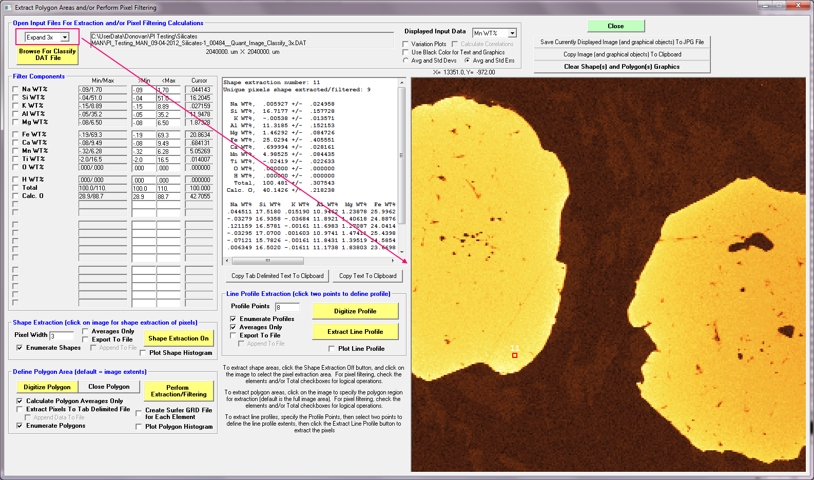

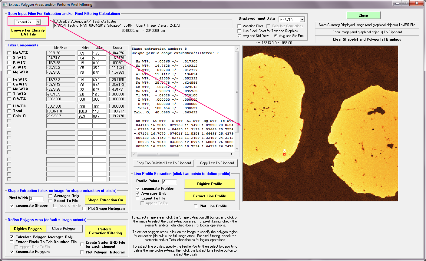

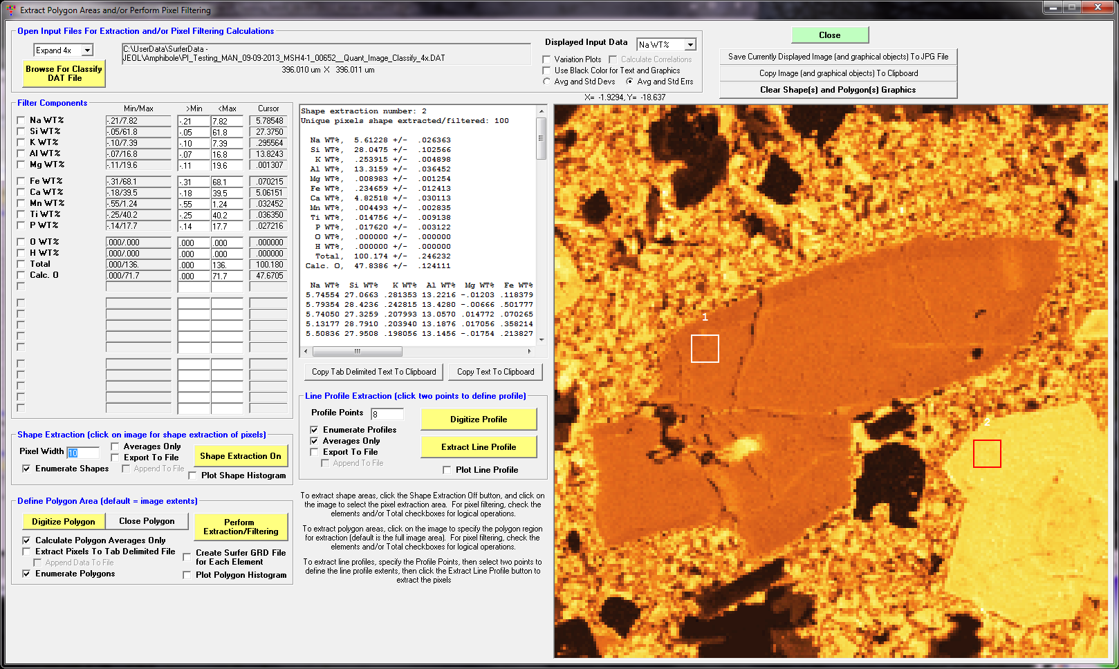

Your wish is granted (I think)!
We didn't want to mess with the scaling issues of graphics "zooming" so we modified the Classify data file loading to allow the user to specify a "pixel expansion" parameter. The default is 1x which means there is no pixel expansion as seen here:
By selecting other items from this new dropdown list one can select for example a 2x expansion:
Or a 3x expansion:
Or, looking at a different dataset, even a 4x expansion:
We attempted to keep the pixel selection statistics consistent for all of these "expanded" datasets, but please let us know if you see anything amiss.
