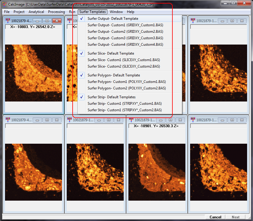

I've got something for you to try that I think will make running with your user customized scripts much easier.
Simply rename your scripts to these "custom" file names as seen in the next post (gridxy_Custom1.bas for example), and copy them to the PFE application folder:
Alternatively simply edit the existing scripts already provided with the next Probe for EPMA .msi file and you are ready to go.
These custom scripts will be installed the first time if they are not already present, but then will never be overwritten by the installer during subsequent updates and upgrades.
Once your modified scripts are renamed or edited you simply select them from the Surfer Templates menu as desired...
Here's some more details on utilizing the "custom script" feature in CalcImage.
Beginning in v 10.4.4 of the ProbeForEPMA.msi file (not the quick .ZIP update), the installer will update the following "partial" Surfer script files which are used as the "template" for presentation output of quant, slice, polygon and strip data extraction operations.
Why "partial"? Because these scripts do not contain specimen specific information, only the plot layout. This specimen specific information is appended to these "partial" scripts to create a fully functional script to run in the Surfer Scripter application (or automatically from CalcImage):
GRIDXY.BAS                  Default quant presentation output script (will be overwritten on updates, so do not edit normally)
gridxy_Custom1.bas       User customizable script for quantitative and raw data presentation output (will not be overwritten)
gridxy_Custom2.bas       User customizable script for quantitative and raw data presentation output (will not be overwritten)
gridxy_Custom3.bas       User customizable script for quantitative and raw data presentation output (will not be overwritten)
gridxy_Custom4.bas       User customizable script for quantitative and raw data presentation output (will not be overwritten)
SLICEXY.BAS                  Default slice presentation output script (will be overwritten on updates, so do not edit normally)
slicexy_Custom1.bas       User customizable script for slice and profile data presentation output (will not be overwritten)
slicexy_Custom2.bas       User customizable script for slice and profile data presentation output (will not be overwritten)
POLYXY.BAS                  Default polygon presentation output script (will be overwritten on updates, so do not edit normally)
polyxy_Custom1.bas       User customizable script for polygon extraction data presentation output (will not be overwritten)
polyxy_Custom2.bas       User customizable script for polygon extraction data presentation output (will not be overwritten)
STRIPXY1.BAS                  Default equant strip presentation output script (will be overwritten on updates, so do not edit)
STRIPXY2.BAS                  Default tall strip presentation output script (will be overwritten on updates, so do not edit)
STRIPXY3.BAS                  Default wide strip presentation output script (will be overwritten on updates, so do not edit)
stripxy1_Custom1.bas       User customizable script for equant plot strip data presentation output (will not be overwritten)
stripxy1_Custom2.bas       User customizable script for equant plot strip data presentation output (will not be overwritten)
stripxy2_Custom1.bas       User customizable script for tall plot strip data presentation output (will not be overwritten)
stripxy2_Custom2.bas       User customizable script for tall plot strip data presentation output (will not be overwritten)
stripxy3_Custom1.bas       User customizable script for wide plot strip data presentation output (will not be overwritten)
stripxy3_Custom2.bas       User customizable script for wide plot strip data presentation output (will not be overwritten)
Therefore, if you want to customize or overwrite these _Custom1, _Custom2, etc scripts with your own optimized scripts, they will not be overwritten and one can simply select them from the Surfer Templates menu and seen in the previous post.

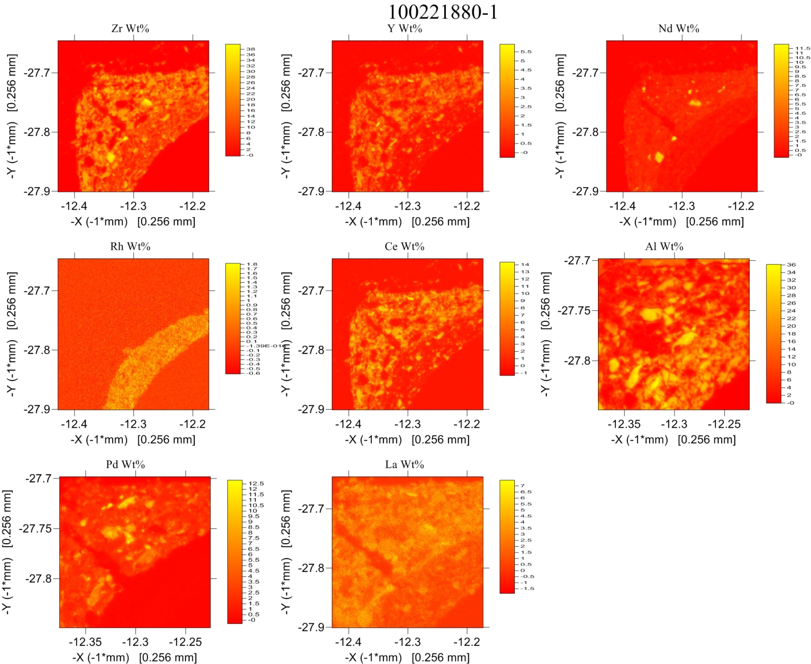

Ok, let's take a simple example and see if that makes it clearer.
Suppose you like the default presentation output script but you would like to have a different color scale as opposed to the default Rainbow2.clr color file...
There's no point in editing the GRIDXY.BAS "partial" template file since it will just get overwritten once the software is next updated. Instead we simply edit the gridxy_Custom1.bas "partial" template, and change the lines:
' Load color spectrum depending on version number
If Val(Left$(SurferApp.Version, 2)) <= Val("8.") Then
   SurferColorMap.LoadFile(SurferApp.Path & "\Samples\Rainbow2.clr")
Else
    SurferColorMap.LoadFile(SurferApp.Path & "\ColorScales\Rainbow2.clr")
End If
from rainbow2.clr to redhot.clr, save the gridxy_Custom1.bas file to the PFE app folder and the next time our data is output, we simply select the Surfer Templates | Gridxy_Custom1.bas menu in CalcImage, and the application will automatically utilize the new "redhot" color scale!
   SurferColorMap.LoadFile(SurferApp.Path & "\Samples\Redhot.clr")
Else
    SurferColorMap.LoadFile(SurferApp.Path & "\ColorScales\Redhot.clr")
End If

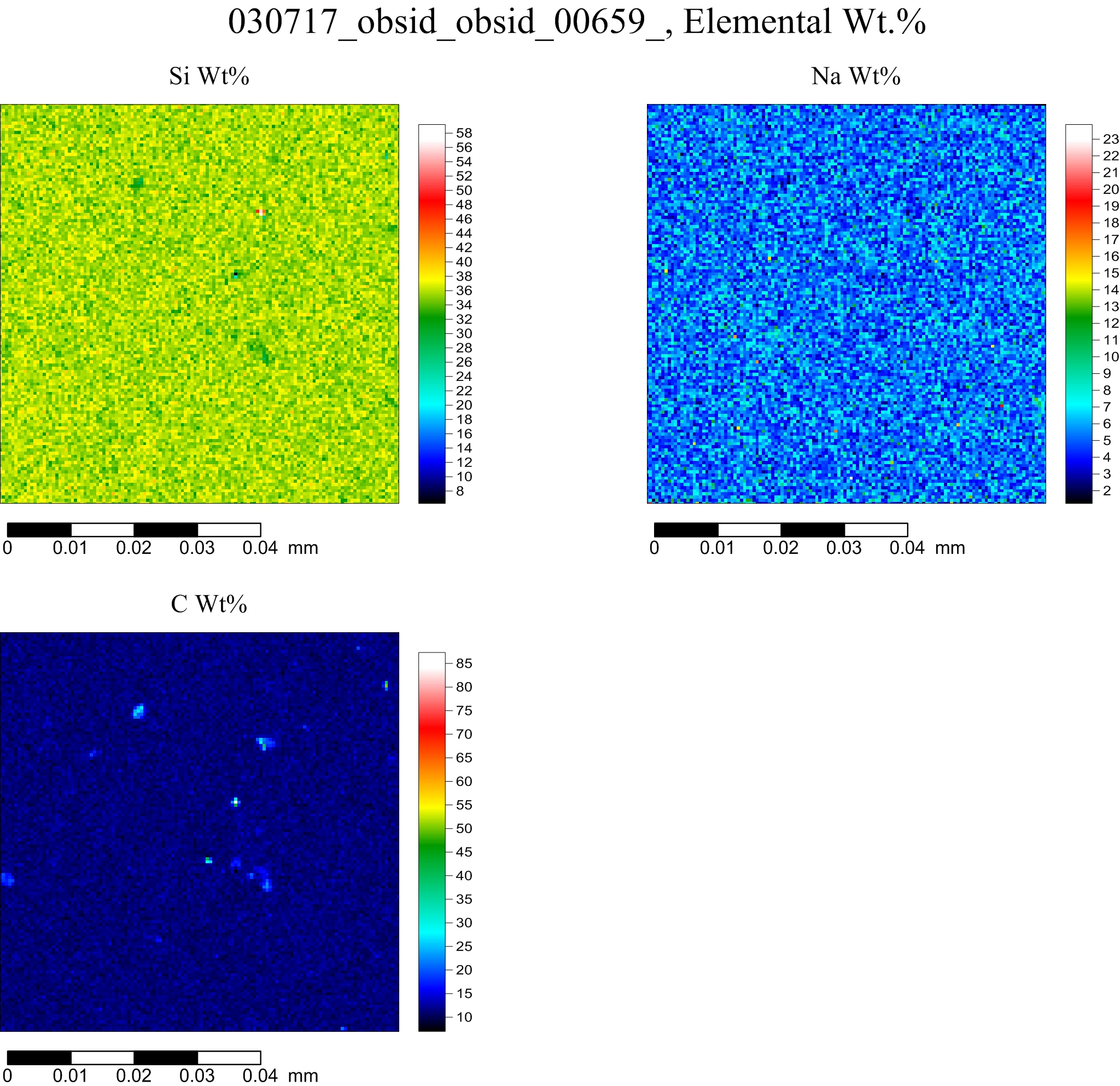

Has anyone made a custom script to plot a scale bar instead of axes for the maps, and express scale in microns not millimetres?
Right so I can add a scale bar and hide axes by adding the following in SubGridText
'Declares ScaleBars as an object
Dim ScaleBars As Object
'Assigns the ScaleBars collection to the variable named "ScaleBars"
Set ScaleBars = SurferMapFrame.ScaleBars
'Declares ScaleBar as an object
Dim ScaleBar As Object
'Creates a scale bar and assigns it to the variable named "ScaleBar"
Set ScaleBar = ScaleBars.Add
'Hide axis
Dim BottomAxis As Object
Set BottomAxis = SurferAxes("Bottom axis")
BottomAxis.Visible=False
Dim TopAxis As Object
Set TopAxis = SurferAxes("Top axis")
TopAxis.Visible=False
Dim LeftAxis As Object
Set LeftAxis = SurferAxes("Left axis")
LeftAxis.Visible=False
Dim RightAxis As Object
Set RightAxis = SurferAxes("Right axis")
RightAxis.Visible=False
Improved turn of ticks and labels, not hide axes - otherwise no map frame
'Turn labels and ticks off
Dim Axes, Axis As Object
Set Axes = SurferMapFrame.Axes
    For Each Axis In Axes
        Axis.ShowLabels = False
        Axis.MajorTickType = srfTickNone
        Axis.MinorTickType = srfTickNone
    Next Axis
Adapted from
https://support.goldensoftware.com/hc/en-us/articles/226473167-How-can-I-change-the-axes-settings-in-Surfer-via-automation-
Move scale bar
'Move scale bar
ScaleBar.Left = SurferMapFrame.Left + 0.5
'+ SurferMapFrame.Width + SurferMapFrame.Width * 0.05
ScaleBar.Top =SurferMapFrame.Top - SurferMapFrame.Height + 0.1
'* 0.05
'Add units to scale bar
If PlotsPerPage% = 4 Then
title_xpos! = ScaleBar.Left + ScaleBar.Width + 0.05
title_ypos! = SurferMapFrame.Top - SurferMapFrame.Height - 0.01
Set SurferText = SurferShapes.AddText(title_xpos!, title_ypos!, "mm")
SurferText.Font.Face = FileFont$
SurferText.Font.Size = 10
End If

Does anyone know the command for colorscale line width - I can't find it.
It works well, except for large millimetre maps were the digits overlap - can rotate numbers if necessary but in this case would use mm scale
' ScaleBar.LabelRotation = 45
Files attached
Custom 1 = micron scale
Custom 2 = micron scale with 45 degree rotation on scale bar
Custom 3 = mm scale
